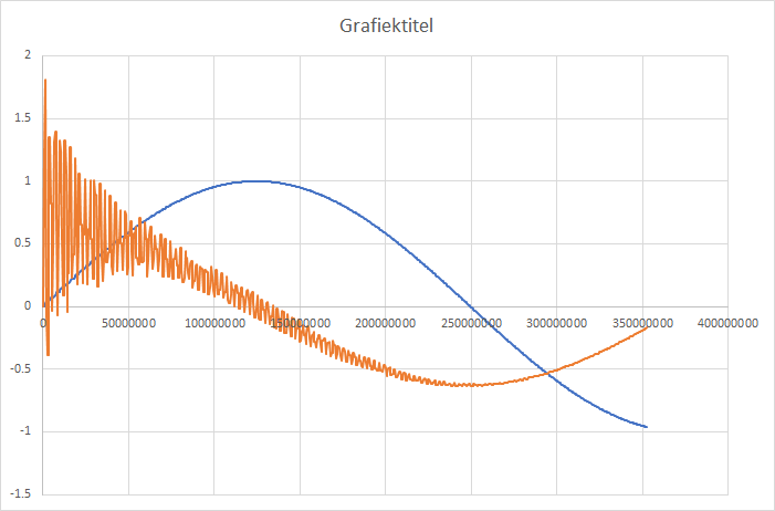

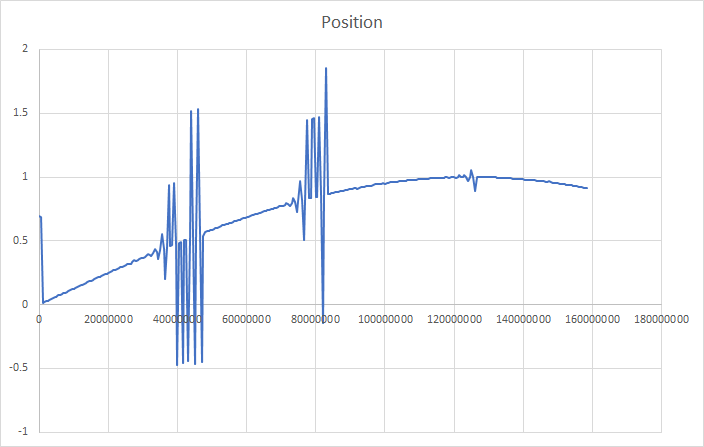

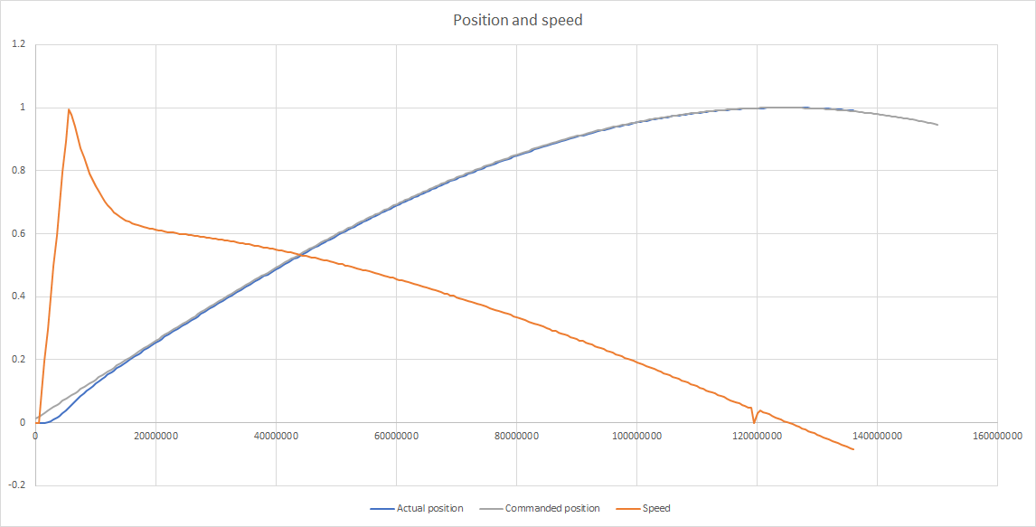

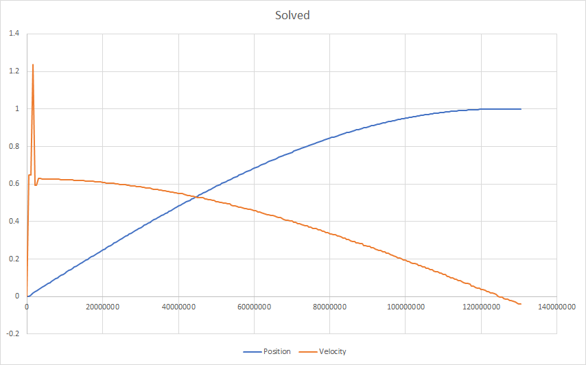

Today some fun with the problem with the stepgen. After flattening some bugs in the code, I was getting some stability problems with the position, which happened periodically. The problem arises from the stepgen module handing off all acceleration calculations to the FPGA, similar as the implementation of the software stepgen of LinuxCNC. When going to 50 MHz the acceleration per timestep gets infinitely small, as the time component is being squared. Result is that while the driver thinks acceleration is handled by the FPGA, the FPGA sees a max acceleration of 0 and hence applies the commanded speed directly. Why does the spikes occur periodically: basically it is a combination of chance (the thread period is not really a constant) and an ever increasing error. Note: this figure is already after optimisation of the algorithm.
OK: what happens if we throw in some values which make sure that the max acceleration which is send to the FPGA is not equal to 0. So, we use a relatively high acceleration. Now we see we get a relatively smooth curve. We are not there yet, as the orange line depicts the speed of the stepper engine fluttering around. The most probably cause is now in the speed prediction.
When flattening out the last bugs in the speed prediction it now looks reasonable. The reason for the spike at the start is that the position-cmd is directly coupled to the signal generator. So when starting, the commanded position does not adhere to any acceleration limits. The stepgen therefore has to catch up
The code is not yet on GitHub, because:
- needs some good cleaning up (too tired for today);
- it only works with large values of accelerations (20,000 steps/second²), this needs also to be addressed.
Last edit: 30 May 2022 21:22 by TOLP2. Reason: Found solution

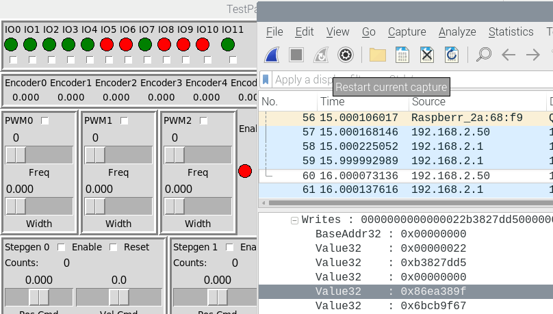

03 Jun 2022 19:15 - 03 Jun 2022 19:18 #244532
by muvideo
Replied by muvideo on topic ColorCNC Colorlight 5A-75E/5A-75B as FPGA controller board

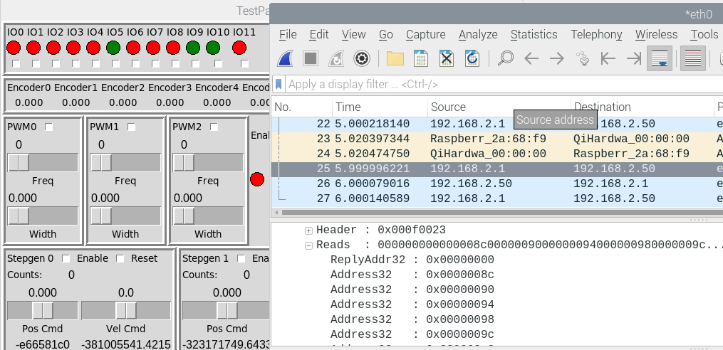

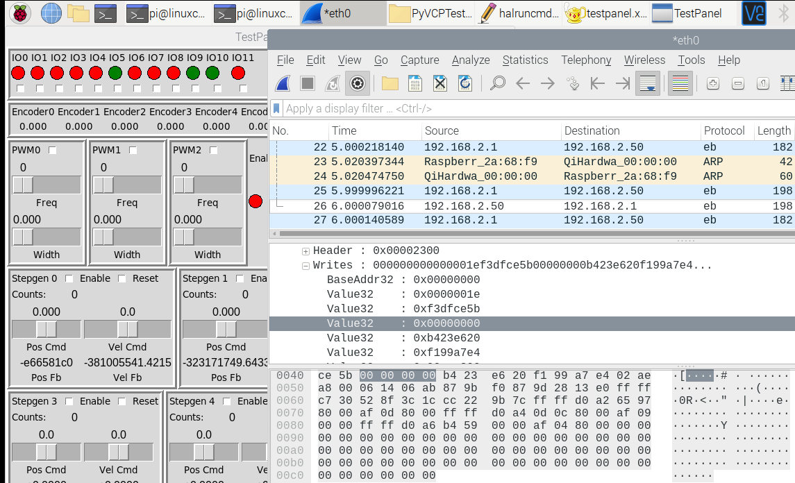

In my system (raspi pi4) with the latest driver, read is shifted by one register.
I'm attaching two examples here, as can be seen comparing input values
on top and register values on bottom, the gpio in is reporting the value of
the register at address 0x00000098 (MMIO_inst_stepgen_0_position)
instead of 0x00000094 (MMIO_inst_gpio_in).
Problem is 0x00000094 is still stuck at 0.
Read addresses:
Read values, input color, green is 1 red is 0 (top left)
here the value is 620, last 3 digits of address 98
the value is 89f, last 3 digits of address 98
Read addresses:
Last edit: 03 Jun 2022 19:18 by muvideo.

04 Jun 2022 08:10 #244563
by TOLP2
Replied by TOLP2 on topic ColorCNC Colorlight 5A-75E/5A-75B as FPGA controller board
That is strange. It looks like the write buffer is one too short, causing the read to start at the wrong address.
Can you share the following files, so I can reproduce:
- your config file;
- the csr.csv file describing all addresses;
- when adding the Fpga to the hall, the first few lines of the stdout. This describes the modules and memory buffers.
At this moment I only have a 5A-75E to experiment with. This error did not occur with my setup, although I don't think it is board related. Has to be solved.
- your config file;

svb@LiteX-dev:~/CNC/LitexCNC-e2/examples$ halrun
halcmd: loadrt litexcnc
Note: Using POSIX realtime
litexcnc: Loading Litex CNC driver version 1.0.0
halcmd: loadrt litexcnc_eth config_file="./75b_cut2.json"
litexcnc: loading litexCNC etherbone driver version 0.02
litexcnc: Connecting to board at address: 192.168.2.151:1234
rtapi_app: caught signal 11 - dumping core
<stdin>:2: waitpid failed /usr/bin/rtapi_app litexcnc_eth
<stdin>:2: /usr/bin/rtapi_app exited without becoming ready
<stdin>:2: insmod for litexcnc_eth failed, returned -1
halcmd: show
Loaded HAL Components:
ID Type Name PID State
7 RT litexcnc_eth initializing
6 User halcmd188820 188820 ready
4 RT litexcnc ready
I'm run this from VirtualBox environment.
All other drivers including MESA running OK.
With this driver i'm have core dumping.
Now i build image for OrangePi4 and try to run from it.
Also if i run modified halcompile, for unknown reason drivers making without linking libjson-c. Halcompile from your repo.
For building i copy Makefiles to folder with driver source and modify it by hand, after that driver linked with library.
My distribution is a Ubuntu 22.04LTS and kernel 5.18.0-rt11
LinuxCNC v2.9.0pre
litexcnc_eth (and litexcnc_debug also) starting, send and receive 1 packet from board, and panic.
For a now i try on 5a-75b v8.0 board.
