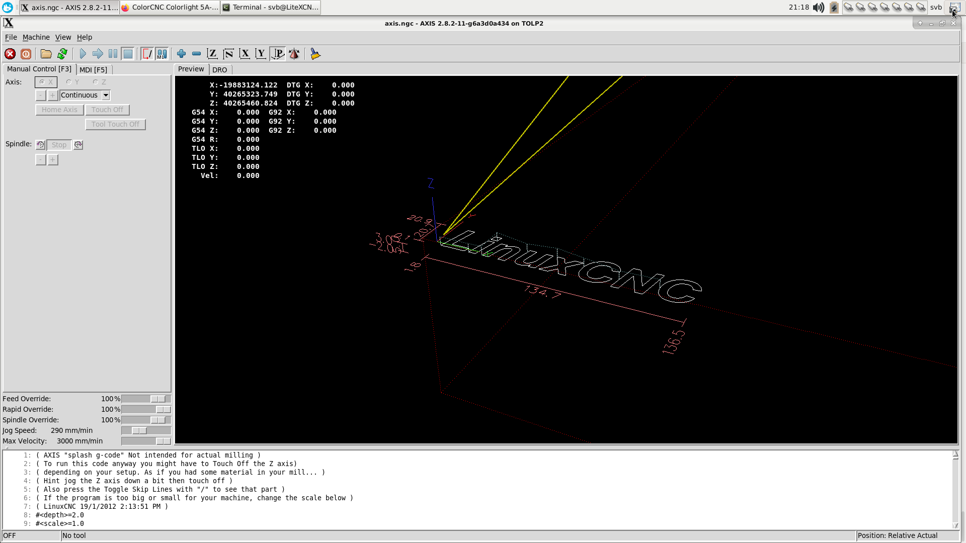

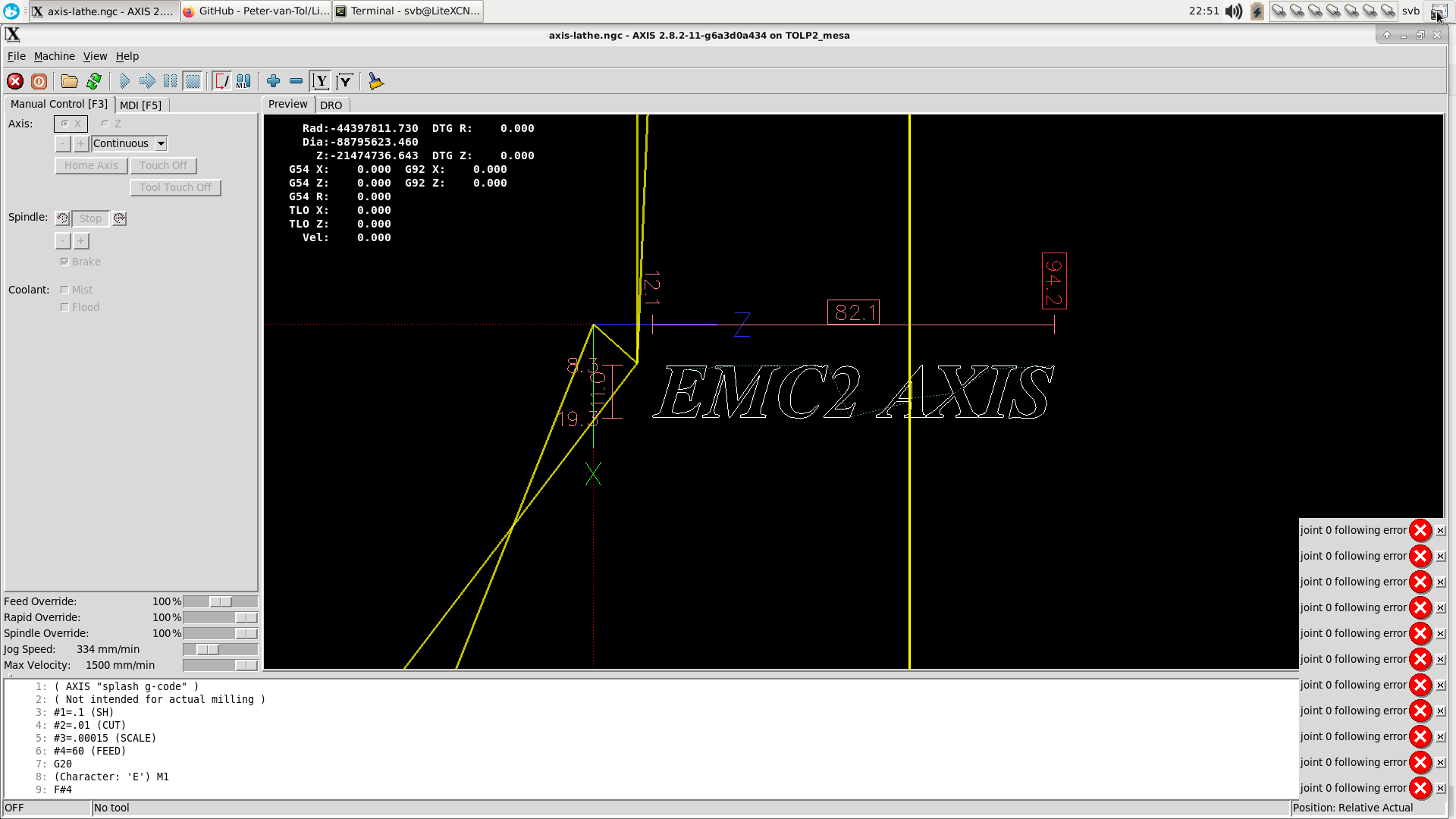

Hi all. I'm sorry, but I'm very dumb and I don't understand what's going on. One, two or all three axes change their readings as they want. And if, at the start, the indications of the axes and suddenly turn out to be static, the error "joint (012) following error" pops up at the first movement This happens on the board 5a-75b, and on 5a-75e it is strictly identical.

Thanks for trying this out and the data. I will look into this (not able to check the data right now)
With static you mean: they don't change anymore? Also, did you include your ini file and Hal file? There might be some acceleration related issue here

TOLP2_litex is a litex build dir
TOLP2_litex_json_build is a BIG json from litex build dir.
TOLP2_lcnc is a LinuxCNC config archive.
I try to make video today or tomorrow.
In general, the values change stochastically for all axes. Sometimes, after starting, the values do not change, and the homing supposedly proceeds normally. but when I try to perform some kind of movement (for example, in MDI G1X100F150) I get the error "joint ...."

Video with errors. Firmware the same for both configs

Sure looks like the stepgen feedback is disconnected in the hal file.

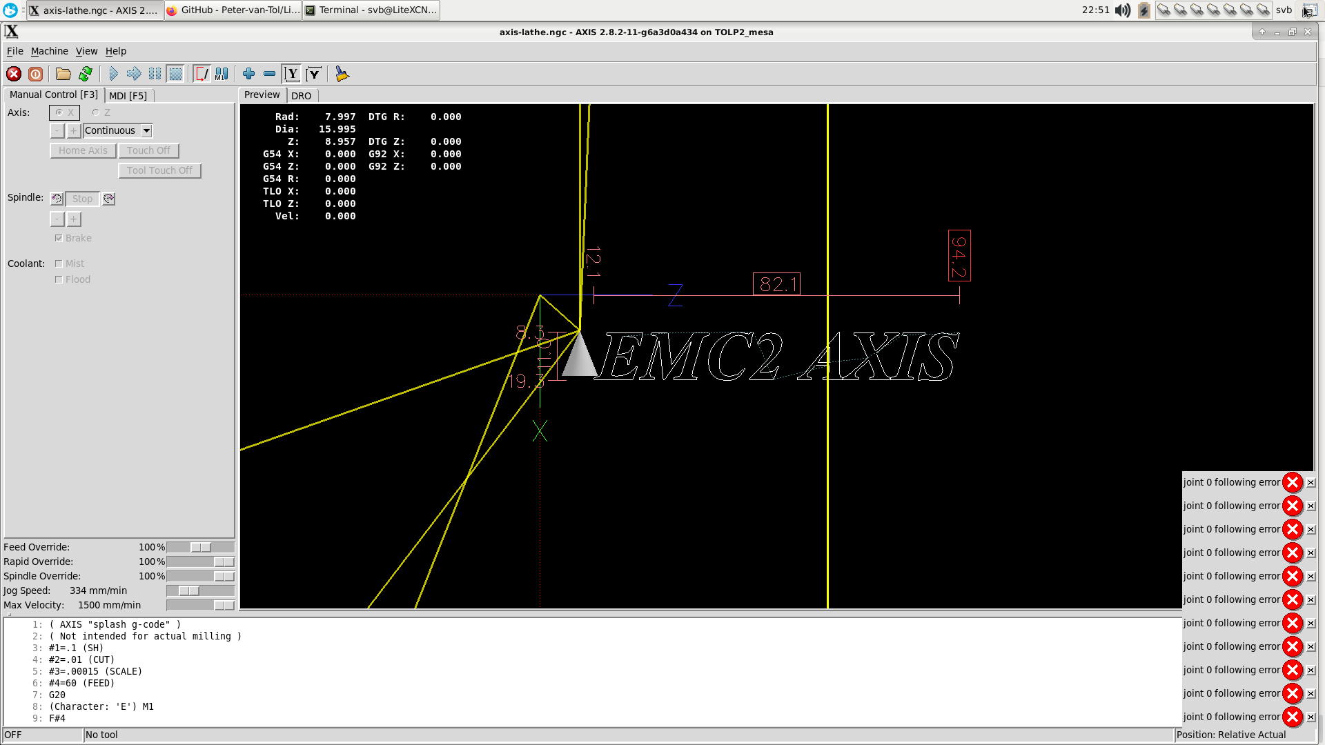

Hi.
Changed configs and attach the logs.
TOLP2 based on a StepConf and has 3 axis config
TOLP2_mesa based on a PNConf and has 2 axis config
Video link for this test

Dear Peter.
Can you share your .bit file and corresponding .json file?
I will try your file for checking my board. May be my board not work correctly.
