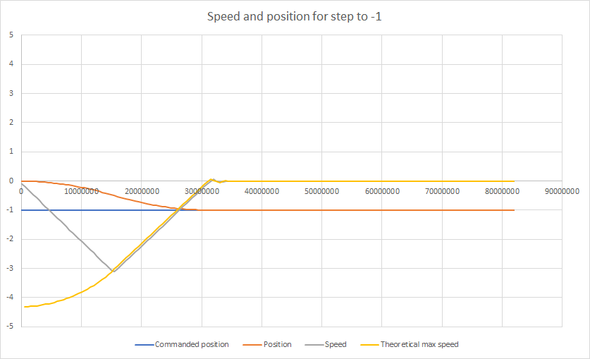

@muvideo: It is indeed the case that the write buffer in your case is too big, causing a shift in the data read from the device. The suspect is the encoder you added in the config file. The encoders are not finished yet and not tested either. Can you try to remove the encoders from the config-file and recompile both the firmware and the driver.
Edit: I have updated the algorithm of the stepgen's to get more smooth behavior when the acceleration limit is not obeyed by the motion planner (or you're using not a motion planner, but siggen instead). I tested it with a square wave from siggen and it looks very smooth. Basically, as soon the stepgen cannot follow the commanded position, it will set the `catching_up` flag. The speed is increased using the maximum acceleration (97.5% of maximum value, a small overhead is kept for catching up with small deviations from the perfect path). The speed is increased until the maximum speed, which is based on the error and the time it takes to take to decelerate to the normal speed (to prevent overshoot). The resulting graph is now as shown below.
Edit 2: Fixed the last overshoot
Last edit: 06 Jun 2022 20:07 by TOLP2. Reason: Added stepgen progress

07 Jun 2022 19:45 - 08 Jun 2022 19:25 #244735
by TOLP2
Replied by TOLP2 on topic ColorCNC Colorlight 5A-75E/5A-75B as FPGA controller board
I tested the firmware with the following configuration
With this configuration I can run tests on all three stepgens and the data is received correctly. I used the following hal-commands to test it:
As you can see, I run at fairly low frequency, because for ach period I print out the complete debug of the stepgen, which includes commanded position, received position, estimated position, etc. Those numbers look correct.
Is there a possibility that either the driver or the firmware is not the latest version? The latest commit hash-tag is 1d6e37e

setp test_PWM_GPIO.stepgen.02.debug TRUEAs you can see, I run at fairly low frequency, because for ach period I print out the complete debug of the stepgen, which includes commanded position, received position, estimated position, etc. Those numbers look correct.
Last edit: 08 Jun 2022 19:25 by TOLP2.
