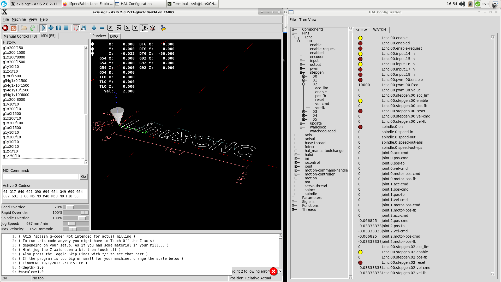

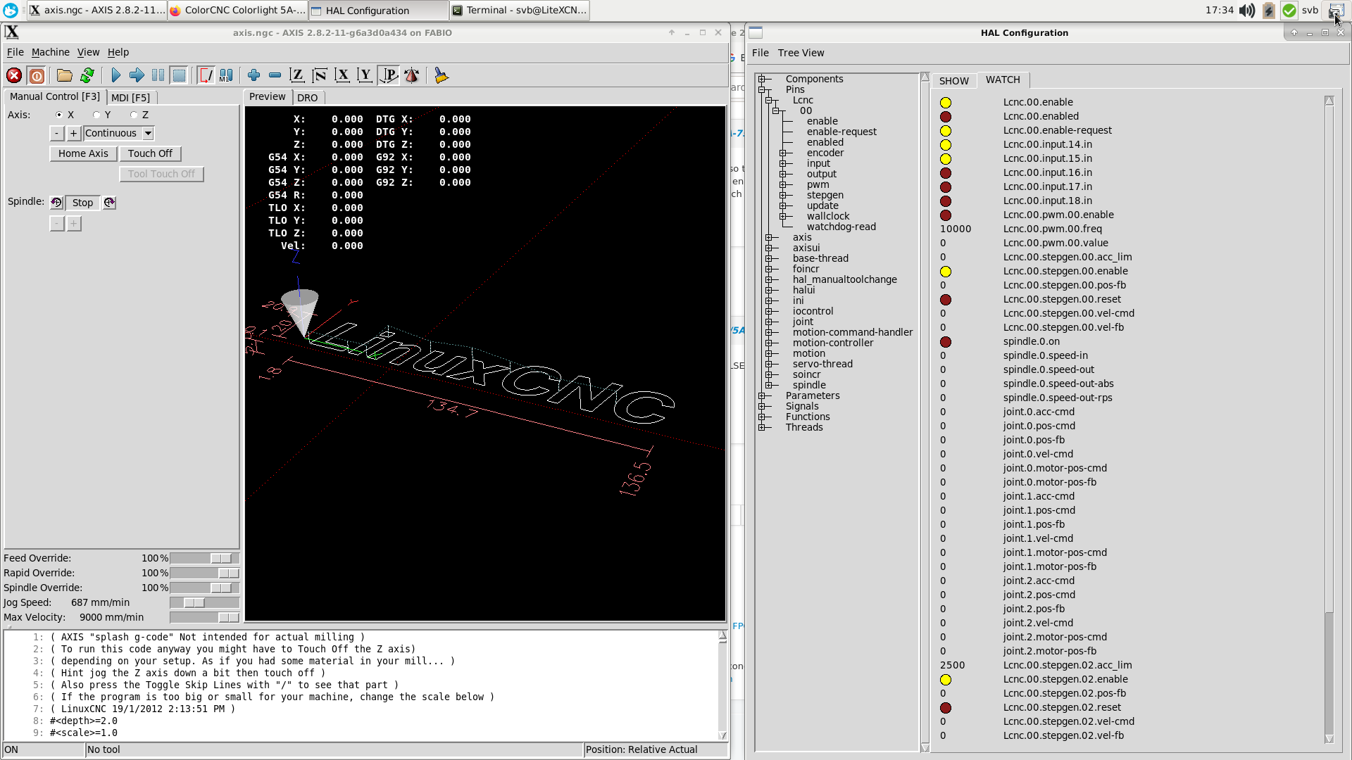

- svb
- Posts: 44
- Thank you received: 10

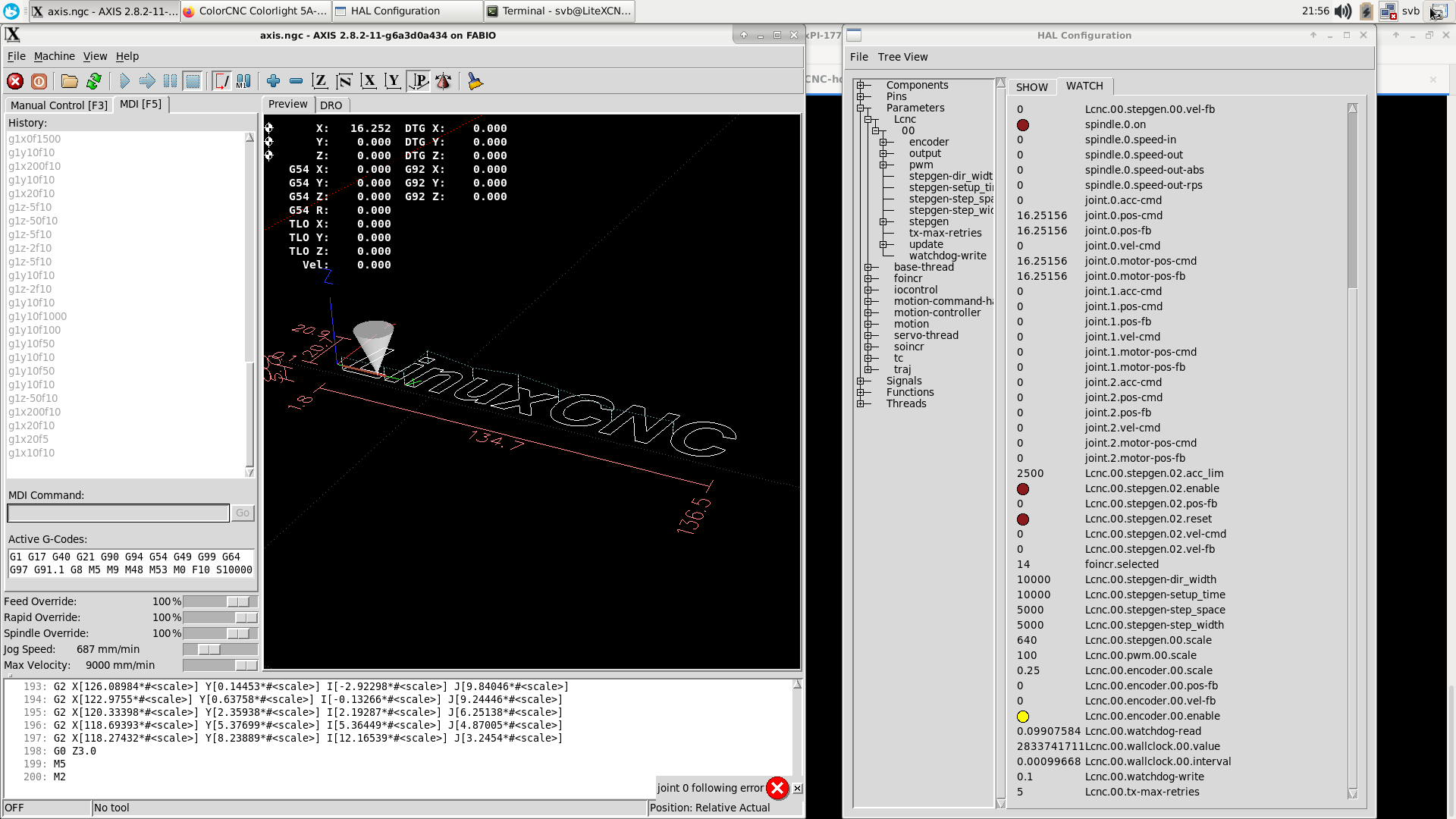

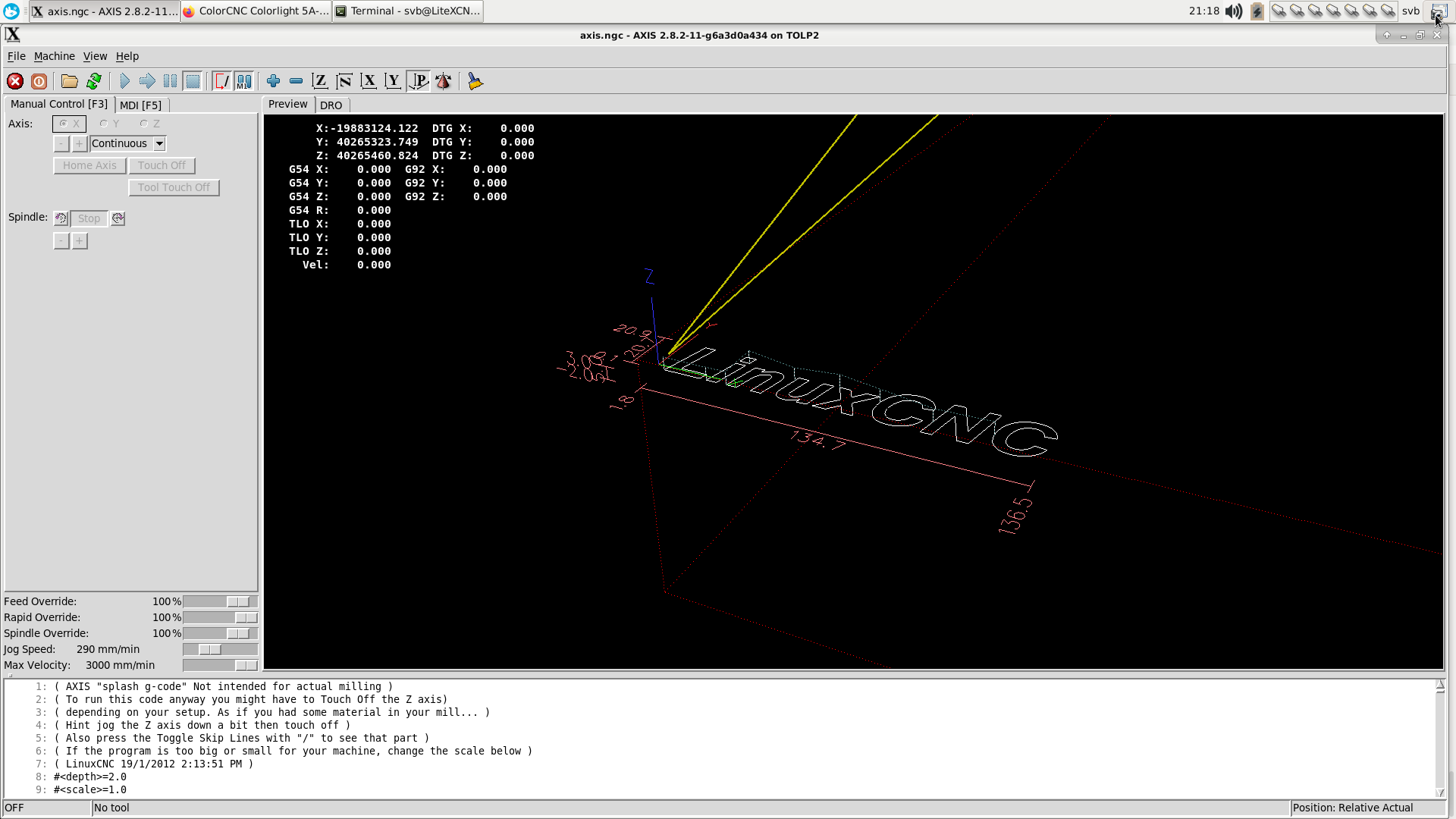

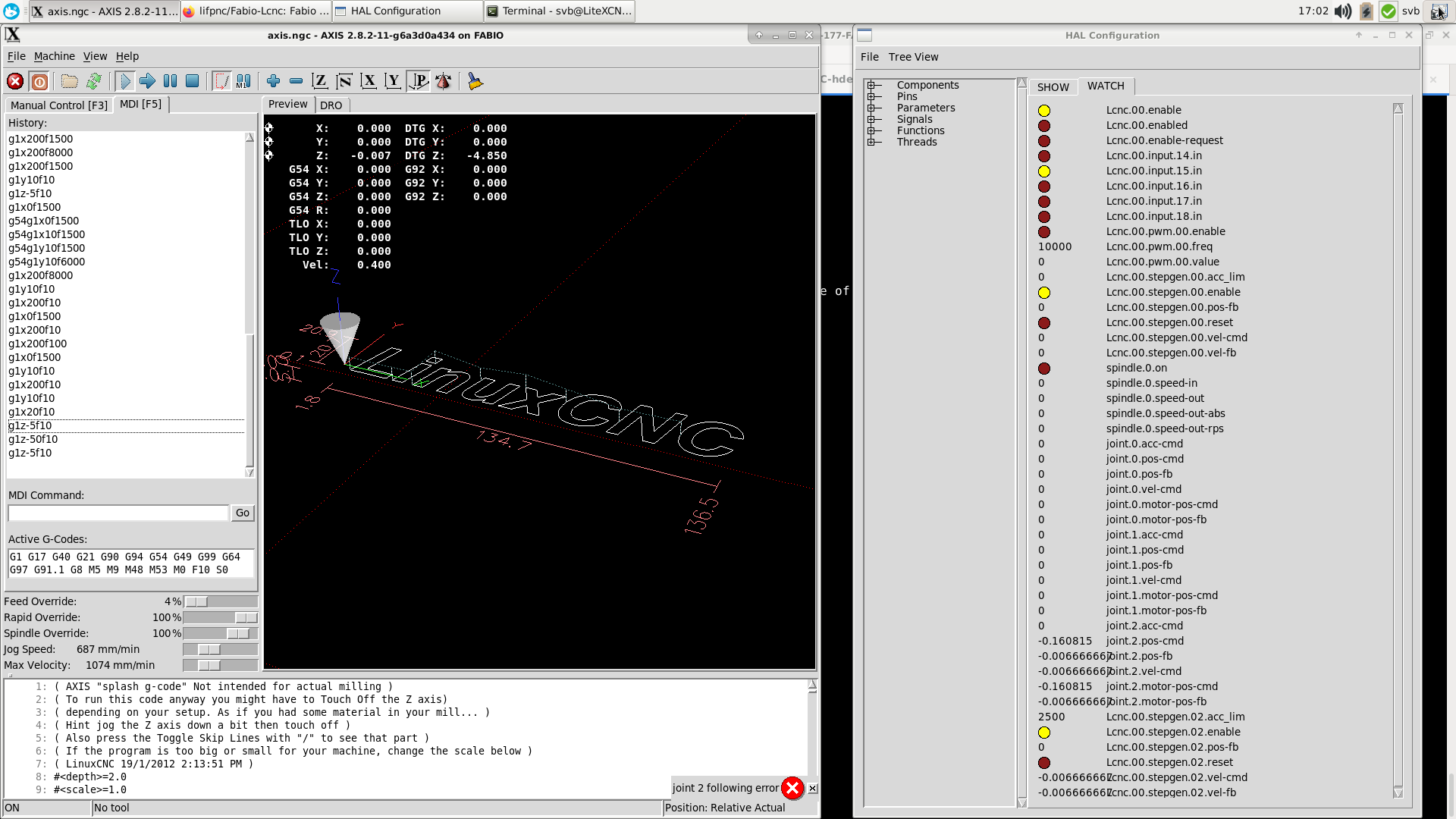

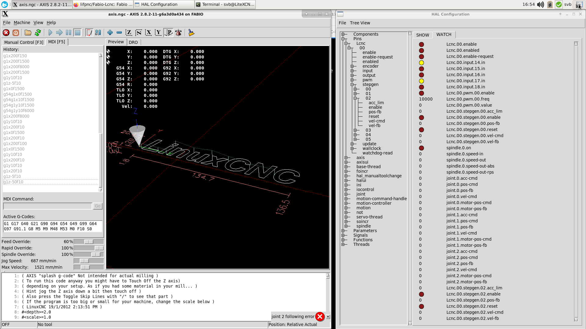

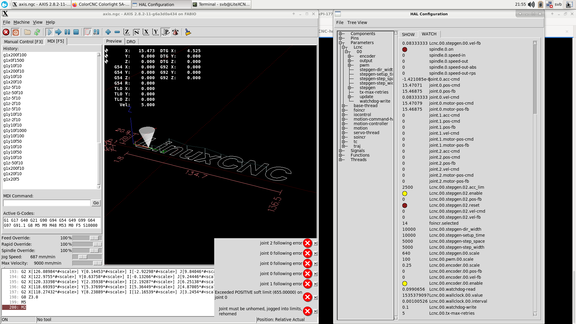

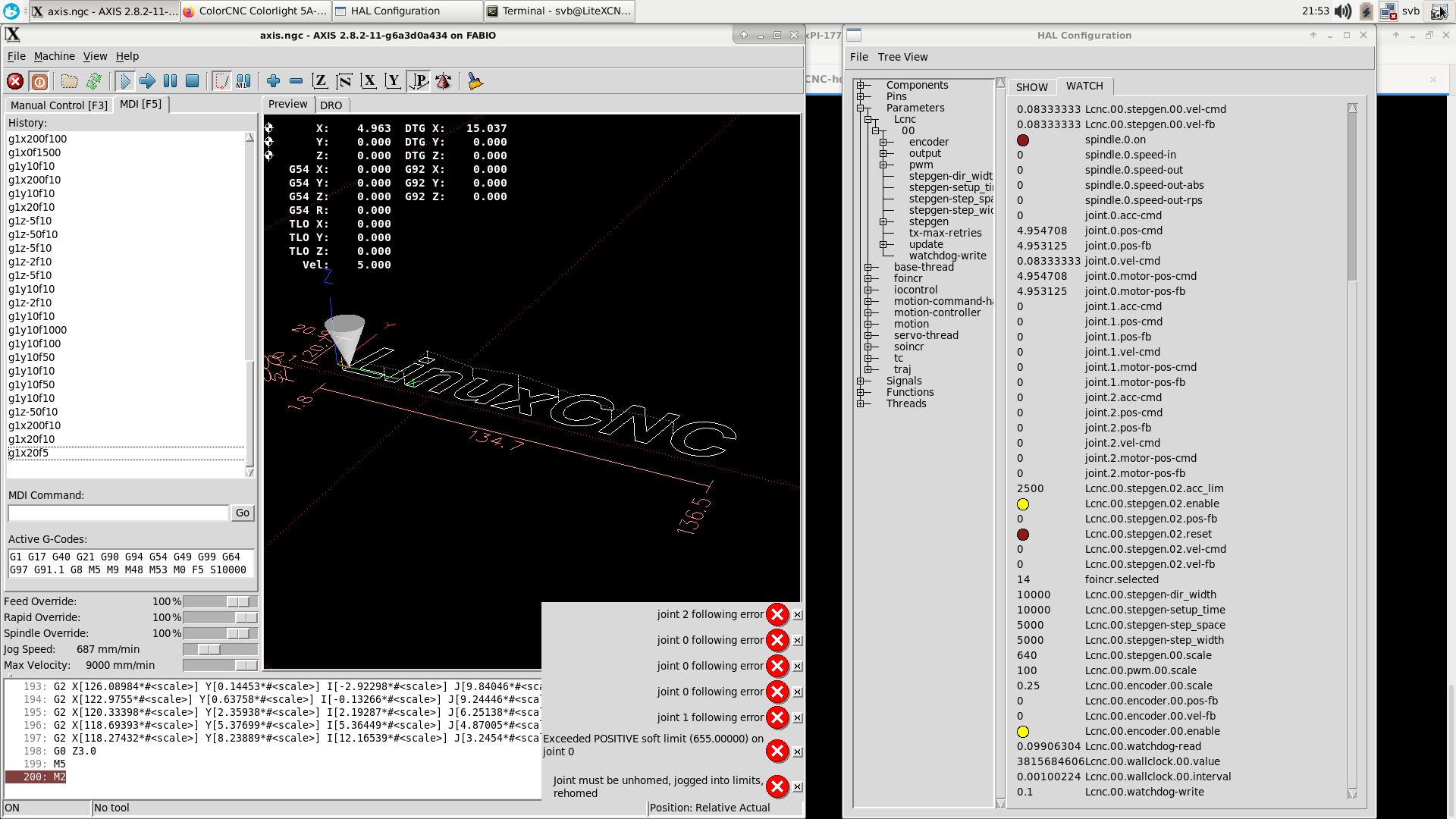

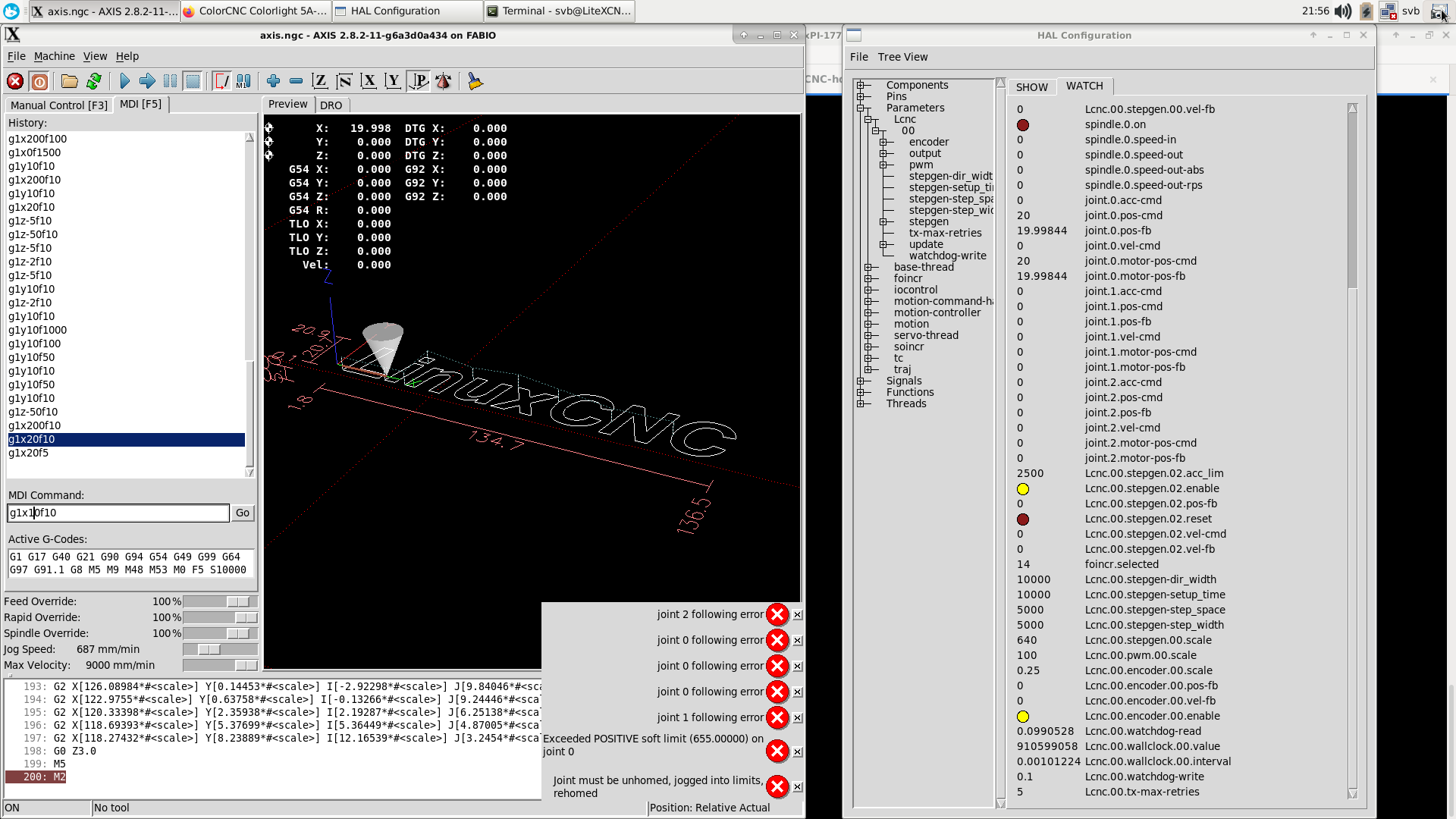

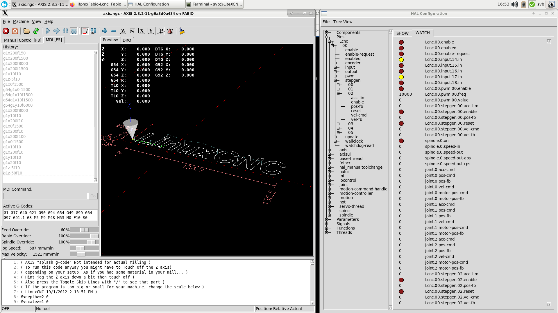

26 Jul 2022 14:07 #248327
by svb
Replied by svb on topic ColorCNC Colorlight 5A-75E/5A-75B as FPGA controller board
- muvideo
- Posts: 62
- Thank you received: 30
26 Jul 2022 14:21 #248328
by muvideo
Replied by muvideo on topic ColorCNC Colorlight 5A-75E/5A-75B as FPGA controller board
Hi, in your screnshots I see that Lcnc.00.enabled Is false, so the board Is disabled. Try to move Lcnc.00.enable-request to true (keep Lcnc.00.enable to true) and check if enabled becomes true.
Is the communication with the board working ok? How much Is the value of watchdog-read pin?
- svb
- Posts: 44

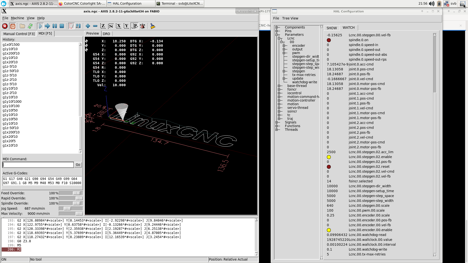

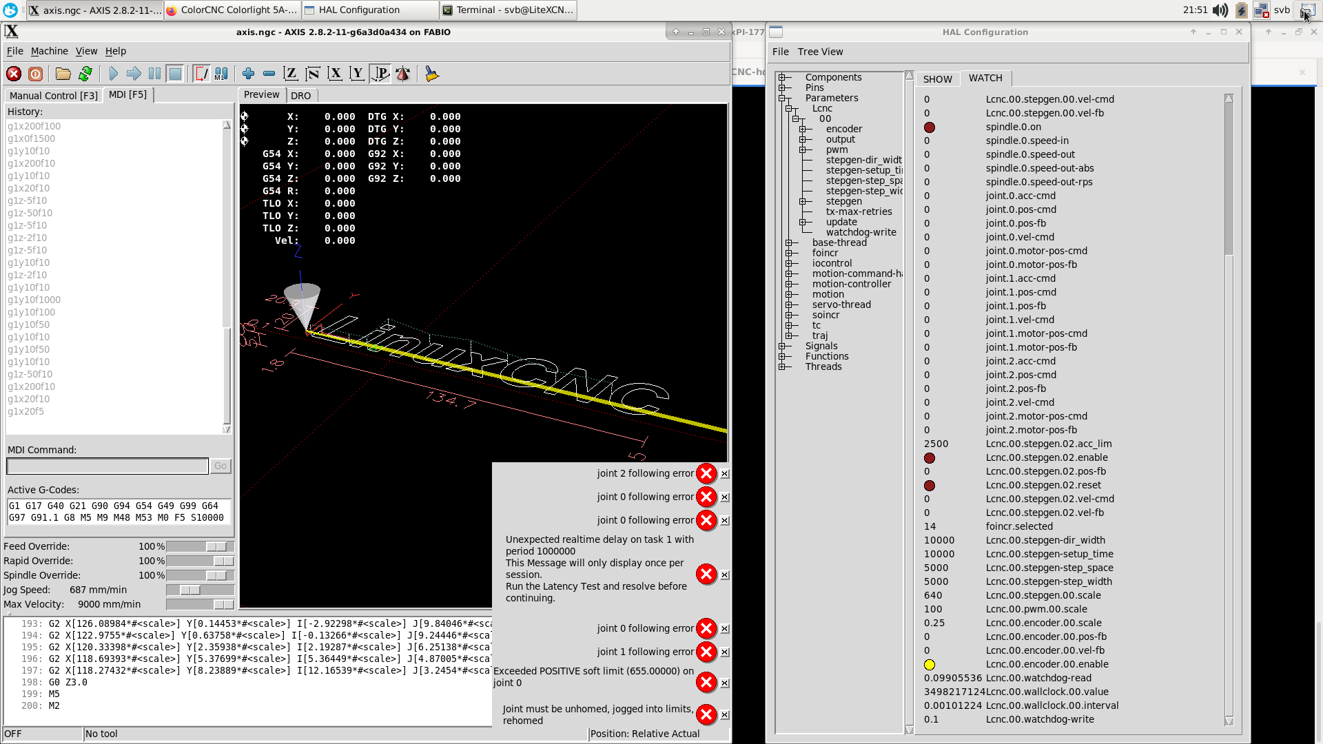

26 Jul 2022 14:31 - 26 Jul 2022 14:35 #248331
by svb
Last edit: 26 Jul 2022 14:35 by svb.
- muvideo
- Posts: 62
26 Jul 2022 14:43 - 26 Jul 2022 14:47 #248333
by muvideo
So there must be something that resets the board.
Suspects are:
- external reset input (in my script is routed to pin j4:6) be sure to have that pin to zero
- tx retries, if the communication is healty it should be no problem, but in doubt you can raise the value of Lcnc.00.tx-max-retries to an higher value
- watchdog (this is the first thing I owuld check): Lcnc.00.watchdog-write should be way higher than the thread period you are running at, I'm using 10ms (0.01) with 1ms thread period, you can monitor Lcnc.00.watchdog-read to see if it is dangerously near zero.
For testing you can raise Lcnc.00.watchdog-write to a very high value (tops out at about 5s).
Let me know how these values are now.
By the way, keep in mind that enable-request is evaluated only on it's rising edge false to true, so connect it to some input that you can toggle at runtime
Suspects are:
Last edit: 26 Jul 2022 14:47 by muvideo.

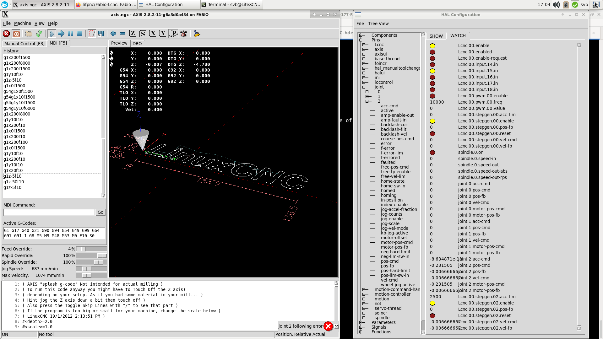

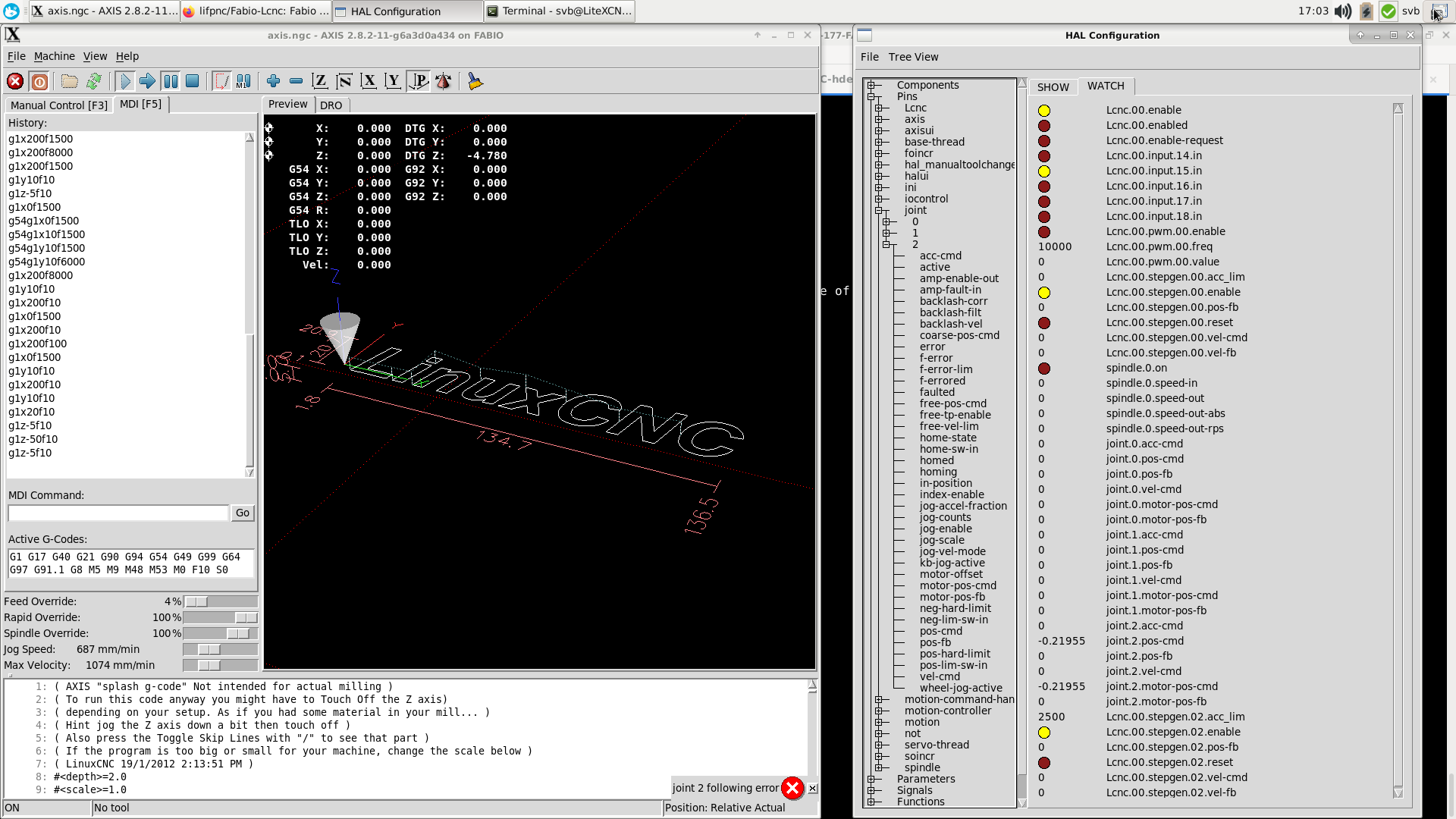

- svb
- Posts: 44
26 Jul 2022 18:59 - 26 Jul 2022 19:01 #248358
by svb
Last edit: 26 Jul 2022 19:01 by svb.
