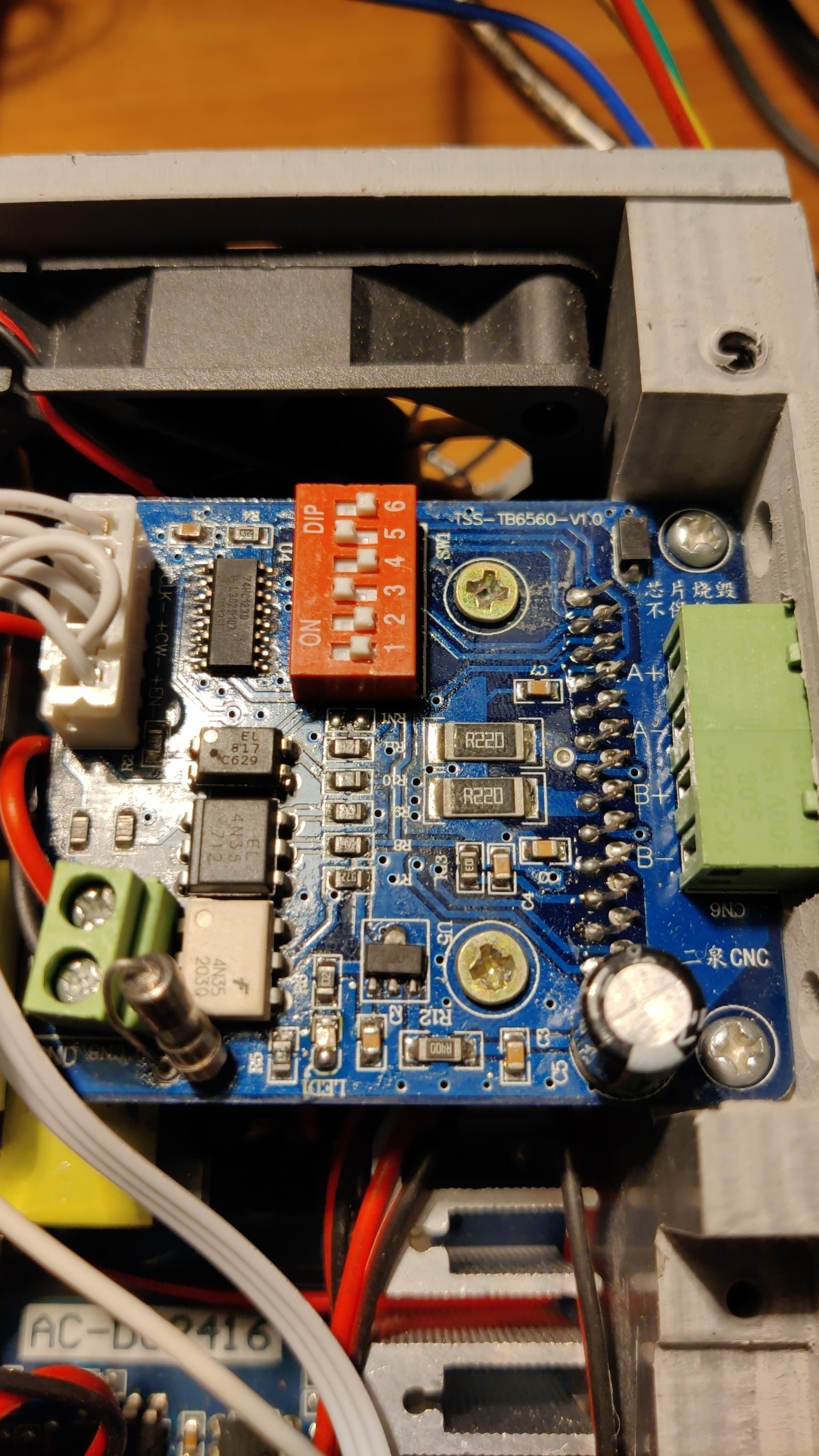

USB BOB does not work with LinuxCNC, but the driver board might be easy to use so upload a picture of the driver board.

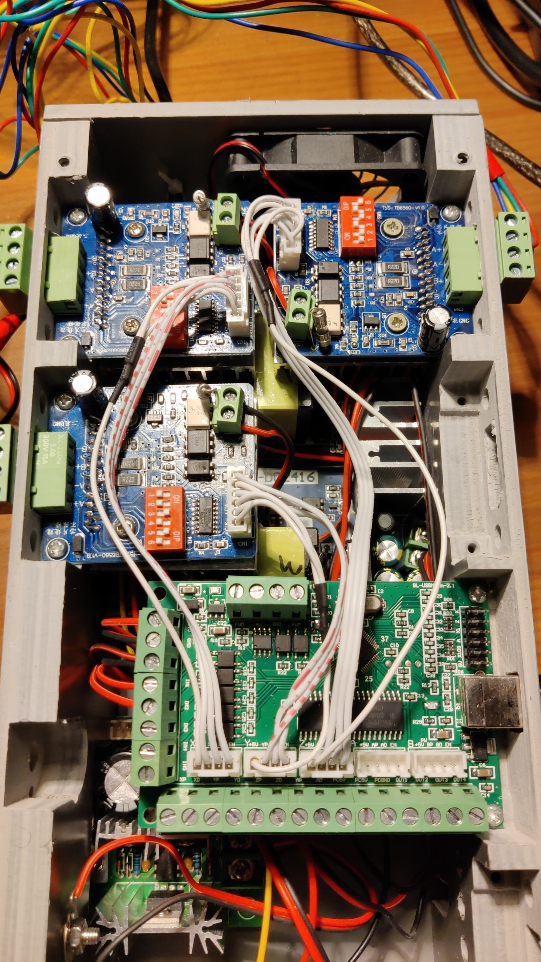

Here are the pictures. I would like to make a simple router, with just home switch, limit switch, coolant (maybe), MPG and a bit powerful spindle and with a bit big collet holder (like ER20 or something like that). Is the BOB Mesa 7I76E necessary or is there something more suitable? Which is the most used BOB Mesa? What if I also want to add the tool change? It's possible?

-Get rid of the green board with the USB port
-Get a normal cheap $15 BOB, it can be done even without this
-Find a PC with parallel port, or get a PCI or PCI-E add on card for $15
-Find a parallel port cable, usually comes with the BOB
Or forget all that and go for a Mesa 7i92 or 7i96 or 7i76E
BTW, Mesa 7i76 is not a normal BOB, it requires being attached to a Mesa 5i25 or 6i25 or 7i92 or.....

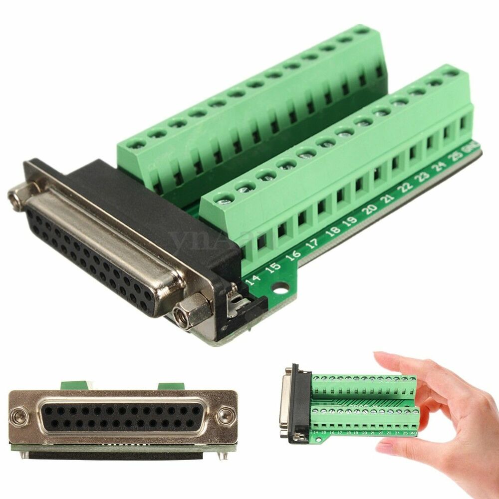

Ok now I'm considering a Mesa 7i92m.
With the 7i92m can I use a generic breakout board like the one in the attachments to connect the drivers/stepper motors and all the inputs/outputs?

Yes, you can use such a board, but you need to be very careful wiring stuff to it as Mesa 7i92 is sensitive to any negative voltage and anything above 7V will destroy it, i think.
To make things simpler, look at Mesa 7i92 as a parallel port (well it has 2 of them), but much, much faster.
The pinout can be the same as a parallel port, and you can use a cheap BOB just to be safer on wiring.

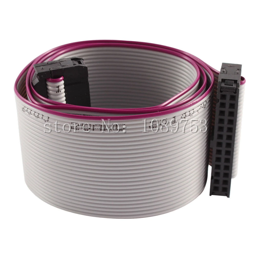

Will I need to connect something to the 7i92m's P1 HDR26 connector as well? If so, can I use a cable like the one I put in the attachments, strip every single wire and make connections via a terminal block? Because I haven't found a breakout board for this connector.
