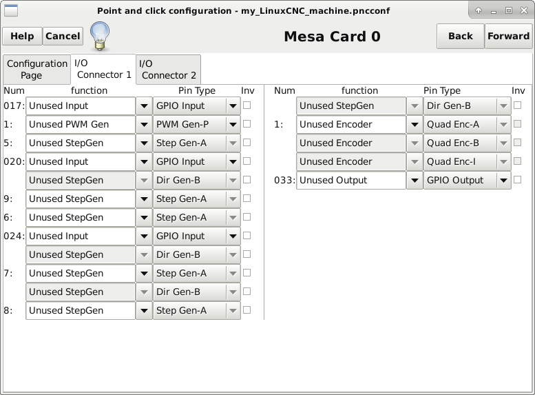

The .pin files are in the same directory as the firmware
( In the 7I92t.zip file in configs/hostmot2 )
They are created with the mesaflash --readhmid command
For example, the g540 pinout is this (7i92t_g540x2.pin) :

Thanks for the attachment, in the manual the pins on the P1 connector are different, I would have been wrong.
But in Pncconf they are not like that, I have attached some screenshots.
I haven't changed any settings on the previous pages, should I?
