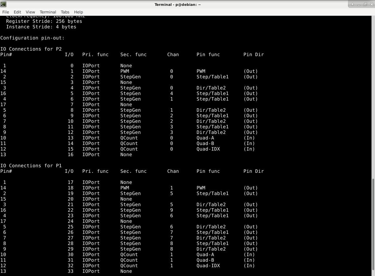

- Posts: 19896
- Thank you received: 4648
11 Jun 2023 11:14 #273324
There are the GPIO numbers associated with the FPGA, which in turn do not align to the pin numbers on the chip.
Then each of these is connected to a pin on the DB25 connector or HD50 connector.
Then, on the Mesa daughter boards the terminal block numbers are another numbering scheme, and these don't match the DB25 numbering, partly because there are lots more of them on many cards because the DB25 is partly carrying serial data.
Then the firmware on the FPGA determines which pin stepgen.0.step is on, for example (and this part _can_ be changed by changing the firmware)
You can get the actual pin numbers that you need, and the information about where each with mesaflash.
Will give you a printout which lists what is on each IO pin number, what the associated DB25 pin number or header pin number is, and which FPGA IO pin it is.
Replied by andypugh on topic Tips for noob, and USB BOB BL-USBMach-v2.1 compatibility
There are several pin numbering schemes throughout the system, and they don't line up for fairly good reasons.Ok. And what about the different pin numeration list? Can I change it manually? I looked at the "my_LinuxCNC_machine.ini" file but I didn't found the I/O list.
mesaflash --addr 10.10.10.10 --device 7i92 --readhmidWill give you a printout which lists what is on each IO pin number, what the associated DB25 pin number or header pin number is, and which FPGA IO pin it is.

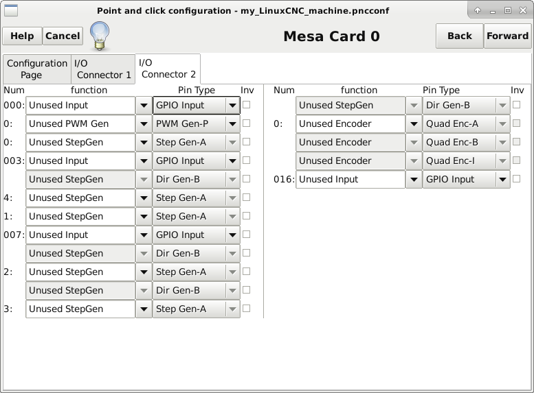

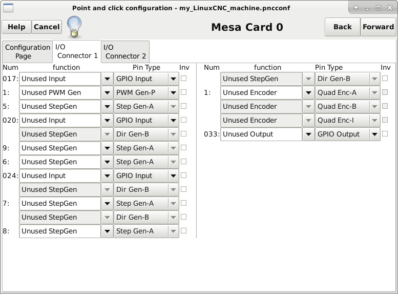

22 Jun 2023 05:39 - 22 Jun 2023 05:40 #274030
by CollieBabaX
Replied by CollieBabaX on topic Tips for noob, and USB BOB BL-USBMach-v2.1 compatibility
Thanks for the explanation andy, but sorry I don't understand.
With mesaflash I saw the I/O list but in PncConf the numbering is different from this one.
I have attached screenshots of the terminal and PncConf.
In the list I receive with mesaflash there is the number of the I/O and the corresponding DB25 pin, but why is the numbering so different in PncConf?

- Posts: 19896
22 Jun 2023 13:26 #274044
Pncconf is using the stepgen and GPIO numbers, looking at it.
What daughter boards (if any) are you using?
- CollieBabaX
- Posts: 35
22 Jun 2023 15:23 - 22 Jun 2023 15:23 #274050
by CollieBabaX

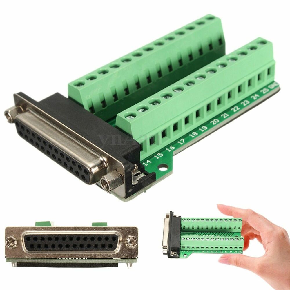

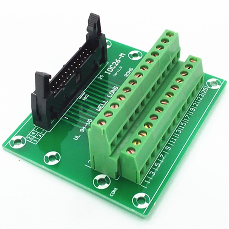

No daughter boards, just the two in the attachments.
But what do you mean by stepgen and GPIO numbers?
In PncConf some "functions" don't even have a number.
