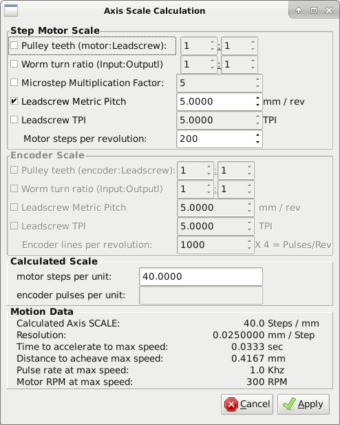

But I have a problem: I tried to move the axes with 5mm impulses to check if they moved correctly, and they didn't. The pitch of the leadscrew is 5mm, the motor has 200 steps, but to make a complete turn of the axis (therefore move 5mm) you need 16 commands of 5mm instead of 1, therefore ratio 1/16.
Seems to me the settings are correct, I have attached a screenshot of PncConf.
Where am I wrong?

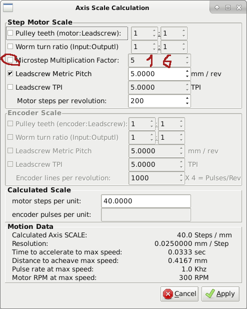

04 Jul 2023 17:18 #274757
Replied by tommylight on topic Need help to wire and config Mesa 7i92TM
- JPL

Do as Tommy wrote but also check S3 and S4 on your board. For 16 microsteps it is usually S3=0 S4=1. This is confusing because it is called 'excitation' in the manual but really is microstep.

I put 16 in Microstep Multiplication Factor and it works.
By S3 and S4 do you mean the 6 switches on the stepper drivers?
