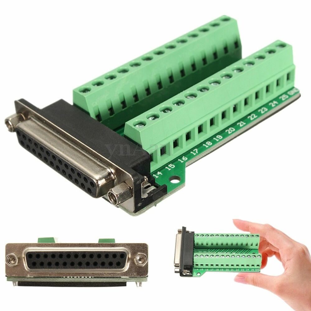

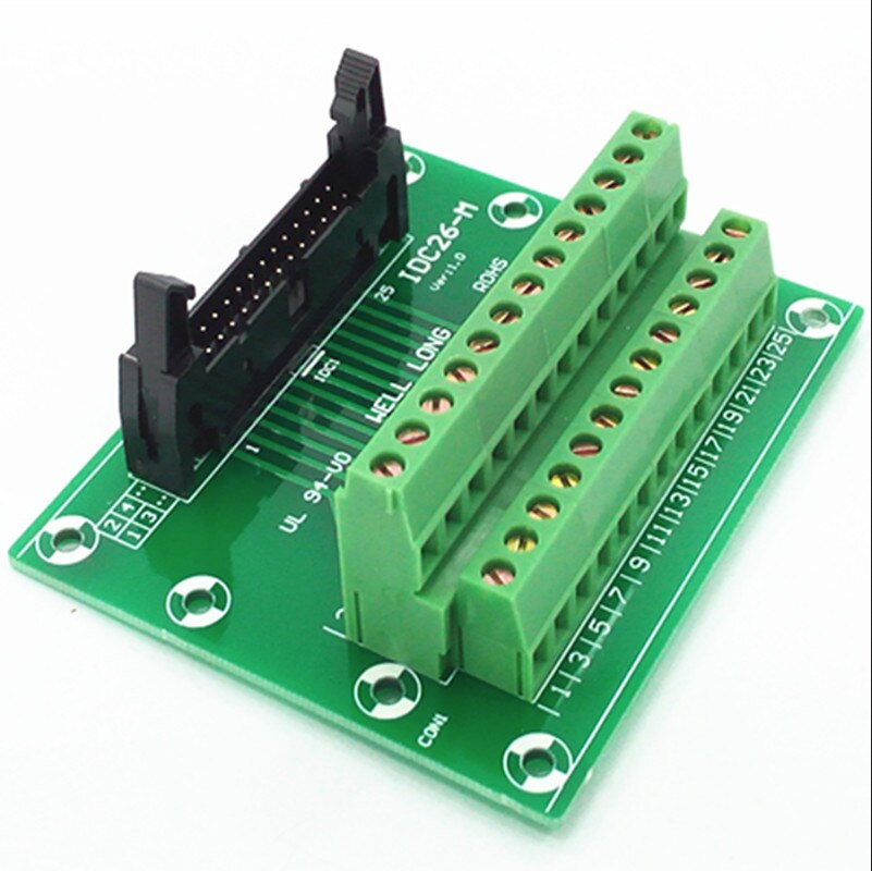

Hi guys, it's been a while but now I have everything I need (I hope).
I bought a Mesa 7i92TM and installed LinuxCNC 2.8.4 Debian 10 Buster PREEMPT-RT ISO on my computer.
But I don't understand which are the correct settings in the configuration wizards on LinuxCNC.
Should I use Pncconf since it's a Mesa board or should I use Stepconf since I have two generic BOBs? (see attached picture)
Thank you

- Posts: 21986
- Thank you received: 7486
26 May 2023 21:27 #272231
Replied by tommylight on topic Tips for noob, and USB BOB BL-USBMach-v2.1 compatibility
PncConf.
StepConf is for parallel port, you are not using a parallel port.

Ok, at point "Mesa Card 0" on "Board name " I select "7i92 - Internal data", but on "Firmware" what should I select? There are only BOB Mesa on the list.
- Posts: 18105
- Thank you received: 5328
26 May 2023 22:19 - 26 May 2023 22:20 #272234
Replied by PCW on topic Tips for noob, and USB BOB BL-USBMach-v2.1 compatibility
I would use a parallel port pinout compatible firmware like G540x2
Note that those are just physical breakouts without any output buffering
or input protection so you need to be quite careful with connections to
your machine as any even instantaneous connection to a voltage above +7V
or below -0.7V will damage the 7I92xx

- CollieBabaX
- Posts: 35
26 May 2023 22:37 #272236
by CollieBabaX
Replied by CollieBabaX on topic Tips for noob, and USB BOB BL-USBMach-v2.1 compatibility
Ok thanks for the warning, I'll be careful.
It says there are 34 pins in the G540, but in my BOB there are only 25 pins + GND. And the numbers in the I/O Connector don't match.

26 May 2023 22:48 #272238
There are 25 pins per 7I92 connector (17 are I/O bits and 8 are ground)
so with both connectors, you have 34 I/O total I/O bits
Note that your DB25 adapter pinout matches the pinout printed by mesaflash
or the .pin files included with the 7I92T firmware
(though the GND pins = 18..25 are not shown)
