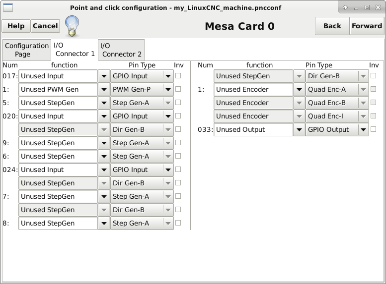

And why is there that strange numbering in PncConf?
- Thank you received: 4654
22 Jun 2023 16:15 #274054
Replied by andypugh on topic Tips for noob, and USB BOB BL-USBMach-v2.1 compatibility
The numbers in Pncconf are the function numbers, eg stepgen.0, pwmgen.0, or for pins where the function is not used, the GPIO number to match the HAL file pin names.
hm2_7i92.0.gpio.016 for example.

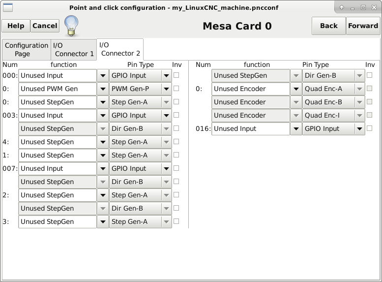

22 Jun 2023 16:26 - 22 Jun 2023 16:26 #274055
by CollieBabaX
Replied by CollieBabaX on topic Tips for noob, and USB BOB BL-USBMach-v2.1 compatibility
In my PC in PncConf the numeration is like 000, 0, 0, 003, 4, 1, 007, ... see the attachments
I don't understand, where do you get the stepgen.0, pwmgen.0, ... numeration?
The first pin is an unused input, being set up as GPIO, and is GPIO 000, and would appear in HAL as hm2_7i72.0.gpio.0000
The next pin is being set up as a PWM. It is pwm number 0, and would be controlled in HAL by the pins hm2_7i92.0.pwmgen.00.enable, .value etc.
The next pin is a stepgen, number 0, and would be controlled by h2_7i92.0stepgen.0.position (etc)
And then there is gpio.004, then the DIR pin for stepgen.0 (not numbered, I am not sure why), then stepgen.4 step and so on.
But, all you need to do in that screen is decide what you want to use each stepgen and PWM for. Then you work out which pins they are on the BoB from the mesaflash output.

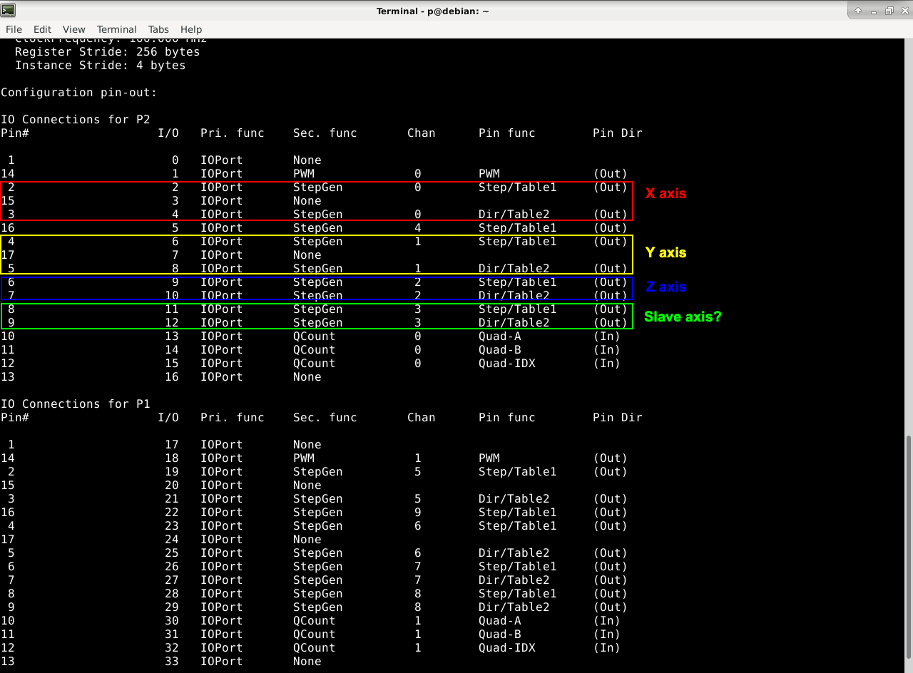

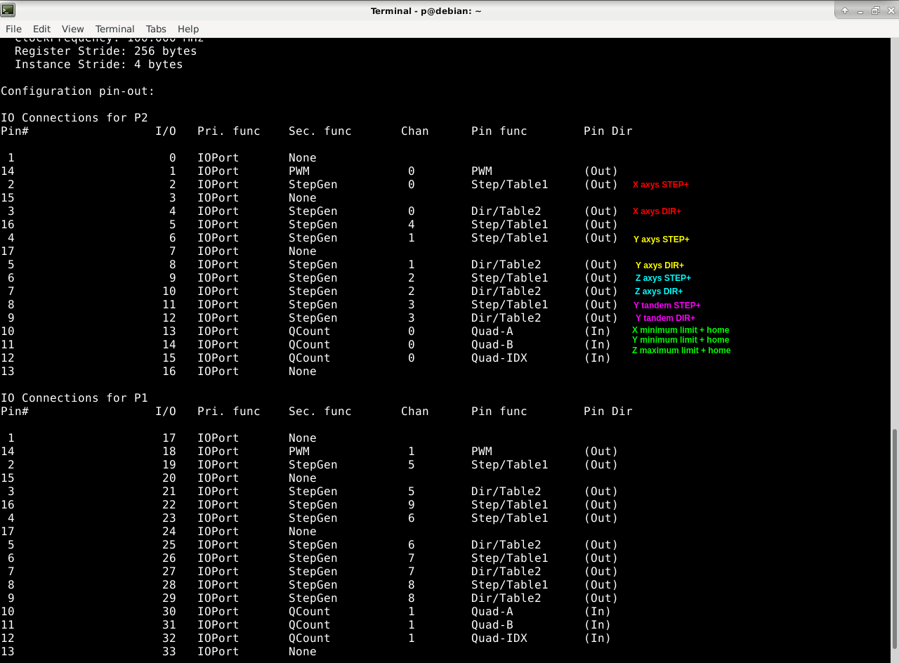

26 Jun 2023 13:24 - 26 Jun 2023 13:24 #274247
by CollieBabaX
Ok so is the diagram in the attachments right?
And why there is not the enable pin? Don't need it?

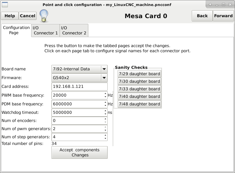

29 Jun 2023 14:24 - 29 Jun 2023 14:25 #274452
by CollieBabaX
Replied by CollieBabaX on topic Need help to wire and config Mesa 7i92TM
I tried to change the configurations in PncConf to add limits switch in I/O, but with "mesaflash --addr 10.10.10.10 --device 7i92 --readhmid" it give me the same I/O pin numbers of the last screenshot, how can I add these inputs?
Last edit: 29 Jun 2023 14:25 by CollieBabaX.

Replied by PCW on topic Need help to wire and config Mesa 7i92TM
The readhmid printout lists the firmware pinout
This is not affected by LinuxCNC or pncconf
If you wished to say use DB25 pins 10,11,12 as limit switch inputs
you would chose GPIO pins 13,14,15 in pncconf and assign then to
the desired limit switch inputs.
Before doing this in pncconf, you would need to disable the encoder
by setting the number of encoders to 0

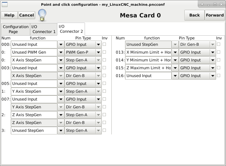

29 Jun 2023 16:02 - 29 Jun 2023 16:05 #274460
by CollieBabaX
Thank you PCW
So if I understand correctly it should be like in the attached screenshots, right?
I also put the Y tandem axys but I don't have it at the moment, I will add it in the future.
