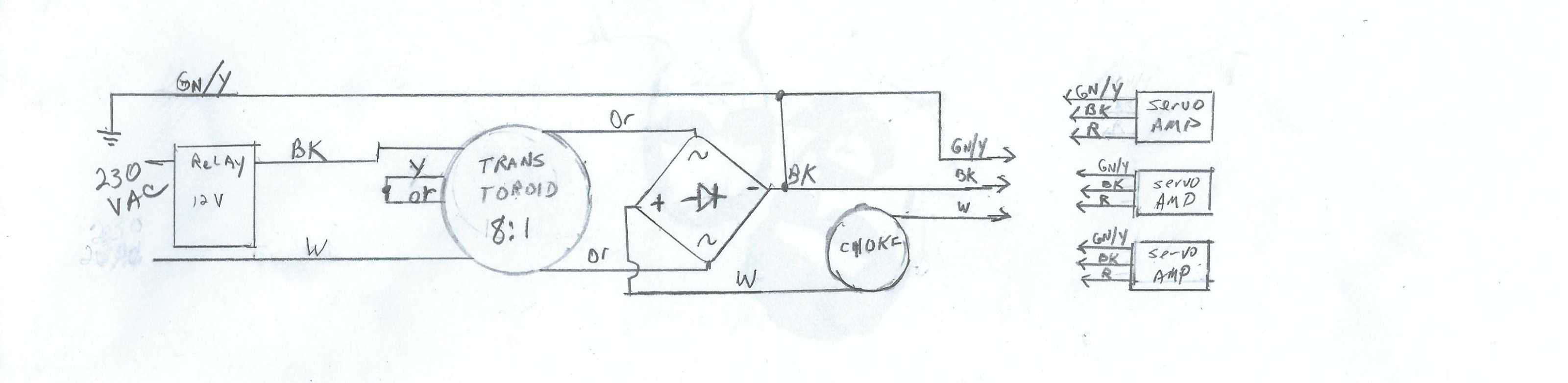

- steve_a
- Posts: 75
05 Nov 2015 12:52 - 05 Nov 2015 13:07 #64792
by steve_a
Replied by steve_a on topic Light Machine Corp. Benchman XTr (retrofit)
I have been working on preparations to do the controller swap and ordering a few parts I think I will need. While I was at it I decided to look closer at the drive supply. I did a quick ohm check of the BAT (Big A__ Toroid) and saw appox .8 ohm on both the input coils. I hadn't noticed before but there is only 1 output coil. ( I can only assume that is because this is a custom built toroid specifically for Light Machines and they designed it specifically for this machine.) The output showed about .2 ohms. Since the two .8 input coils are tied in series that makes an equivalent 1.6ohm coil making the input to output ratio 1.6/2 or 8:1. That gives 230V/8 = 28.75 V out. That seemed really small to me so I looked at the motors.
It turns out that My Z axis motor is a Moog C23-L50W20M09 and I believe the X and Y are the same. I looked at the Copley Controller information and noticed there are components added to match the motor to the controller. Page 5 shows what the components do and what values are needed. I found the RH15 resistor and determined it's values to be 402K which matches with model 4122 controller for a 1.8 to 4.8 mH Armature Inductance. Next I referenced the C23 series Motor specs. www.moog.com/literature/MCG/moc23series.pdf from Moog. The Motor shows an inductance of 1.96 Mh, in the correct range so I'm sure this is all set up correctly.
OK the reason I think all this is important is because I was wondering why the BAT looks like it will only source a calculated 28.75V. The motor specs shows that his motor is tolerant from 12-60V and rated for 24V. That seems to confirm my ohm measurements. Additionally, the Copley Controller operates from 22V to 90V.
So things are pointing to a 24V system. At least that's MY model with a 5000RPM spindle. Here's what I believe the drive supply looks like. (OOPS! wrong ratio... should be 8:1... I'll redraw and resubmit.)
I'm still waiting for my MESA controller so I am a bit stuck for now... I guess I could bypass the enable relay and see if I get 24V. Otherwise, I'm kind of at a standstill for now but I guess I need to find a relay board SO I think I will work on that.
