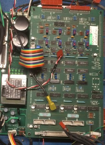

Got a question for you gurus out there. Something strange. I THOUGHT the Copleys were set up in Velocity mode... but I don;t see where they are getting a Tachometer reading. Is it the index pulse from the encoders? Did I miss an actual brush tachometer? Also, the Manual defines component values (appox) for Torque and Velocity modes.... these seem to be set up as BOTH. CH11 has a zero ohm resistor (a short) that you would see in torque mode instead of a small cap... and CH9 is supposed to be blank for torque mode but instead has a 220PF cap installed like you would see in Velocity mode. Coupled with the missing Tach I'm totally confused. Anyone have any ideas on this? My first thought is to convert the Copleys to Torque mode to avoid a conflict with the controller that thinks it is controlling everything.

- wrightsh
- Posts: 8
13 Jul 2016 21:03 #77421
by wrightsh
Replied by wrightsh on topic Light Machine Corp. Benchman XTr (retrofit)
So on my ProLight (which I think is pretty much the same machine) there's a board that takes the encoders as an input and runs through several logic chips to produce a tachometer output. At one point I tried tracing out all of these components and found datasheets for them and got a schematic but if I remember correctly I would have needed a few more supply voltages then just +5 and +24. I think each of the LED's below and to the left of this tachometer board correspond to each of these supply voltages which are fed from the box that houses the computer. I ended up just getting rid of that board and running the servos in torque mode and have been happy with it. I can look up the tuning values that I used if you want.
-Shawn

Thanks Wrightsh! That board is similar but I think there are some differences. It IS pretty close though and I'm sure your explanation is the right one. I have the original tuning values, they are listed in an earlier post on this thread but if you have other values I would love to see them. Tuning is supposed to be the hardest part and I suspect the values I should use for this new controller are either the same or some numeric ratio. Anyway, if you can post those without too much trouble I would appreciate that.
