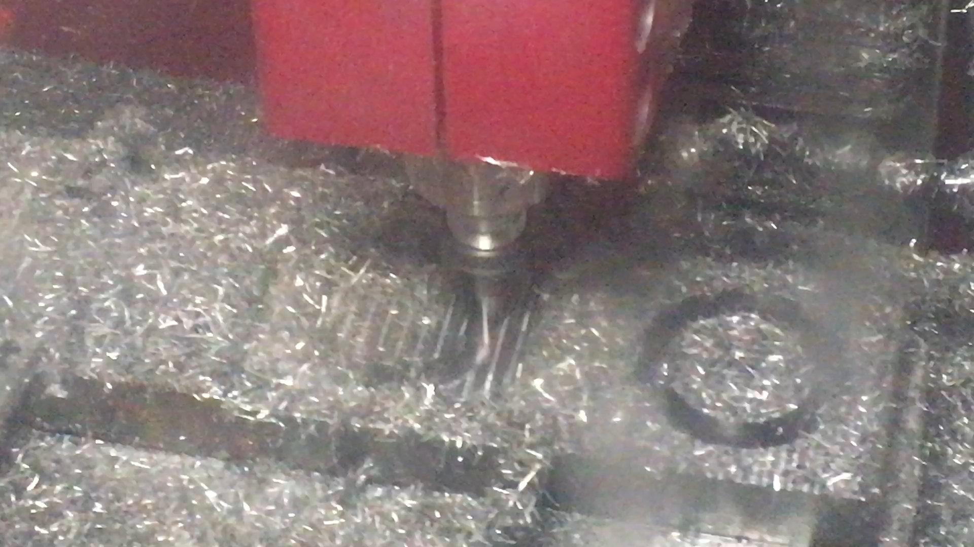

Hi Folks, firstly great to read through this thread! Such fantastic info.
I picked up an MX not long ago and this really helped me understand the machine. Hey it only took a year, but here we are. I know this is my first post, but I've been having an impossible time with my MX figuring out configure any I/O connections. It's one of the main reasons I (drove over 30 hours each way, Oh Canada) to pick up the Mill. Can anyone familiar with this machine help me out a bit? Apparently I need a "Canbus i/o module" which I can find online, and I'm guessing connects to the parallel port in the back of the machine. If there's anyone out there that can give an overview of what it takes to get some I/O's/Pneumatics running from my MX, I'd be forever in your debt. Heck I'll even send someone some money if they can help a fella out, I just don't even know where to start.
Note: I know it's reasonably simple with Mach systems for general I/O, but the MX and software appears to be far more complex, unfortunately.
Thanks very much if someone takes the time to read and help. I have notifications turned on for this post.
(added a photo for fun, trochoidal milling 1" steel, awesome machine)

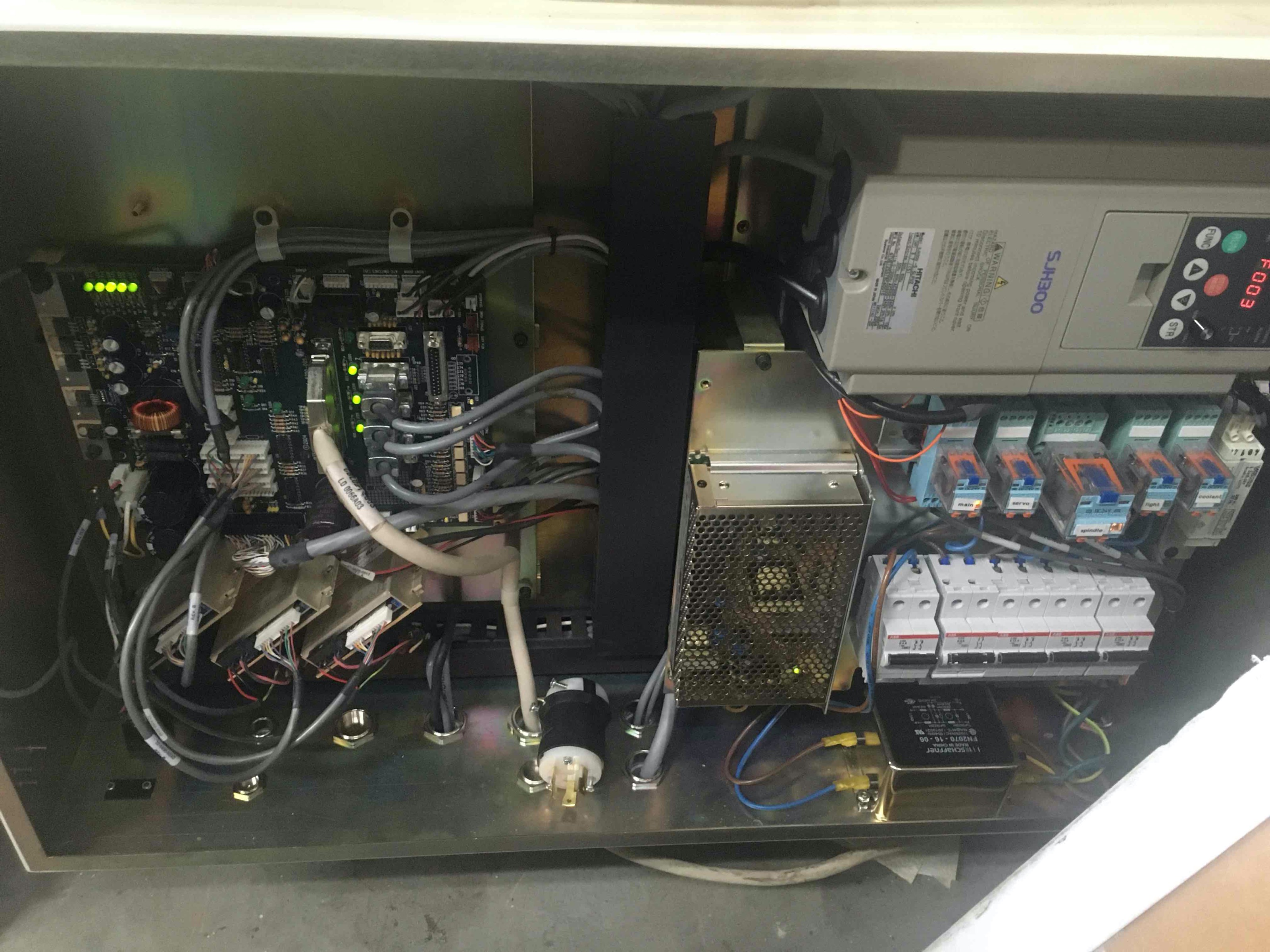

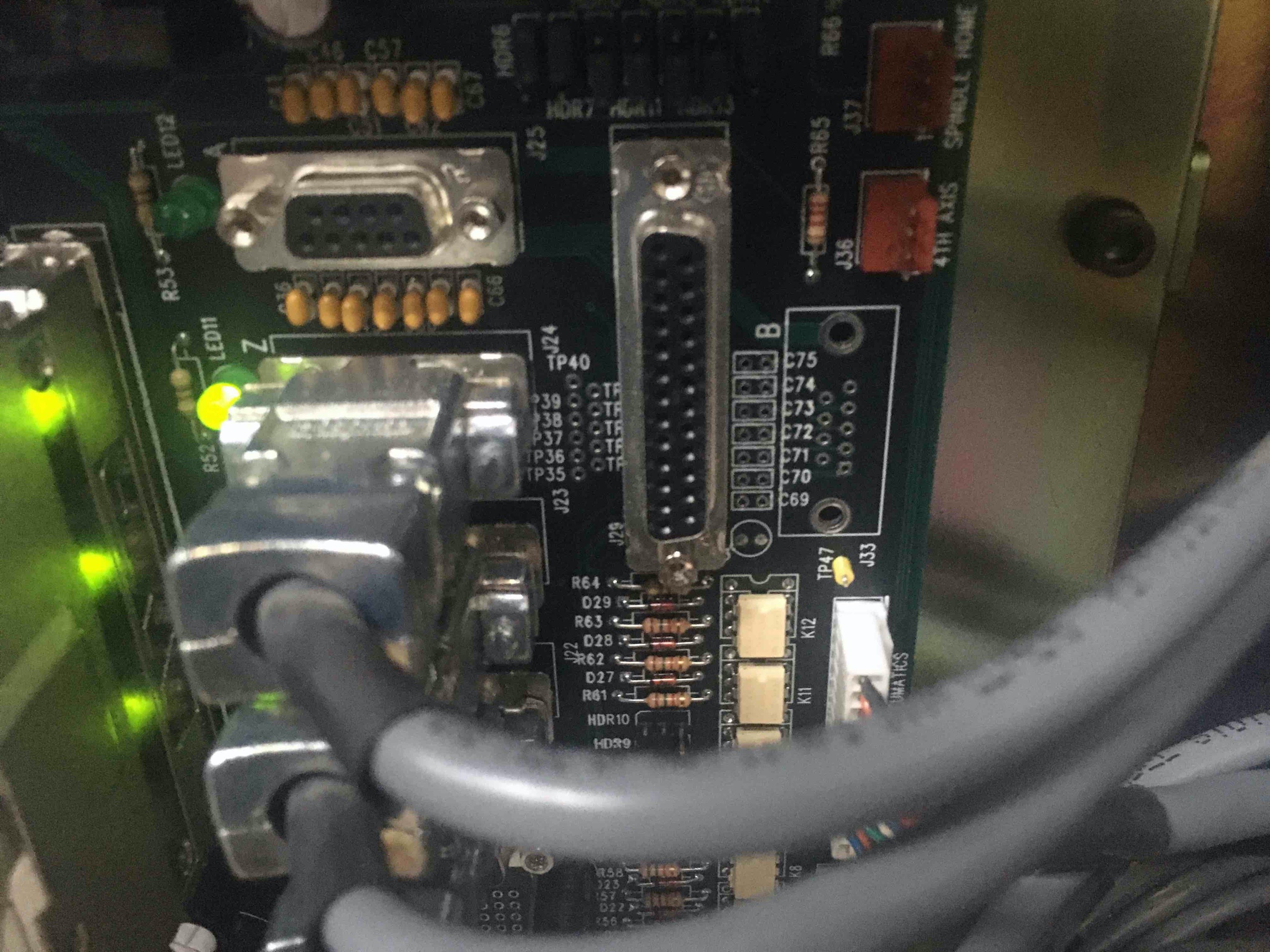

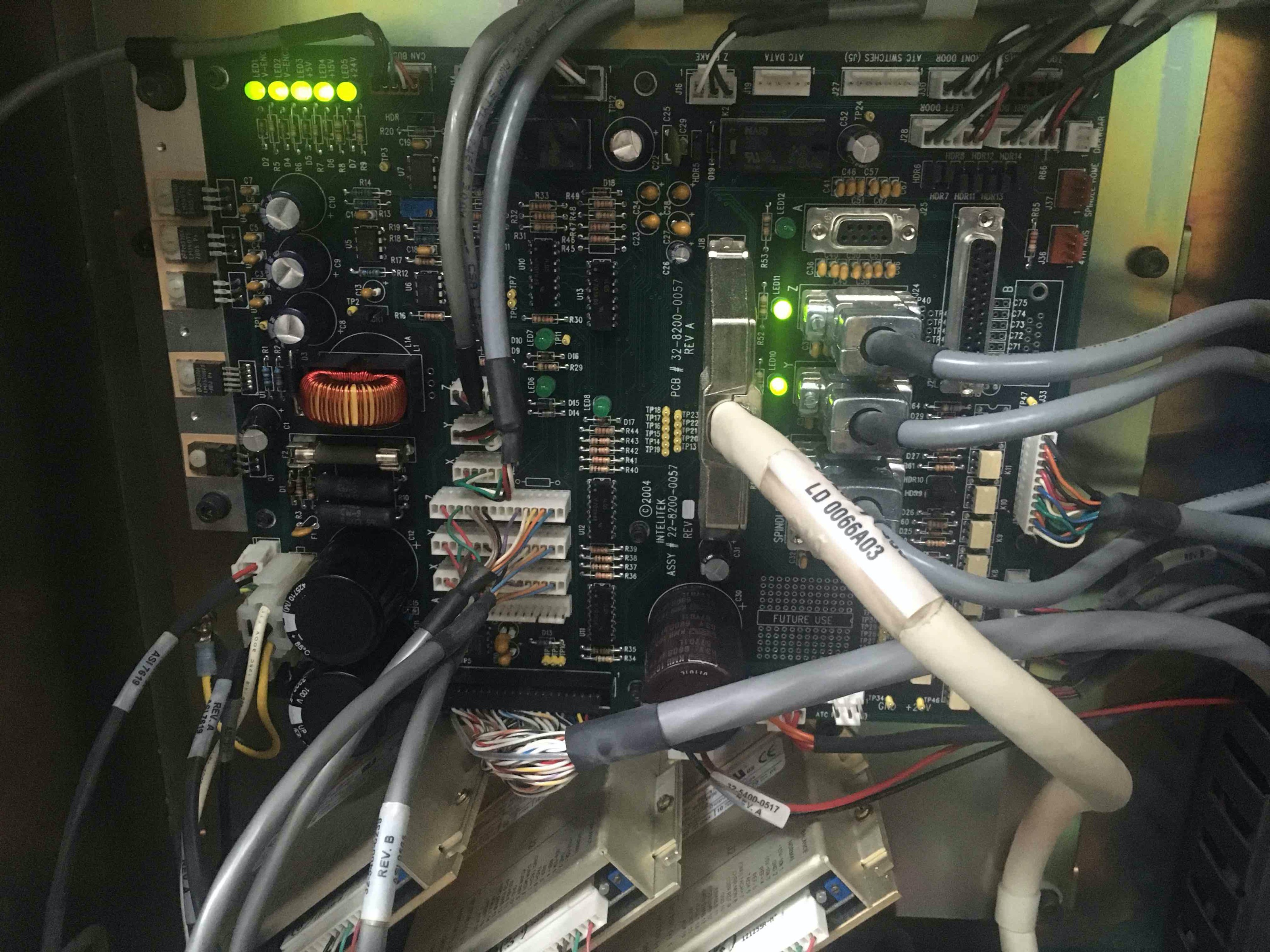

- justbyfaith
- Posts: 2
07 Dec 2020 21:12 - 07 Dec 2020 21:25 #191356
by justbyfaith
Replied by justbyfaith on topic Light Machine Corp. Benchman XTr (retrofit)
Great Question, Tommylight. Thanks for the reply. I thought the same until I found out that I/O Canbus Modules were an option for the machine. Now that being said, is that Module just an insulated I/O breakout board? I'm not sure, and I have spent hours and hours or searching for anything intelitek related about the matter, but came up fruitless. I called Intelitek, but they do not support this machine anymore nor do they give wiring diagrams. There is someone there that I can speak with, but $350 ish CAD per hour for an hour or two is a little steep. I'd rather not go down that road here in 2020 if possible.
What I do know is this:
- The parallel is the only open port on the board besides the canbus port (which I'm assuming is to program the board). The serial port is for a 4th axis.
- Intelitek told me the machine is capable of I/O inputs and outputs.
- None of the other Intelitek mills from the time say anything in their manuals.
- The spec sheet lists "Canbus I/O Modules" as an option for the machine.
- The Interface from the mill board to the CPU is a 100 pin cable
What I don't know is:
- How to even start testing the parallel port without some sort of diagram. Without damaging anything.
- If intelitek requires additional software to run an I/O board within the software. These were build modularly, but within my software, I don't even have options to install an air vise, bigger ATC, automatic door opener, etc. that were all options with this machine.
If I had answers to these two questions, I could at least make a bit of progress. Here is a photo of the port/board. Thanks
