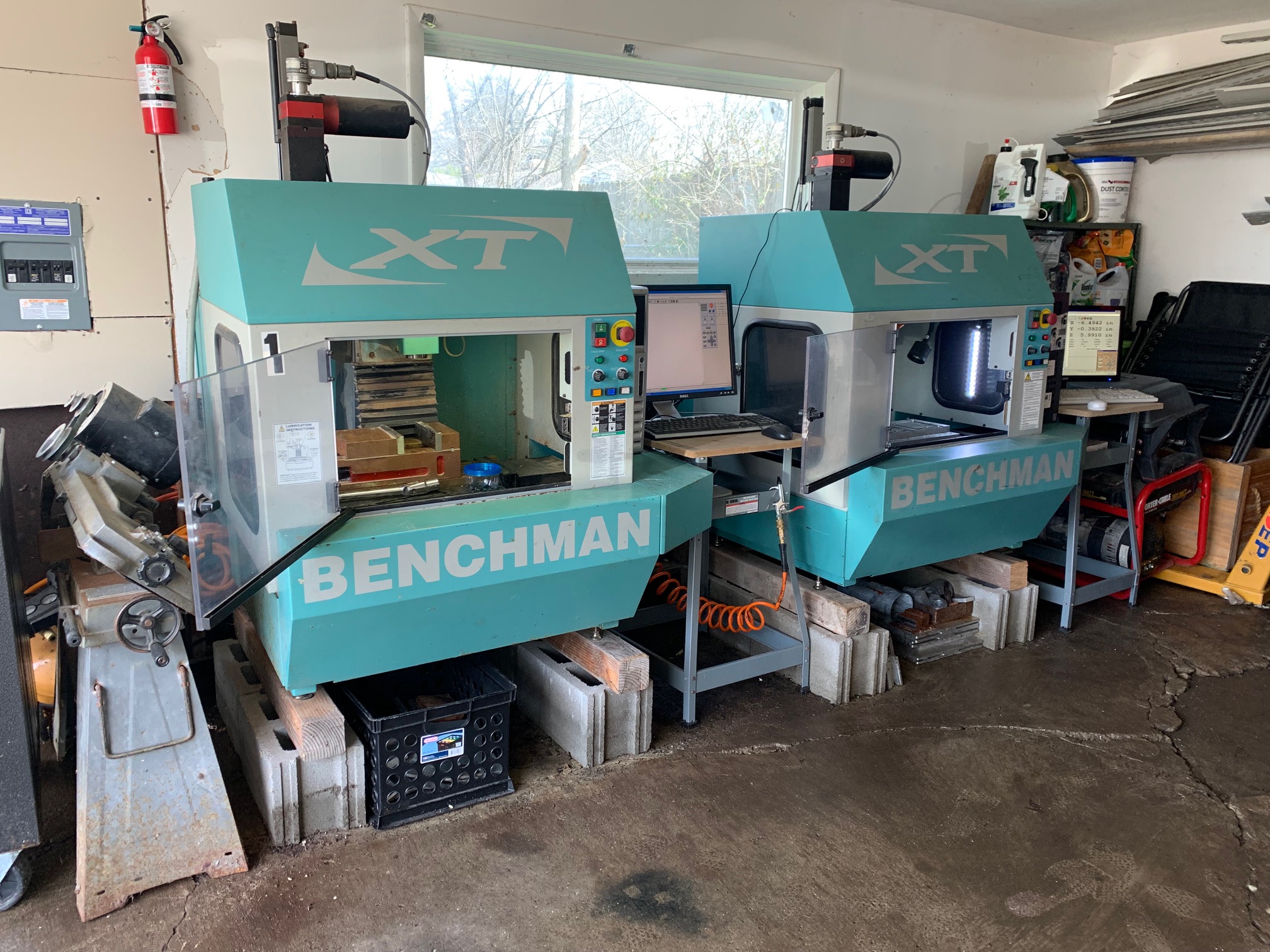

Hi Guys,
I am listing two Benchman XTs for sale in Grand Rapids, Michigan. Both are operational and under power now but one is in need of some y-axis work as it seems like it's got a pretty gnarly groan to it. Would love to hand them off to an enthusiast like the folks are on here. Asking $3k but they will require pickup in Michigan from a residential address.
Ryan
grandrapids.craigslist.org/tls/d/grand-r...ning/7475023151.html
Ryan
