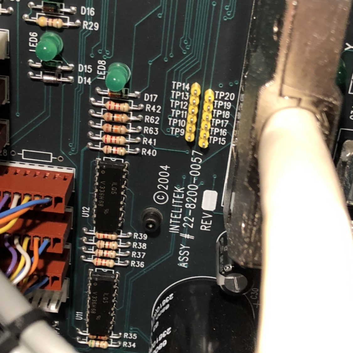

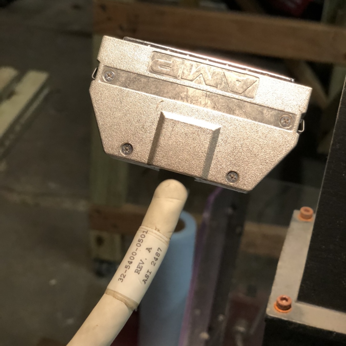

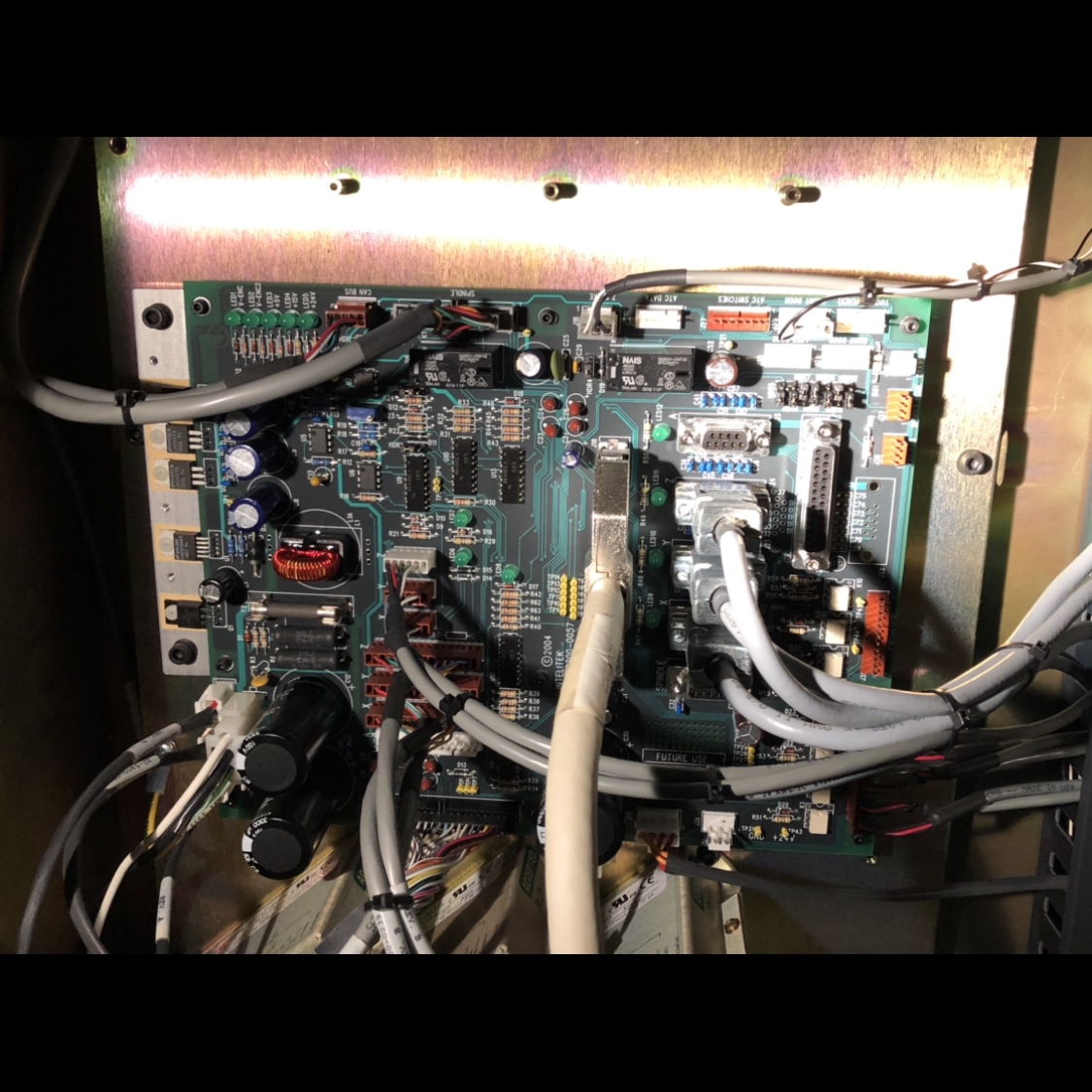

justbyfaith,
That is not a parallel port, it is the interface to the rotary 4th axis.
The can bus is connected via J10 on the motherboard.
I have attached the block diagram for your machine.
I have the schematic of your motherboard, but it is not in .pdf format.
It will take me a bit to convert it.
But this should get you started.
Let me know if you have specific questions.

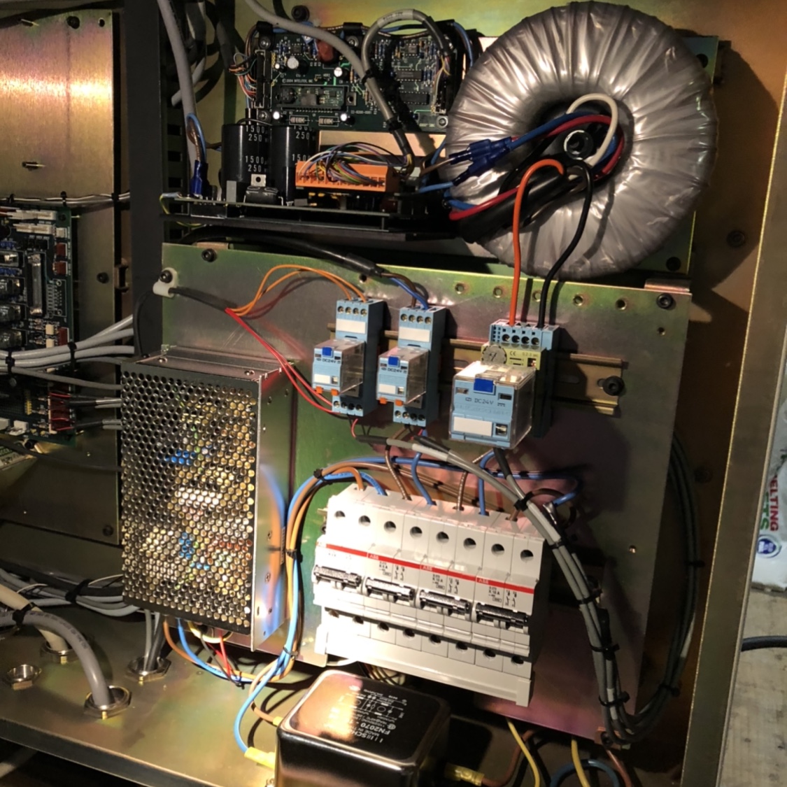

Hello everyone,
Amazing thread here. This is my first post on this thread and website. I am amazed by the information on here.
I am reaching out to the group with my dilemma.
I've purchased a Benchman MX not to long ago.
It has some surface rust, but other than that, the machine looks great. The electronic seem to have never been touched, or damaged. The issue lies there. I do not have access to 240V the the machine needs (however I can have an electrician install it if necessary). The machines did not come with a computer or PCI board.
My questions are:
Is there a way to retro fit the machine by using most electrical components that are present?
Is there someway to step down the needed voltage to 120 v?
Is the software and machine capabilities worth paying $1K+ for the pci card to run this machine (as well as the electricians work)?
I'd hate to rip everything out and have to change the servos, spindle motor, and motherboard, but if there is no other way, than that can be done.
Hopefully someone read this post. It'd be awesome to get opinions.
I've posted some photos of mostly everything, If anyone needs more picture I can do so.
I also have a Prolight 1000 with ATC system, and solenoid valve all running on original hardware and software incase anyone needs photos of any boards or wiring.

29 Apr 2021 13:40 #207371
by x-Intelitek Engineer
Replied by x-Intelitek Engineer on topic Light Machine Corp. Benchman XTr (retrofit)
That is a pretty nice machine. It will run on your 240 line (think dryer or oven power) and it will run on 208 (2 of the 3 phases of 208 3-phase), it will not suffer precision, only the max performance will be slightly lower than true 240. Converting this machine to 120V presents a myriad of issues, with the major one being the spindle power. It is technically possible to change the other circuitry to 120V, but that may be a larger engineering task than desired. You would still need an electrician to give you a 120V circuit that will handle 30A minimum. Let me know if you need further assistance.
