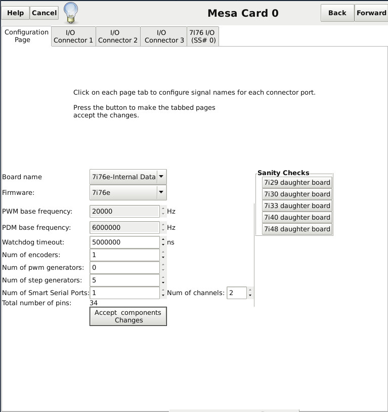

Emcoturn 120 lathe retrofit
07 Jul 2016 18:22 - 07 Jul 2016 18:23 #77164 by LutzTD
Replied by LutzTD on topic Emcoturn 120 lathe retrofit
looks like the mesa is connected and working properly.
user@linuxcnc:~$ halrun
halcmd: loadrt hostmot2
Note: Using POSIX realtime
halcmd: loadrt hm2_eth board_ip=10.10.10.10
iptables: No chain/target/match by that name.
hm2_eth: 10.10.10.10: Hardware address:
hm2_eth: discovered 7I76E-16
hm2/hm2_7i76e.0: Smart Serial Firmware Version 43
Board hm2_7i76e.0.7i76.0.0 Hardware Mode 0 = standard
Board hm2_7i76e.0.7i76.0.0 Software Mode 0 = io_spin
Board hm2_7i76e.0.7i76.0.0 Software Mode 1 = io_ana_spin
Board hm2_7i76e.0.7i76.0.0 Software Mode 2 = io_enc_ana_spin_fv

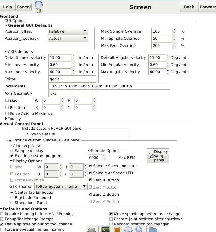

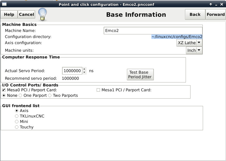

07 Jul 2016 18:47 - 07 Jul 2016 19:43 #77166 by LutzTD
ok I warned you. Screen 1
name self explanitory
config dir default
axis config assume lathe xz
machine unit, leadscrews are metric, should I work in metric or will the conversion be a non-issue?
actual servo period ????????
recommend ?????????
i/o control I put the first mesa, is this ok?
gui front end, i searched, axis looks good for me

08 Jul 2016 04:02 #77172 by andypugh
Replied by andypugh on topic Emcoturn 120 lathe retrofit
For a Mesa card setup there is hardly ever any reason to use anything other than 1000000 (1 mS) for the servo period.
So, everything on that screen looks right.
09 Jul 2016 07:03 #77215 by LutzTD
page 2
not sure about position offset or feedback
overides not necessary
not sure about the axis defaults
axis geometry, should this be xz
I want to include one virtual control panel I think, just to have the sample code
want to be able to move so I can position before homing
dont need toolchange popup, toolerator should do this
spindle can stay on
dont want to force homing I dont think
spindle up before tool change, I think this is also go to home
dont need restore jointdont want random tool change

09 Jul 2016 08:32 #77217 by andypugh
I think "spindle up" is wrong for a lathe, that's a move to max Z and risks finding the tailstock in the way.

09 Jul 2016 10:49 - 09 Jul 2016 10:50 #77222 by LutzTD
page 4 configuration
7i76e is there
I dont have any pwm
dont know what pdm is? assume is step generator?
frequency?
watchdog timeout value?
encoders, is this in the systel like the spindle or for the axis
0 pwm generators
step generators, I think 2, x and z
serial port 0
no daughter cards
Last edit: 09 Jul 2016 10:50 by LutzTD.
