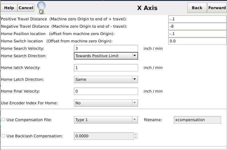

Replied by andypugh on topic Emcoturn 120 lathe retrofit
I would make X home switch 0, home position -0.1 and negative travel max -8 and positive travel max -0.1, I think.
(Because PnCConf won't let you change the home switch location)

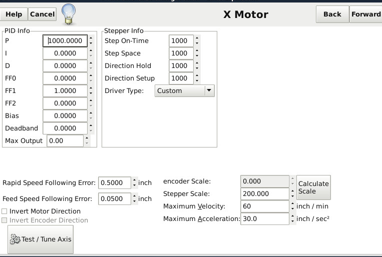

Replied by LutzTD on topic Emcoturn 120 lathe retrofit
Set the P-gain to 1000.
In later versions the PID values are not alterable, but the P-Gain is fortunately set to the right value.

10 Jul 2016 13:10 #77260
That seems wrong, and I thought that 8" cross-slide travel seemed a bit much for an Emco.
Z is saddle, X is cross-slide.
And both mills and lathes the Z axis runs along the axis of the spindle.
I duplicated the x on the z with smaller axis length value

10 Jul 2016 14:13 #77261
by LutzTD
yeah I had it backwards. I will fix it

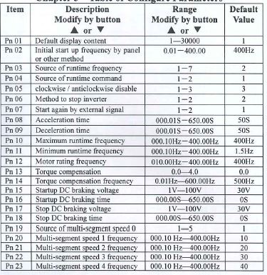

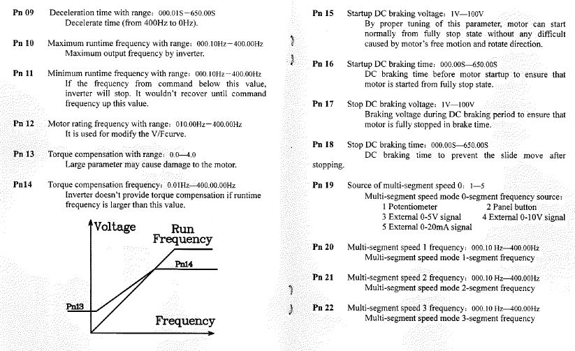

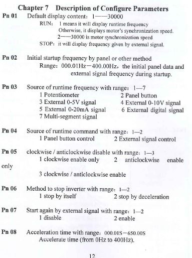

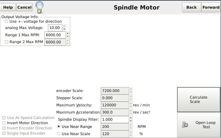

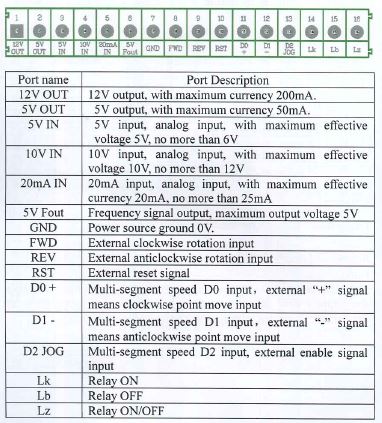

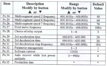

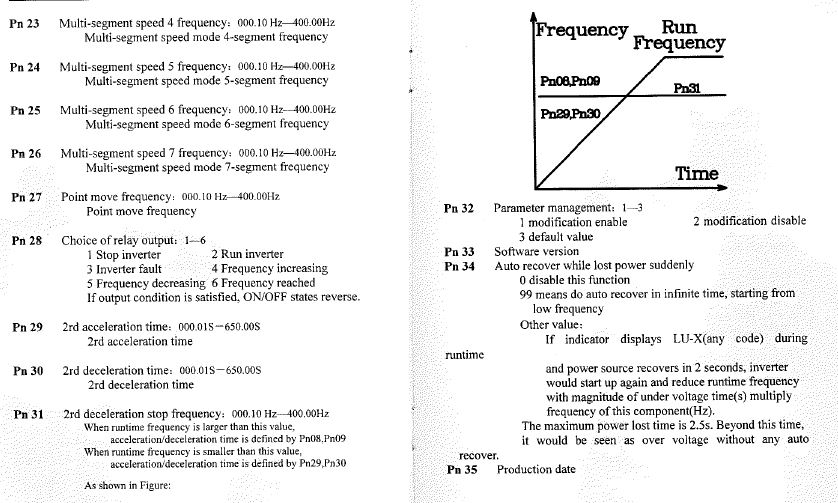

time to work on the spindle. hooked it up to my first guess and nothing. manual buttons NO, M3 NO. I am not sure if I have the VFD setup or wired correctly or if I have a program issue. so here are the culprits.
spindle section of HAL
spindle section of ini
will post VFD pages in a few minutes after I scan them
# Spindle
[SPINDLE_9]
P = 0.0
I = 0.0
D = 0.0
FF0 = 1.0
FF1 = 0.0
FF2 = 0.0
BIAS = 0.0
DEADBAND = 0.0
MAX_OUTPUT = 6000.0
OUTPUT_SCALE = 6000
OUTPUT_MIN_LIMIT = 0
OUTPUT_MAX_LIMIT = 6000will post VFD pages in a few minutes after I scan them
