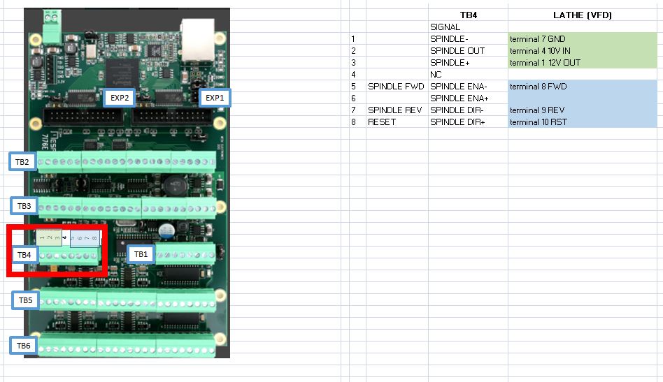

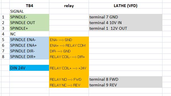

looks like I need a relay for the spindle, yippie
ENA- ---> GND
ENA+ ---> RELAY COM
RELAY NO ---> FWD
RELAY NC ---> REV
RELAY COIL+ ---> +24V
RELAY COIL- ---> DIR+
DIR- ---> GND
ENA- ---> GND
ENA+ ---> RELAY COM
RELAY NO ---> FWD
RELAY NC ---> REV
DIR- ---> GND

revised again. as far as my ME background circuit reading tells me, the VFD wants its logic ground as the signal for direction so I have this thought to use two relays. Can the 7i76e be used to act as a relay for an external signal ground? If not I will have to use relays. This assumes it picks the direction (fires direction relay) before it enables the spindle.
- Posts: 18122
- Thank you received: 5337
18 Jul 2016 12:04 - 18 Jul 2016 12:05 #77601
Replied by PCW on topic Emcoturn 120 lathe retrofit
The 7I76E spindle enable and direction outputs are uncommitted OPTO outputs
so can replace a relay up to their current and voltage limits so normally no
relays are needed unless the drive cannot be programmed for ENA+DIR
vs FWD+REV mode
vs FWD+REV mode
Last edit: 18 Jul 2016 12:05 by PCW.

the drive has no enable. it only has fwd and rev that use the VFD logic ground. Can I use the 7i76e to switch the ground signal? Then I guess I dont need the enable signal at all?
- Posts: 19908
- Thank you received: 4659
20 Jul 2016 03:58 #77685
Yes, I think you can probably just ignore the 7i76 enable output.
Do you need to be able to run the spindle backwards?
What does the VFD do if you activate (using wires) both FWD and REV inputs?
Replied by andypugh on topic Emcoturn 120 lathe retrofit
- Posts: 18122
20 Jul 2016 08:38 #77713
Since FOR and REV need to be grounded, one way to do this is to switch a SPDT relay with the DIR output,
connect the relay common to ENA+ ground ENA- and connect the relay NO and NC pins to FWD and REV
- Posts: 19908
20 Jul 2016 08:44 #77716
I think I might be tempted to wire ENA+ to FWD, ENA- to GND, DIR+ to REV and DIR- to GND, then see what happens.
It should work normally for Forwards spindle, and will either error in reverse, or just work. It depends on the internal VFD logic when both FWD and REV are true
- LutzTD
- Posts: 216
20 Jul 2016 13:37 #77731
by LutzTD
Replied by LutzTD on topic Emcoturn 120 lathe retrofit
pretty sure I saw in the manual if both a grounded it does not turn. I would need reverse for boring ops to keep the cutter on the same side of the tool holder and for tapping, so I would like to keep that option open. I dont mind having 1 or 2 relays, no issue either way, I have some on order so it will just effect my spare count.
