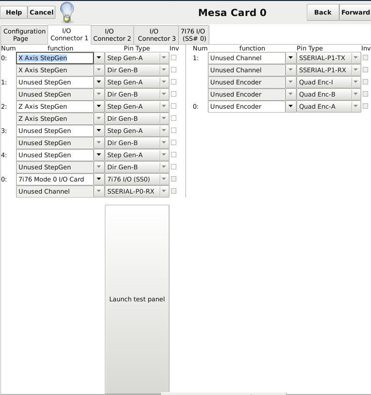

The 7i76 GPIO pins are listed on the 7i76 tab. (the last one).
The other tabs are (effectively) the parallel port pins. These are the step generators and smart-serial extension.

ok thanx, thats why it seemed like there were too many

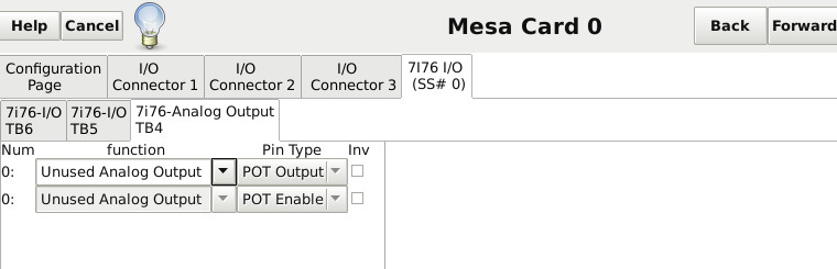

screen 4 7i76e tb4
analog output
seems like it doesn't have enough pins, the plug has 8 pins. how do these match up, do I need to add the other pins in somehow or is it a manual edit in the file later? tb4 connector has the vfd control
also all of the stepper motors connections are on tb2 and tb3 but there is no tb2 or 3 tab. spindle encoder is on tb3 as well.
analog output

The PnCConf "Pins" are HAL pins, there is not necessarily a 1:1 correspondence with physical terminals on the 7i76 board.
So , there are 3 physical pins for the analogue output (+, - and out) but only one HAL pin, and 2 physical pins but only one HAL pin for enable-out and dir-out.
In the case of the analogue output tab, all you can actually so is set it to "unused" or "spindle" so there isn't really much of a decision to be made.

dont really understand this yet but moving on. One good thing is the HAL file generated works fine with the Ethernet mesa 7i76e by only changing the ip address in the HAL file to 10.10.10.10

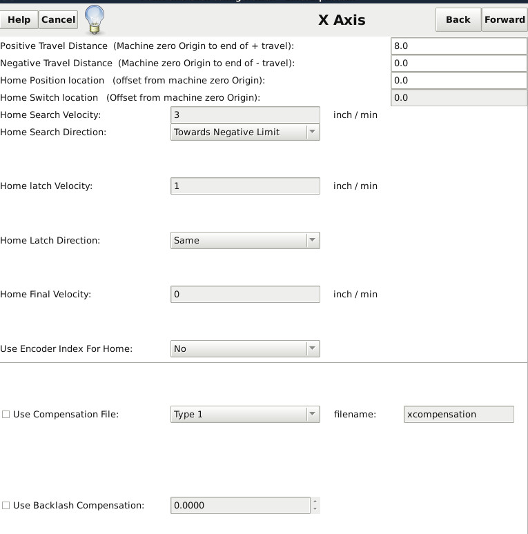

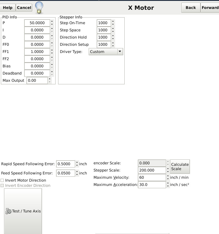

next page is screen 5
I only changed the stepper scale (guess for now)

Set the P-gain to 1000.
In later versions the PID values are not alterable, but the P-Gain is fortunately set to the right value.
