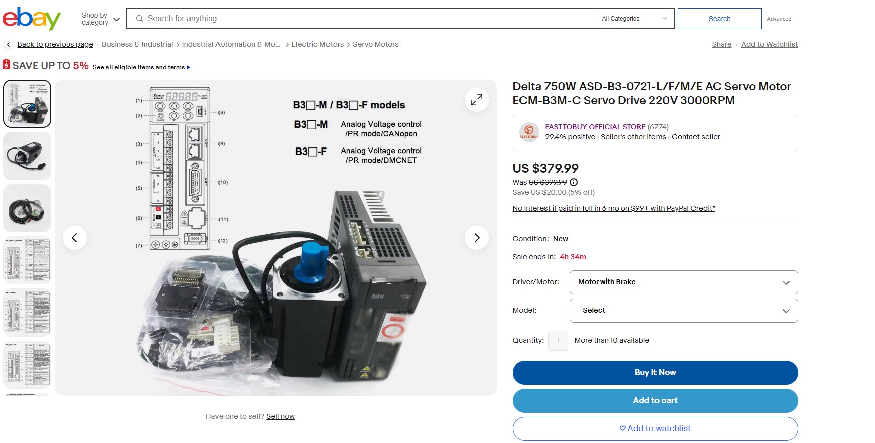

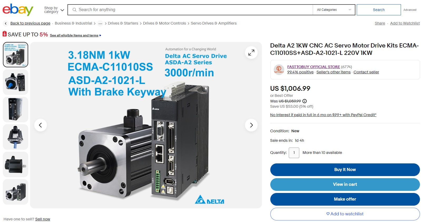

Thanks a lot for your reply, ihavenofish.
For servos, I sent a mail to a man who managed to use the stock servos, and he said me that there two kinds of driver card for the TC-225. The good one, and the other...
Anyway, I must admit than I would prefer to change them with new ones, and sell them as used OEM parts, which could pay new chinese Delta ones.
I had a look, serveral weeks ago, about the kind of servos I could use, and I found that ones. (pictures)
1kw for Z, and 750w for X and Y. It maybe overkill for this machine, but 400w ones are a bit more expensive.
20 bit absolute encoders, with breaks, pulse-dir command, 220V for each one (I would connect each one on each phase. I've got 380 tri in my barn).
Do you see something wrong with these ones ?
Last edit: 02 Jan 2024 20:17 by BerTiN.
02 Jan 2024 20:30 #289596 by ihavenofish
Replied by ihavenofish on topic Brother TC-225 / TC-229 adventure!
I would stick with B3 for all 3 axes for simplicity, but that's the right type of motors. You will need new mounts and couplings.
Interesting about the good vs bad drive versions. Mine was a "first gen" 225. There was a later version than mine with a slightly different casting. Maybe it has a drive update.
02 Jan 2024 20:51 - 02 Jan 2024 20:56 #289598 by besriworld
Replied by besriworld on topic Brother TC-225 / TC-229 adventure!
If you have three-phase 380-400V. You must connect the drivers in one phase otherwise you will burn the driver.
I shopped at this store a long time ago.You can contact them directly and request a special offer for three sets.

02 Jan 2024 20:57 #289602 by ihavenofish
The brother is 3x200-250. It has a multi tap transformer built in but depending where the machine was "sold" it may ALSO already have a 380=240 step down. If not, you need an external 7-9kva transformer to go from 380 to 240.
The delta drives come in single and 3 phase models. You can technically use either with the right wiring.
02 Jan 2024 21:19 #289608 by ihavenofish
Now I'm trying to remember things haha.
380 to neutral is is 220v on a wye transformer. So potentially they are correct using 1 of each line to each drive, although the do not need to do that unless the mains is so weak it unbalances it. 1 hot and 1 neutral would feed all the single phase components. Still in my opinion better to get an external 3 phase transformer though.
#notelectricaladvice :P

04 Jan 2024 18:34 #289802 by BerTiN
Replied by BerTiN on topic Brother TC-225 / TC-229 adventure!
Haha, you're right finally.
phase + neutre = 220v.
The weird thing is that in the first transformer's inputs, neutral is not connected, only three phases, but I haven't prospect farther, yet.

22 Jul 2024 20:25 #305873 by Philip Lydin
Replied by Philip Lydin on topic Brother TC-225 / TC-229 adventure!
Its a three phase transformer its for the versions that run on 380/400v since the spindle drive use 220 three phase power i think. And three phase doesnt need neutral to work its the phases that have 380V between them
