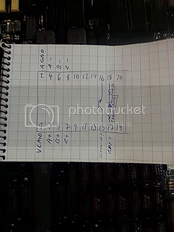

1 analogue +- 10v
2 analogue ground
15 enable + (24v)
16 enable - (24v)
17 + 24V
thats what you need to add. switch on 15/16 after power up.

No, I don't have a mesa board. I want to make control on a Chinese controller with the ability to control a servo driver via analog + -10 volts. But this is not accurate, maybe I'll change my mind on linuxcnc and mesa, my first cnc machine is running on it through the lpt board and I have some experience with it, I really like linuxcnc. You can draw a wiring diagram, with comments on what to connect to. I will then post a full report on this topic on how to check this engine and how to connect it to 220v one phase. I think this will be useful to many more, since there is too little information for beginners

Short 15/16, the green diode on the board lit up and the motor went into hold mode after applying 4 volts to pins 1 and 2. The engine accelerated at a breakneck speed, well it didn't fly away. Thank you for help! The seller sent again from Siberia braking resistors from this servo driver do they need to be connected to the large connectors 1 and 2? And another question for what is the 17 pin in cn2 and where to connect it?

yay. so, single phase works.
my understanding is you need to derate the motor to 2/3 current on single phase.
for the resistors, im not sure where they connect. it will be 2 pins, cause its DC. on my rs1 drives they are labels RB1 and RB2. i guess it cant be that easy eh

on the tc229 drives they were lableled COM (dc -/0) and Y.

In the future I will buy a three-phase transformer, now it was only necessary to make sure that the motor was working. Therefore, I will definitely not reduce the power)) the braking resistor is connected to terminals 1 and 2 there are no more places here)) now I will decide how to control my machine, most likely I will choose linuxcnc and mesa board. And what about the 17th pin, what is it responsible for and where do you need to connect it?

its labelled as 24v. so it would connect to your 24v psu...
but i actually don't remember now though with mine. cause all that connector went to the mesa, and, i don't remember connecting anything outside the abz +- / analogue +- / and enable +-
