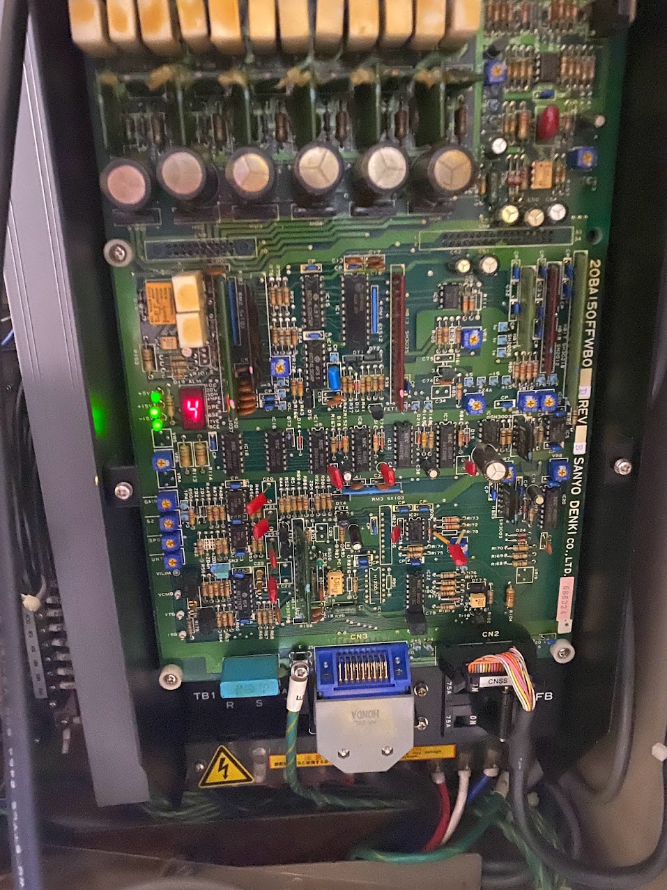

Hi guys,
After digging into this topic, I've tried to start 20BA150 (that is spindle drive and motor for Brother TC CNC machine)
Just for test that everything is clear how to use it, I connect 15+16 together and then apply 3V (from CR batt) between 1 and 2.
But "4" starts lightning after "enable" connection (15+16) and one LED that as I understand displays that drive is enabled (it goes off after disconnect 15/16) but "4" holds till power on
So, nothing going with the motor - it is not on hold and can be turned by hand (and I can see the encoder's value captured by 7i77)
Looks like this "4" is some error code. somewhere here I saw that this is some power issues, but I've checked twice the 3phase voltage and it's ok.
In case somebody knows how to investigate something - let me know.
Also is it not clear why I need to connect +24V and GND from 7i77 or this is not mandatory?
Thanks,
Anatolii.

22 Apr 2022 17:18 #240897
by ihavenofish
Replied by ihavenofish on topic Brother TC-225 / TC-229 adventure!
Power up has to be timed correctly. You'll have to dig back in the thread, but my memory says you need control voltage first, then main power voltage. just a few MS apart.

22 Apr 2022 17:45 #240900
by bioname
Replied by bioname on topic Brother TC-225 / TC-229 adventure!
thanks @ihavenofish !
at power on, only 3 LEDs say that internal voltages is ok, and "4" is off at start.
I've tried multiple times, and hope the time before connecting 15+16 was enought (>10sec, >30sec, >1min, any)
in case if 15/16 is connected before poweron - "4" begin to light at start.

22 Apr 2022 17:47 #240901
by ihavenofish
enable. right. hmm. thats in the timing as well.
cant remember anything anymore haha. so long ago. but there is absolutely a very fussy timing.
