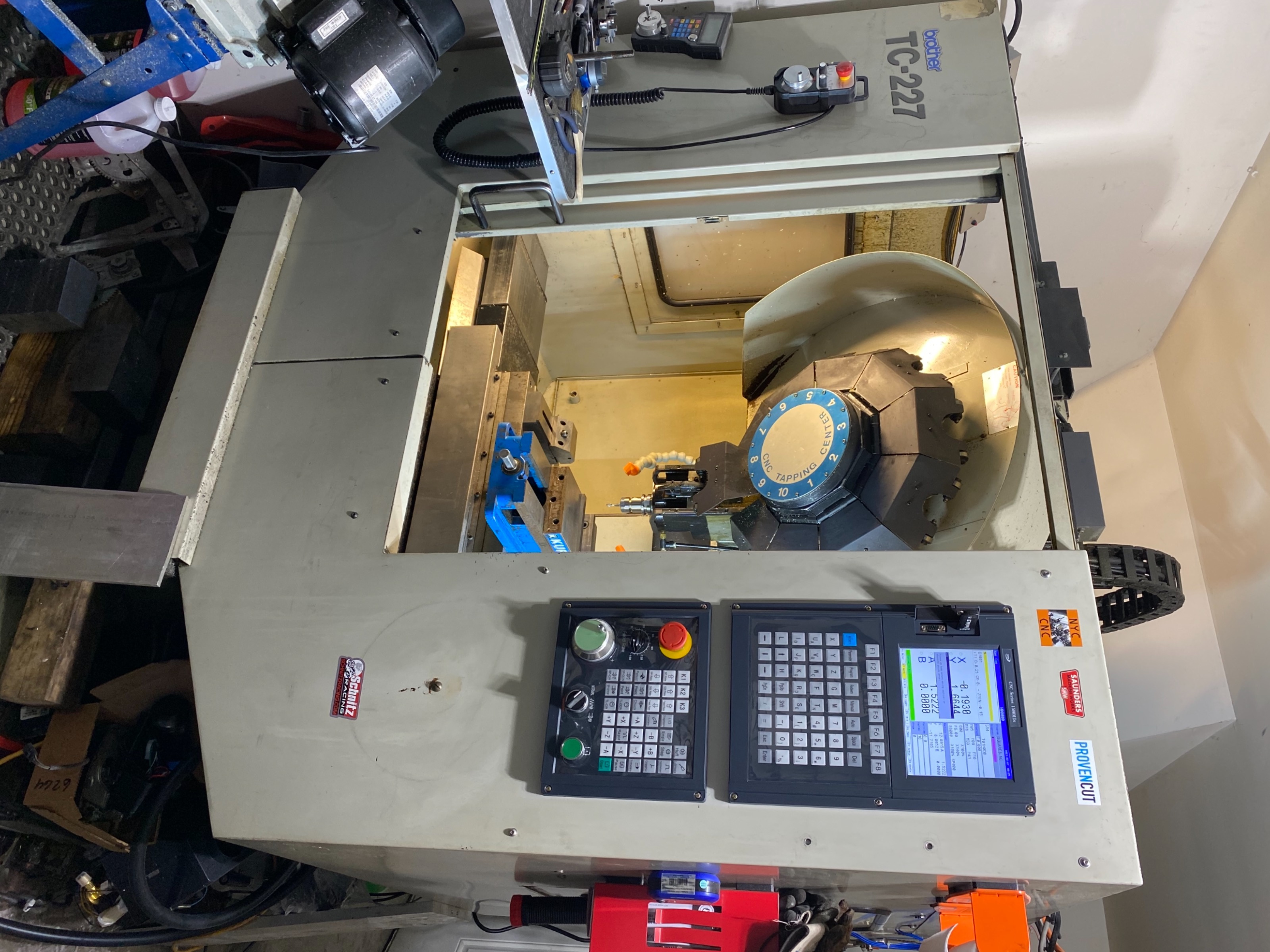

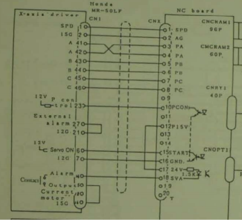

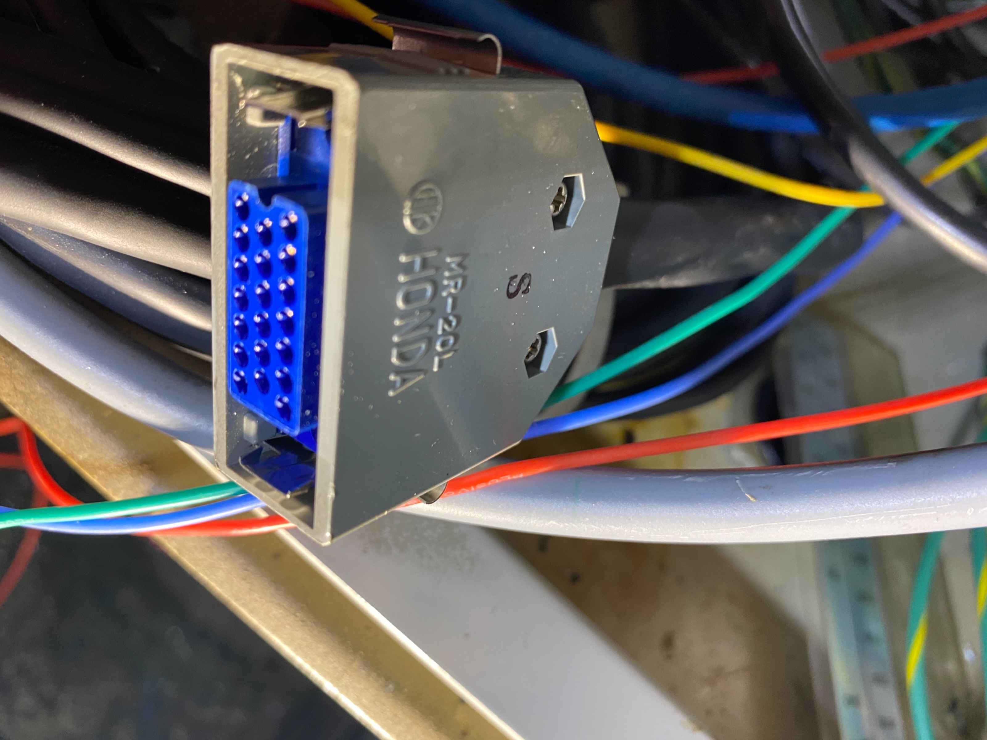

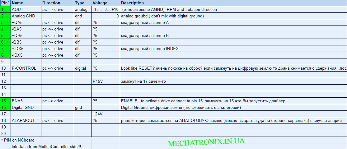

Hello! I have Brother tc-227 that I’ve been converting. Running dyn4 servos and drives on xyz and also installing a Delta C2000 drive for the original spindle motor. Also running a SZGH 5 axis controller on it. Does anyone have the pin outs on the CN2 20 pin connector that goes from the spindle motor to the main original Sanyo drive? With replacing the old drive I need the encoder pin outs to hook up to the Delta drive with the encoder card. Thanks!
Have a pic of it attached.

Hello I have a tc 215 I'm trying to retrofit and I was wandering if you have the pin out for the ra12m drives. They still work as do my servos. Can't seem to find info anywhere thanks dave
