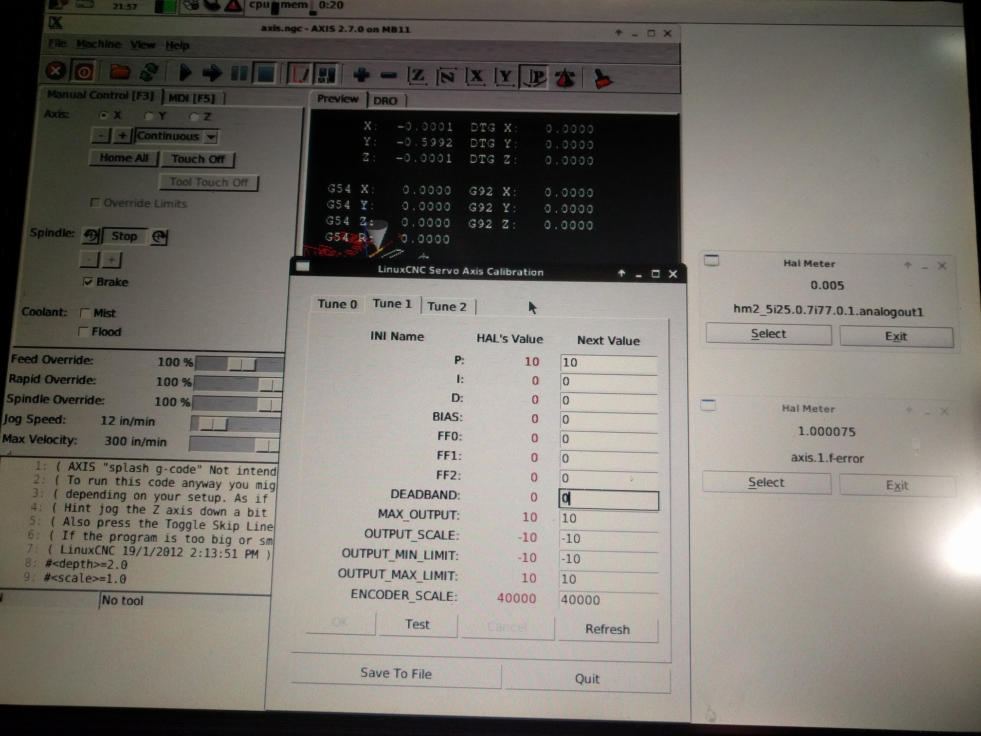

12 Aug 2017 02:39 #97353
by adamj12b
Replied by adamj12b on topic Fryer MB-11 Bed Mill Retrofit
Tonight I did some testing while talking to PCW on IRC. He suggested there might be a wiring issue, but I seem to have found something strange.
PCW suggested set all gains to 0 and set P to 10. He said also set both errors to 2.
While watching axis.1.f-error and the analogout1, the max output at a 1" error is 0.005V... 5mV!! For every digit I add to the gain, 10, 100, 1000, 10000, the output increases by the same. 0.005, 0.05, 0.5, 5.0. Using this, I found that P = 20000 creates a 10V output. However, this also makes the loop super sensitive. Something like 0.0006" error will create a 10V output.
I tried adjusting all the scale and min/max outputs but nothing would change the output.
Here are the settings the tests were performed at.

OUTPUT_MAX_LIMIT = 10.0Please Log in or Create an account to join the conversation.

12 Aug 2017 14:52 #97381
Replied by andypugh on topic Fryer MB-11 Bed Mill Retrofit
Aha, that's a PnCConf bug i thought it had been fixed.
setp pid.x.maxerror .0005
setp pid.y.maxerror .0005
setp pid.z.maxerror .0005
Delete those lines, or make the value 0.

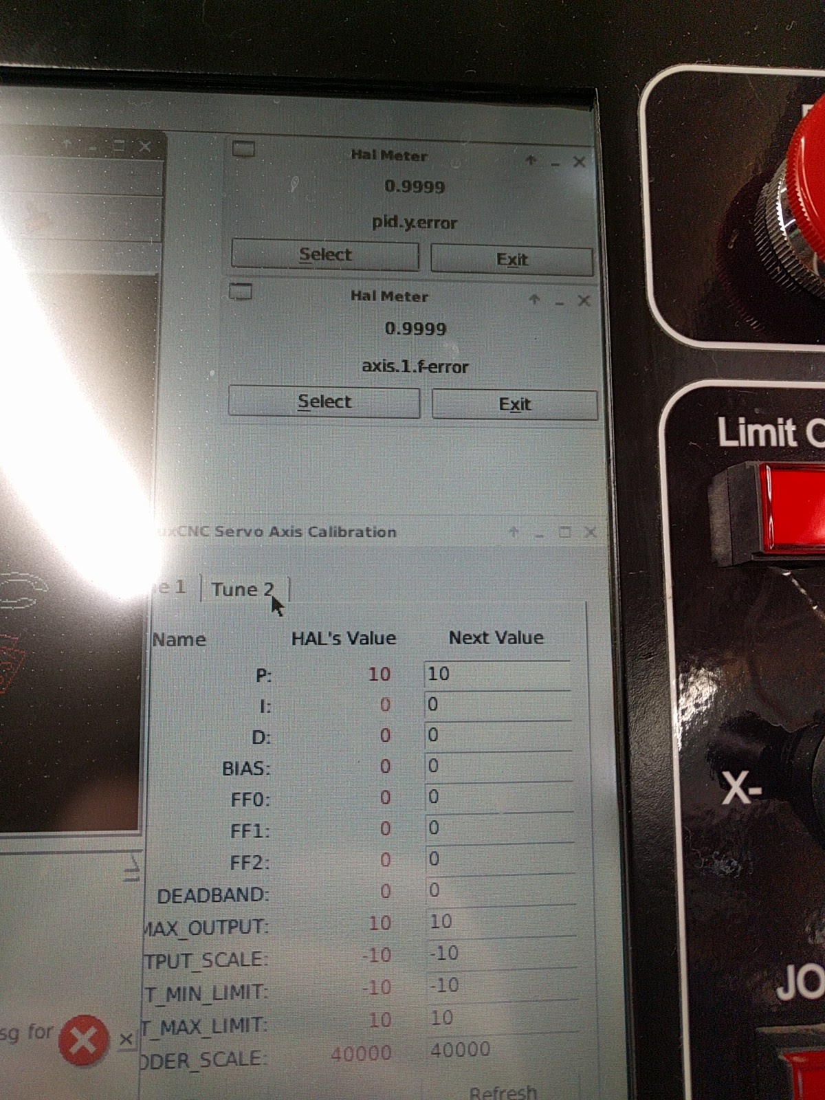

- adamj12b
- Posts: 45
- Thank you received: 5
12 Aug 2017 15:04 - 12 Aug 2017 15:05 #97382
by adamj12b
Well that definitely made a difference.
Now an f-error of 1 will yelid a 10v output.
P=10
Everything else 0.
F-error = 0.9995
Analogout1 = 9.995
Now I should be able to follow the tuning procedure mentioned before?
P=10
Everything else 0.
F-error = 0.9995
Analogout1 = 9.995
