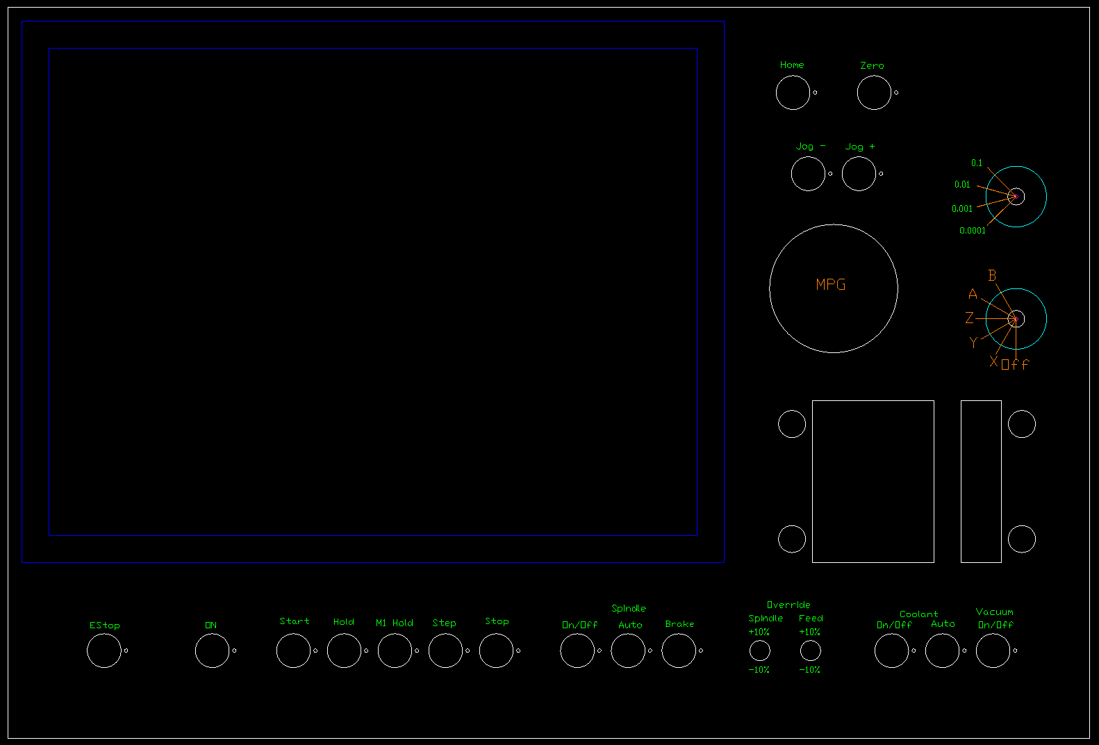

I quite like three-position rotary switches for things with an Off-Auto-On behaviour.
- DeckelHead

Thanks, Andy... I'll give that some thought. Obviously there is a concrete assignment of an intent with a physical switch which I should consider. I opted for the ephemeral approach of using pushbuttons because it allows the control to reset to a consistent state when it powers on, and I can make judicious use of lighted buttons. This is how the Hurco was setup and I liked that. However, I have to be honest... I really didn't consider using a 3 position switch, and I can see the use. If I go that route, I'll likely add an LED above/near the switch to indicate 'AUTO' though.
Thanks for the suggestion/feedback.
Alan
Alan

Alan,
I like the copy/paste of the rotary switchs
Feedhold and M1 op stop are basically pauses. linuxcnc.org/docs/html/gcode/m-code.html#mcode:m0-m1
I wanted a button to turn M1 on/off.
I like the touchscreen much better then a house. Im currently using a wireless keyboard with trackpad and hate it...
For the jog increment, My machine has 0.0001 = 0.010" per rev, 0.001 = 0.100" per rev and 0.010 = 1.000" per rev, as these are directly related to the numbers on the MPG.
What screen GUI are you planing on using?

LOL... Yeah, I unabashedly admit that I have both hijacked your thread and your switch drawings.
I'll visit the M1 op stop, feed, pause issue. Thanks for the link.
I understand the jog increment thing. Units of 10 definitely make a lot more sense; to that end, 0.0001, 0.001, 0.010, 0.1 are pretty much what I would want. Unfortunately, I don't have a 4 position switch, so I expanded to the x5 units too. That is, frankly, probably pretty stupid. What is wagging what? I'm letting the lack of a readily available 4P switch push the design consideration of a console? Duh! What am I thinking!
I'll fix that.
I'm not sure what UI I'll be using on it right now. I was thinking I wanted basic mouse movement to be through the touch panel. But that leaves key input as a problem and I don't have a solution there. I've considered putting a numeric keypad in the console but I'm torn with whether or not that will be sufficient. It would probably be the "safe" thing to do though.... But I can't see a way around a supplemental BT keyboard and mouse for more complex things. Glad you brought up the keyboard thing though... I think that warrants a longer conversation....

Here is another stab at the console. In this one, I have:
My four function keys (not really the right term) would be:
I'm not too sure how feasible this keypad is, however. It is a leftover from the Hurco and is *not* USB; it is a matrix keypad. That means I'll have to (somehow) have LinuxCNC scan the matrix and detect/process the switch closures. Does LinuxCNC have a facility to do this or do you have to write some funky logic ladder type of thing? That would seem a bit strange. Or, can I have the inputs go directly into the Mesa and have Linux construct meaningful keypresses from there? It is the numeric side of the world that I'm not sure about here (0-9). The only other alternative would be to put an Arduino in there so I can get into USB land, but then I'd have to write some driver (?) for LinuxCNC to read the data coming from the USB.
One use case would be: Tool -> 12 -> ENT -> CAL to calibrate tool #12
(edit: MATRIX_KB is a HAL component that will do the keypad scan)
- changed the feed switch to 4-position, all units modules of 10.
- removed the tool INC/DEC switch and Calibrate buttons
- added a cutout for a 0-9, -, (decimal point) keypad and four function keys (ignore the round mounting holes
- Tool
- CAL
- (unknown)
- ENTER

Nor do I. But it's part of all G-code specifications so LinuxCNC needs to support it.
Possibly in production you would use it to pause the first job to test a dimension then disable it for the rest of the batch?
Replied by andypugh on topic Fryer MB-11 Bed Mill Retrofit
I don't quite understand the difference between the M0 and M1 pauses.
I don't get the actual use cases here.
