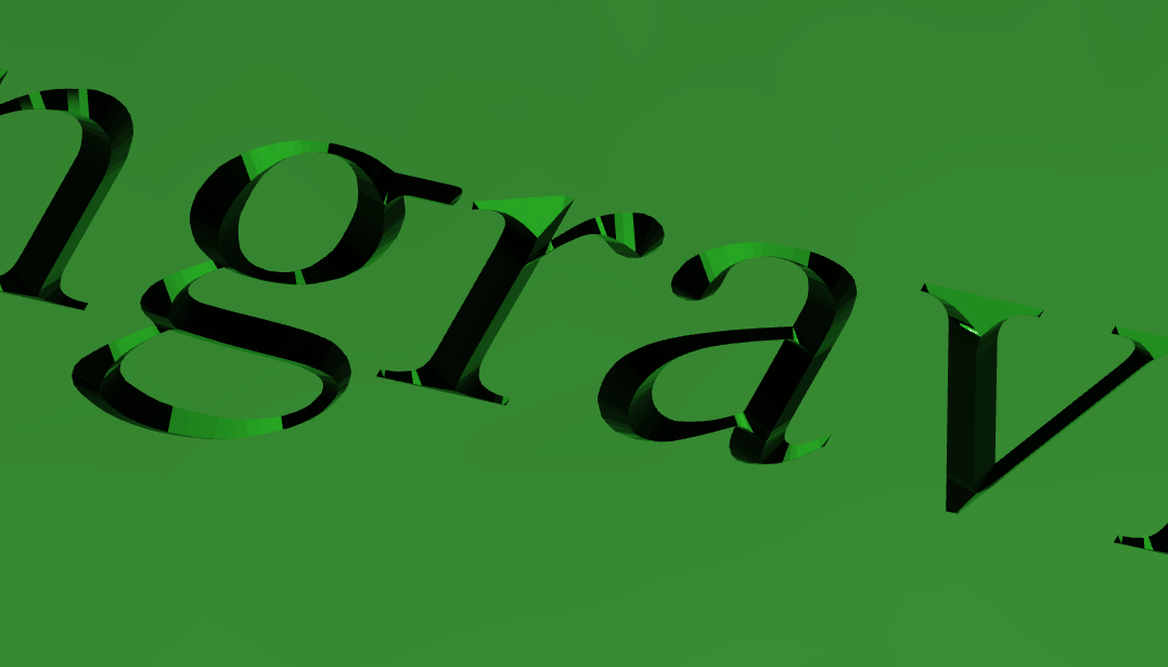

05 Jul 2018 17:46 - 05 Jul 2018 17:48 #113485
by DeckelHead
Replied by DeckelHead on topic Fryer MB-11 Bed Mill Retrofit
Wow. I ran into an unexpected roadblock with my own console.... I'm fairly green with G-code because my Hurco that I migrated to LinuxCNC was all conversational. I decided to learn Fusion 360 because it has a G-code generator built into it. I'm very good with AutoCAD but Fusion makes more sense moving forward with my new capabilities. I stumble with the application, primarily in the constraint area, but I have the panel all modeled now (excepting text). Great! I thought that engraving would be the easy part. Oh, how wrong I was....
I have found that engraving is the single most frustrating thing I've dealt with thus far on the whole conversion. Either I'm totally missing how to do this well in Fusion or the app simply isn't ready for prime time in this narrow area (don't get me wrong... by and large, it is very cool and I'm a huge supporter). I haven't even cut anything yet, but just getting the text in the right place is a major PITA. The app crashes or the tools are primitive. Vector fonts are, well, not really there, that I can see. And even if they were, for the life of me, I can't see how one can reliably places these such that they are centered on a horizonal line, directly above a button. The 'insertion point' simply is the wrong way to place stuff. Oh, how I miss AutoCAD!
Fusion 360 is so poor/frustrating in engraving that I have tried to find other applications. The problem there, however, is that most of the applications are all centered around a rather simplistic concept of a trophy model--one line of text in a single location. I want text in numerous places around the a piece of material.
So, I'm totally frustrated and sitting here trying to figure out how to engrave my panel. It is an odd place to be. I feel like I have this massively capable CNC machine but would be far better off with a manual pantograph right now.... So, this begs the question... Does anyone have any suggestions on how to extricate myself from this mess? Is there a good piece of software that I can use to generate G-code for engraving attractive vector fonts? Ideally, it would be something that would allow me to engrave different strings in multiple places around a piece of material.
Any suggestions are welcome and appreciated.
Alan

05 Jul 2018 18:12 #113487
by adamj12b
Replied by adamj12b on topic Fryer MB-11 Bed Mill Retrofit
Fusions engraving and font stuff has always sucked. Dont let it drive you away though. The pros still outweigh the cons.
That said, to do something like this, I would export the layout of the sketch your trying to have text on to a DXF file. Then import this file into Inkscape or Illustrator and add the text you are looking for there. Once you have it all, do an Object to path to make it all lines, and not text. Do a save as and save it as a SVG (or dxf but I haven't tried this). Import this new file into fusion and align it with your other work. BAM back to where you were. Now you can either extrude the lines or use a 2D trace depending on your font complexity.
This is my plan to do my engraving on the new console.
-Adam
-Adam

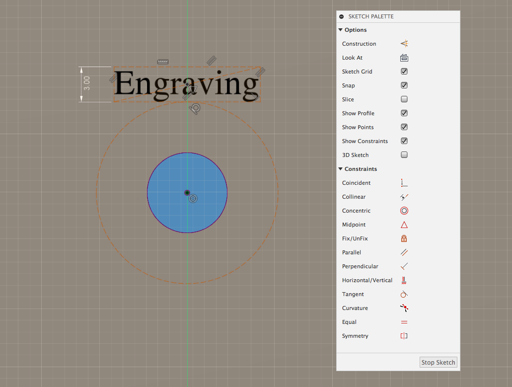

05 Jul 2018 18:21 #113489
I just had a fiddle, and here is an idea that seems to work.
Insert your text, then select "construction geometry" and draw a line from one corner of the text bounding box to the other.
Then sketch->point and put a point snapped to the midpoint of that line.
Then you can dimension and constrain to that point.
Alternatively draw a construction line constrained horizontal and dimensioned from the hole centres, then make the text bounding box bottom line coincident with that line.
Or draw a construction circle concentric with the button hole and make the text bounding box tangent to that circle.
Replied by andypugh on topic Fryer MB-11 Bed Mill Retrofit

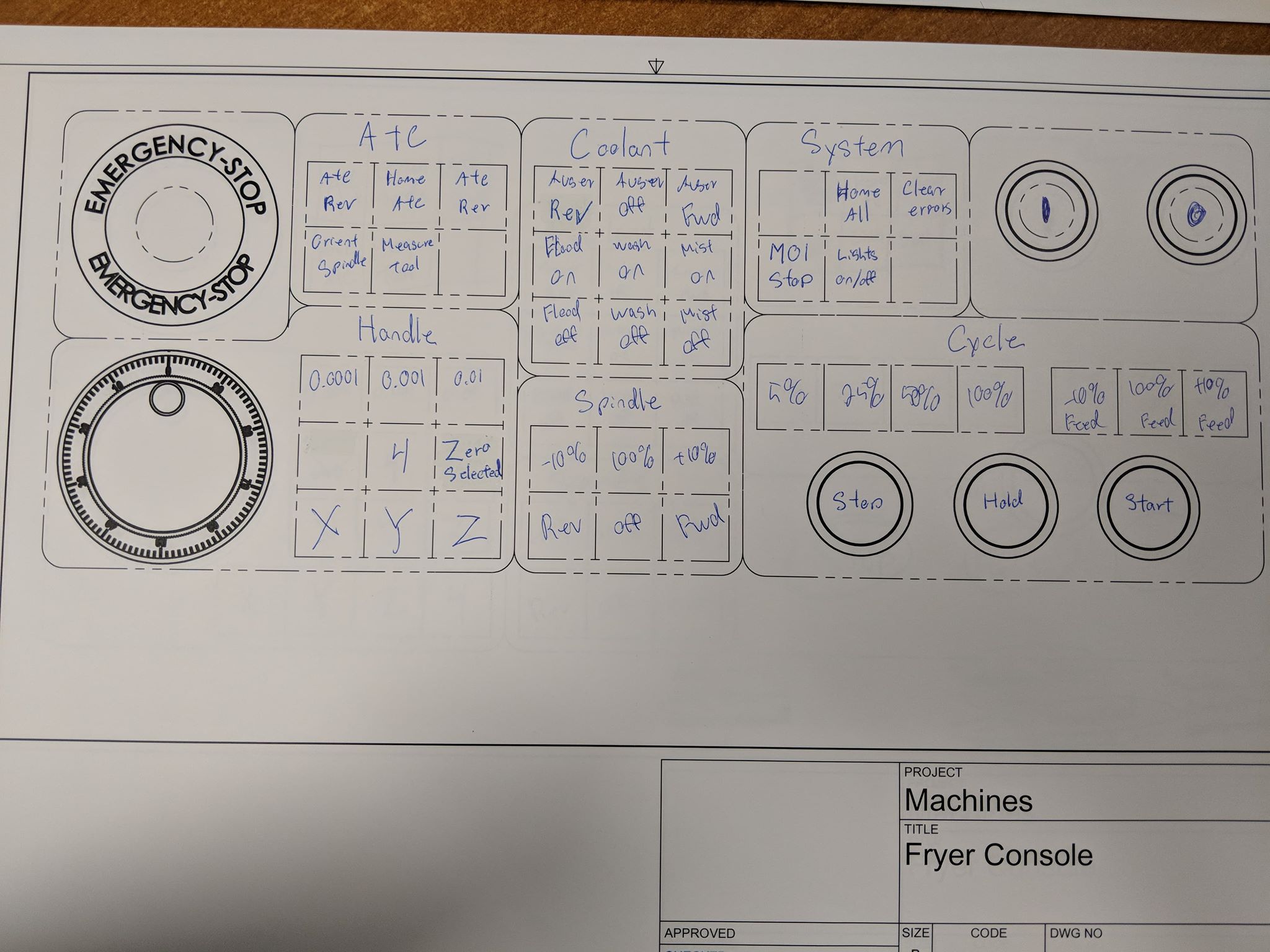

05 Jul 2018 18:25 - 05 Jul 2018 18:47 #113490
by adamj12b
So Im looking for some advice on controlling LED's for my console buttons.
I have a number of buttons that I want to have backlights to indicate what is active, such as jog increment, axis, rapid speed ect.
I need 17 outputs for my new console and the 7i73 has 16.
I am trying to understand how to interface a 74ACT595 shift register with the controls but there is only a little bit of information available. I dont understand how I would command data to the specific bit and then write the whole straight out to the chips...
This is all I could really find: wiki.linuxcnc.org/cgi-bin/wiki.pl?Shift_Register_Port_Expander Which was edited 5 years ago..
Thoughts?
Thoughts?

05 Jul 2018 18:46 #113492
I think that Charlieplexing probably isn't an option with Mesa IO.
If you have a space smart-serial channel then a 7i73 inside the console might be a good choice.
I need 17 outputs for my new console and the 7i72 has 16.
