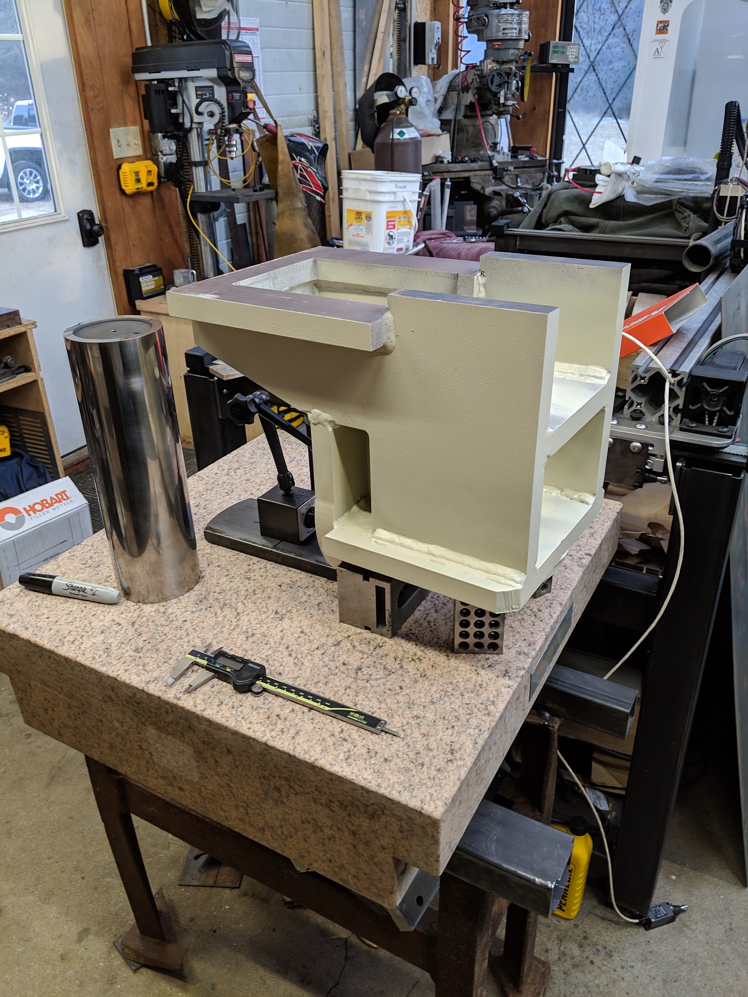

So its been a bit over a year since a major update.

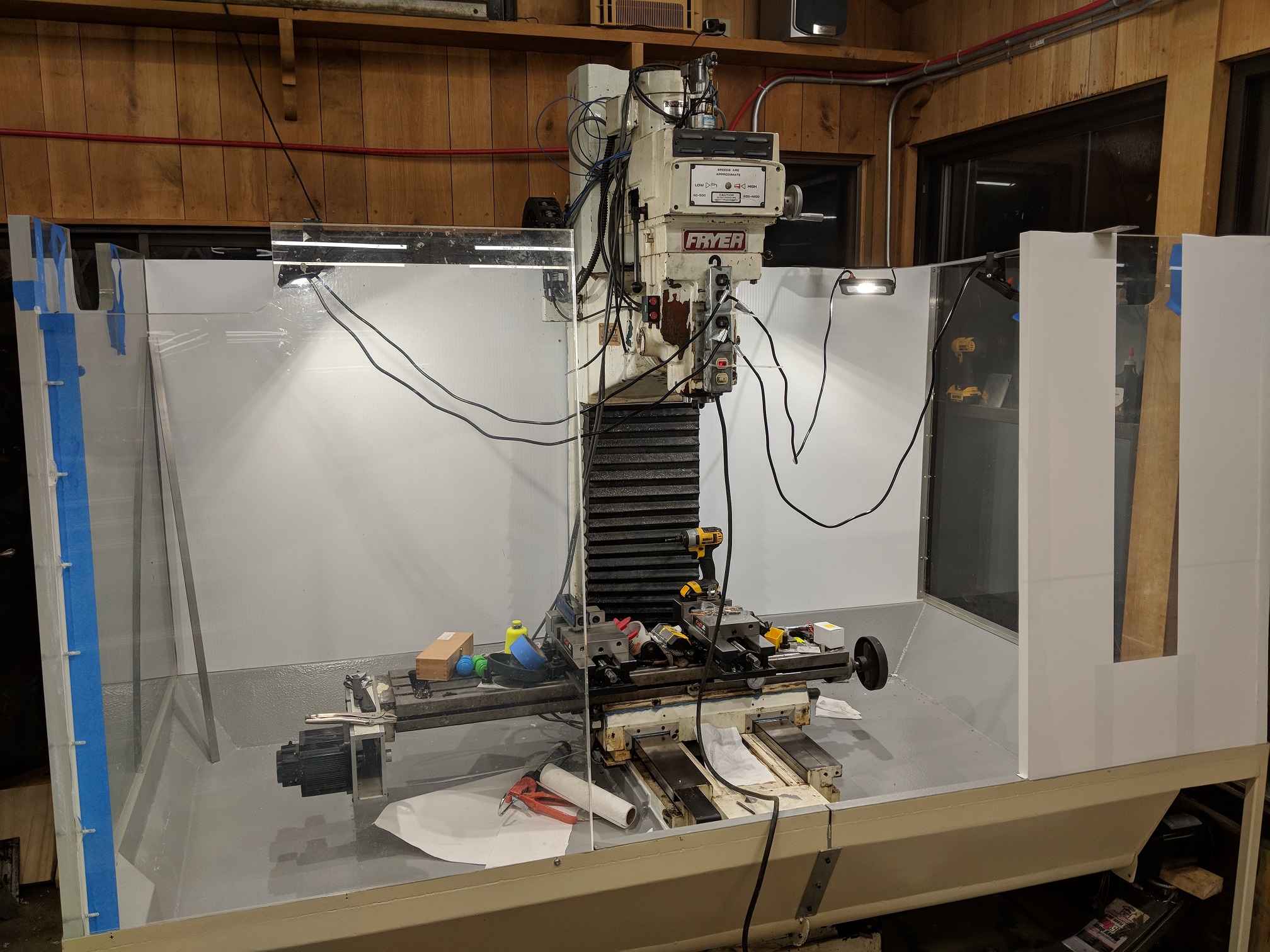

Last year I enclosed the whole machine, building a chip pan out of hot rolled sheet and welding all the seams. This was then painted to match the mill and the inside painted with epoxy. The walls were constructed by 1.25" lexan sheets that were left at my new house by the previous owner(hoarder). They made for one solid enclosure that nothing is going to come through. I was able to get the coolant plumbed and finally had the machine at a working capacity.

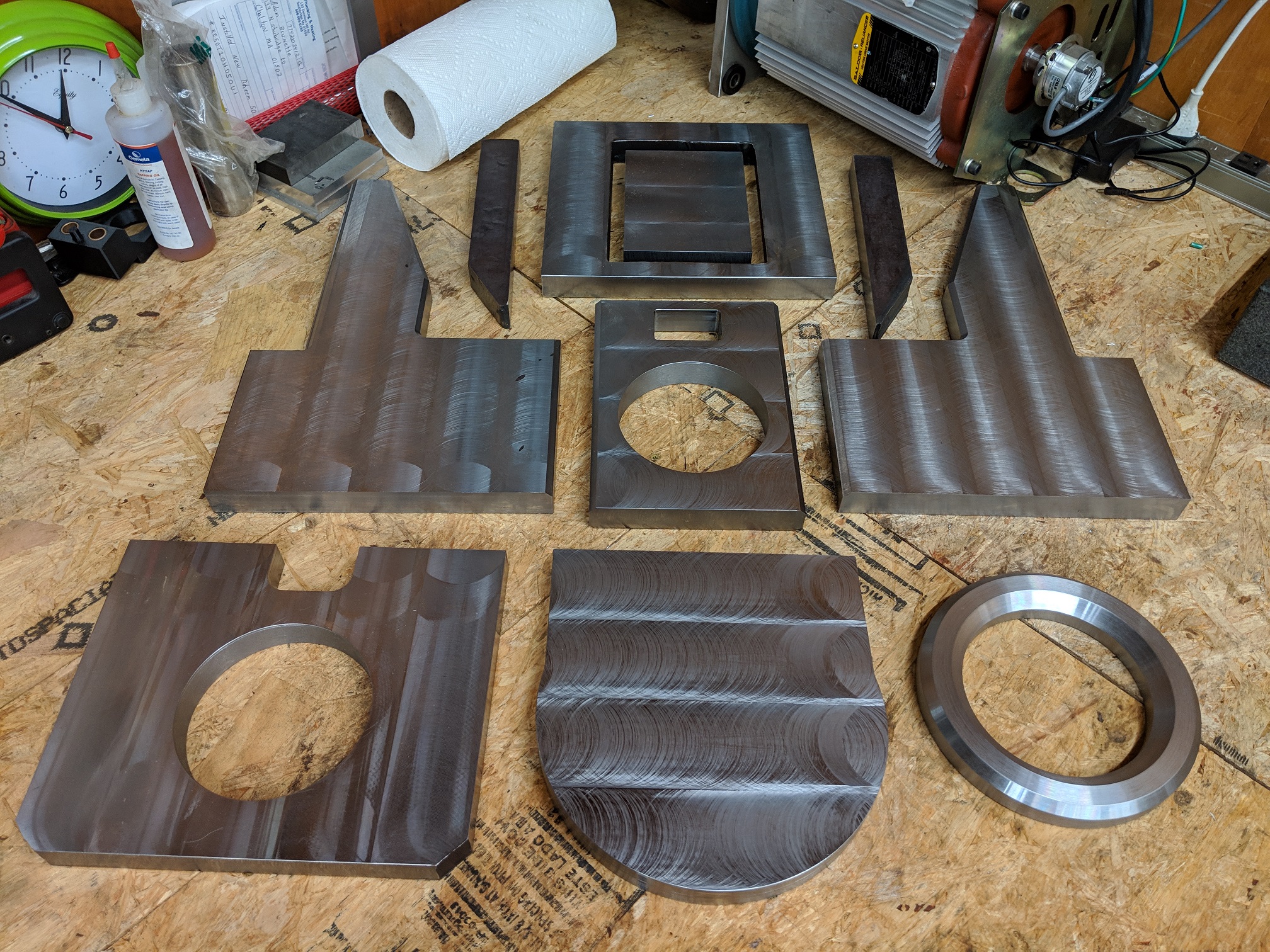

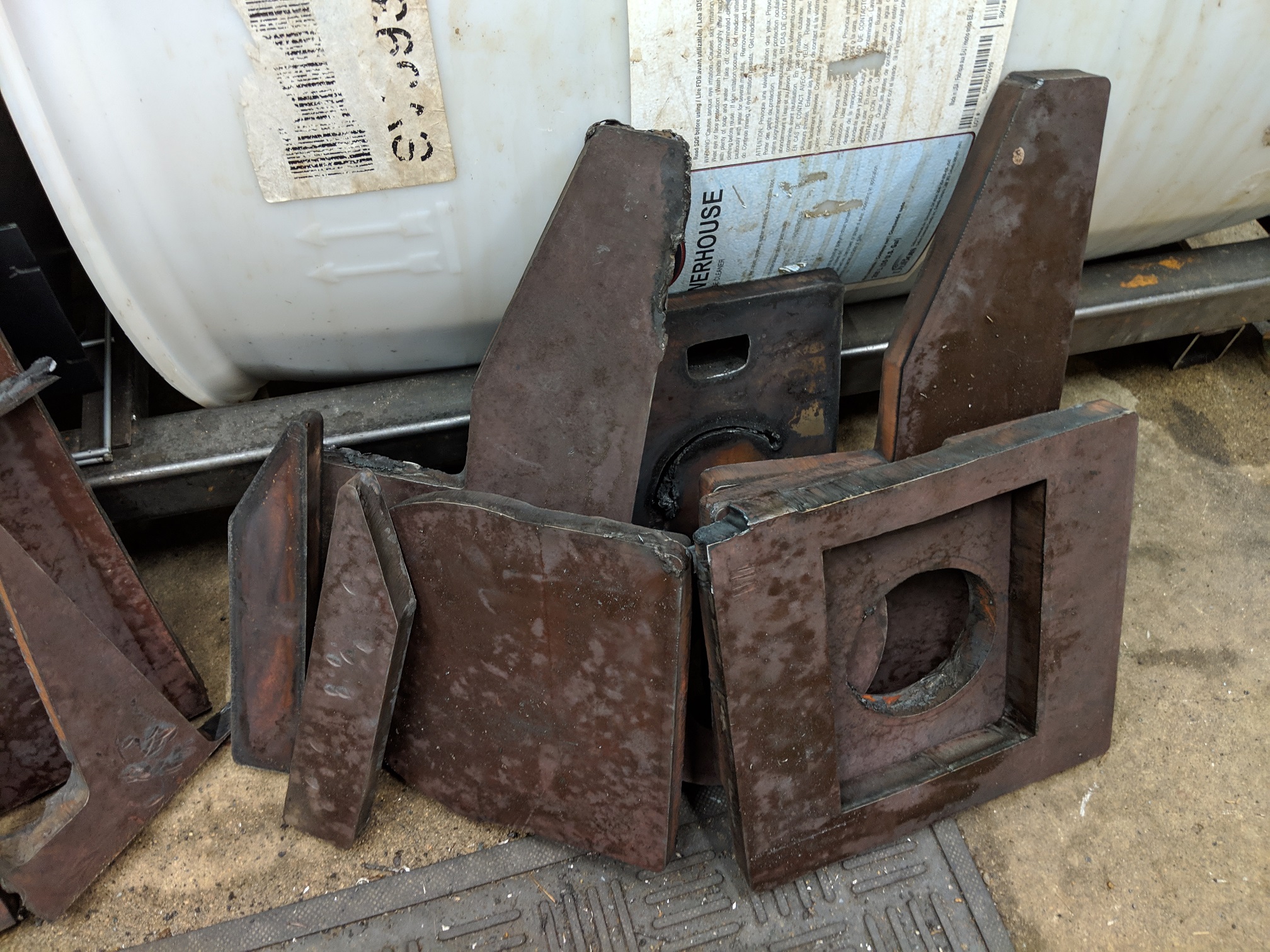

In the winter of 2019, I started work on my biggest single piece yet. I had purchased a Brand new 2017 Haas Mini Mill spindle head. This was the casting, motor, spindle cartridge and tool release piston. I spent considerable time towards the end of 2018 measuring the Fryers existing head assembly and the Haas head, and designed a custom weldment to fabricate a new head for the mill, using the Haas components.

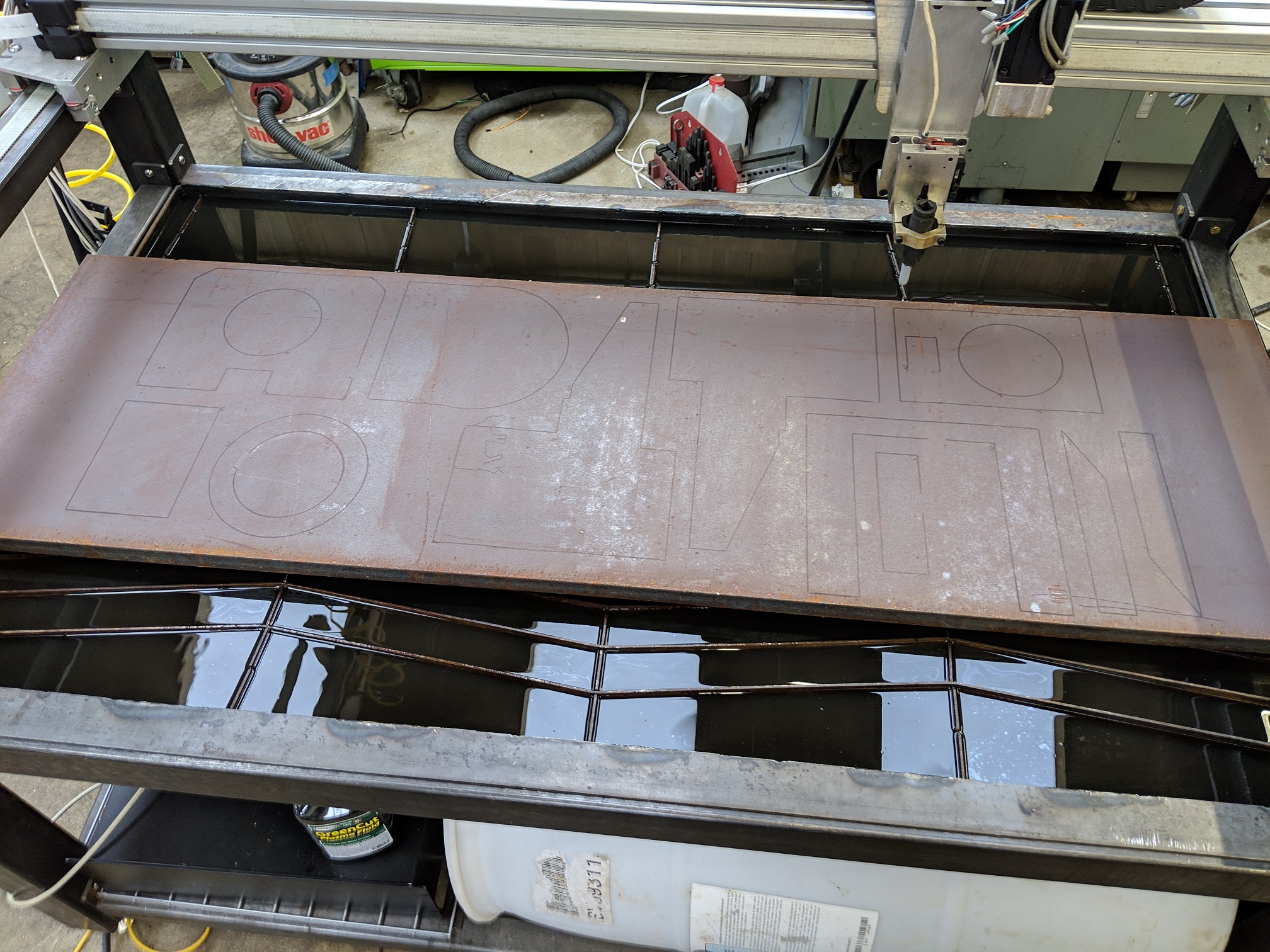

All the pieces of the weldment were cut from 1" A36 steel on the plasma table. In hindsight this was a mistake. Due to the thickness and the 80A plasma unit being under powered for this thickness, I would have been better off having the parts cut on a water jet so the heat effected zone was not so large and the kerf as well... Lesson leaned. I finished machined all the parts and cut bevels on all mating edges to prepare for welding.
Welding was done with a 255A Lincoln Mig machine running Hobart 0.047 Tripple 7 dual shield wire. After this was complete, I sent the weldment to heat treat for stress relieving before final machining.
Once final machining was done, I was able to do a rough assembly and weigh the new assembly and find the difference in weight between the new head and the old one. This machine has a cast iron counter weight in the column for the head. I was unable to remove this for trimming, so I had to add mass to the head itself to balance out. I ended up designing a lead weight that I ended up casting 2 of, to bolt to the sides of the head under the shroud to add the required 40lbs of mass that was needed.

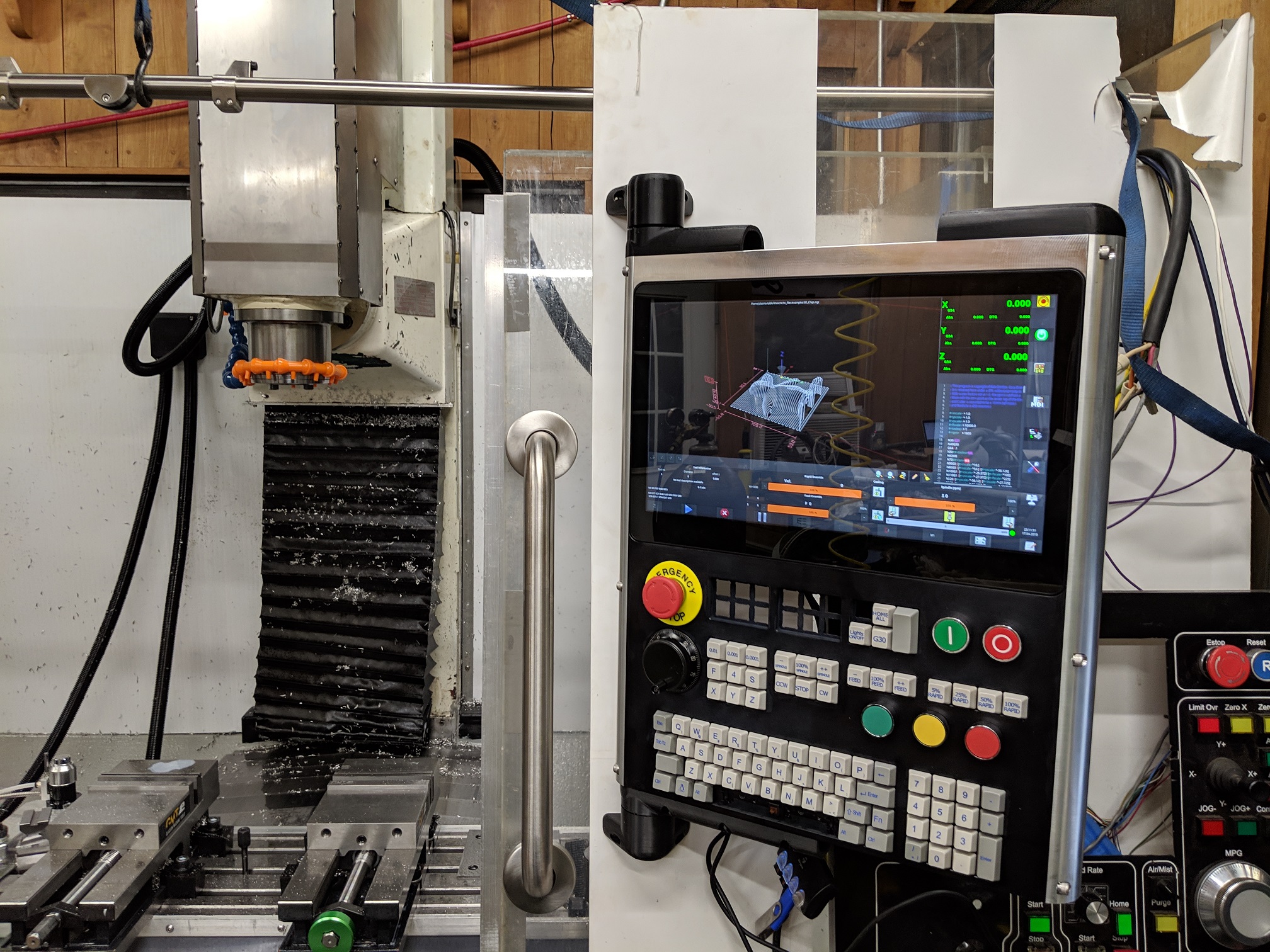

Ive been using the new spindle for 7 months now and am very happy with it. I increased RPM, gained rigid tapping and orientation and ended up with much lower run out and lower running temp.

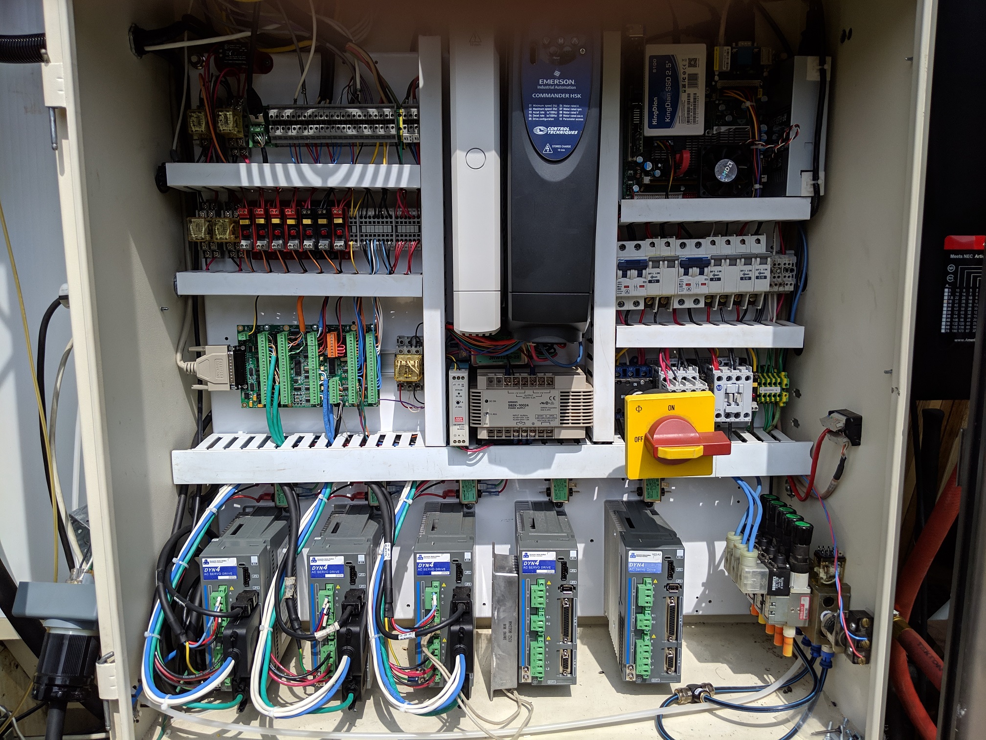

I spent some time this summer adjusting little wiring things and working on my console design. Here are some pics of how the machine sits now.
I have started working on a harmonic 4th axis which I will be adding a perpendicular harmonic drive to to form a trunion for full 5 axis capability. Ill post an update about that soon.
Check out the google album on the first post of this thread for more pictures.
