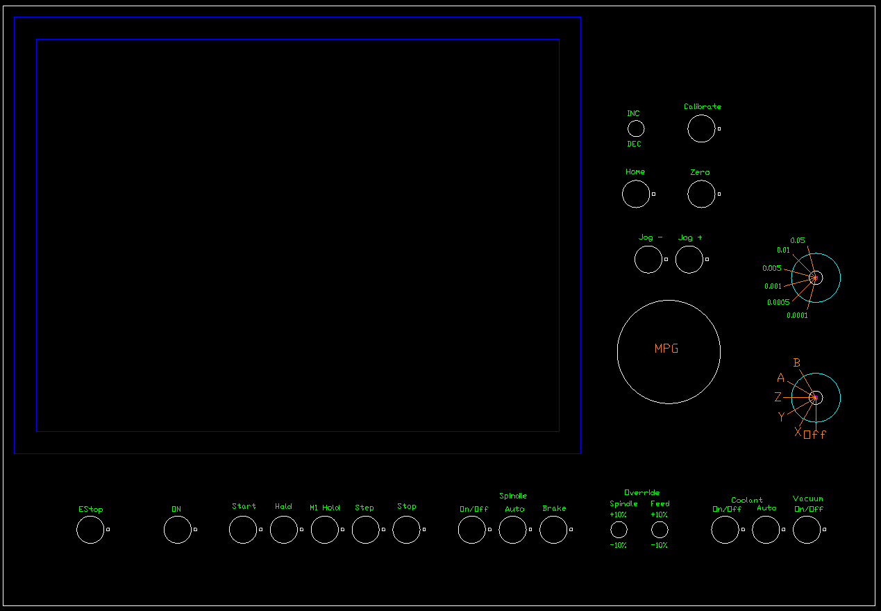

- adamj12b
- Posts: 45
- Thank you received: 5
03 May 2018 16:07 #110125
by adamj12b
Replied by adamj12b on topic Fryer MB-11 Bed Mill Retrofit
Alan,
$100 for a piece of aluminum big enough for the face of the panel??
Youve got me thinking about my console redo with all this talk.
I really like the idea of the selector for axis and the zero button based on that.
I have also been looking into building a custom keypad, and having keyboard keys printed for the functions I wish to have. I cannot find any company that will do one off membrane keypads, but Cherry MX switches arent too expensive.
I think I am going to go for a simpler approach then this one. Right now im still trying to decide if I should leave the current console intact and sell it or reuse the buttons... The little buttons are $27 each to replace.
What gui do you plan to use? Ive always loved the simple approach of haas and fanuc controls with everything being physical buttons. Im now looking at a modified gmoccapy with the touchscreen though...
Im a ways off of doing this as I am currently re-arranging my shop so that I can finish the full enclosure of my machine so I can get flood working.
-Adam
-Adam

10 May 2018 14:40 - 10 May 2018 14:43 #110519
by DeckelHead
Replied by DeckelHead on topic Fryer MB-11 Bed Mill Retrofit
So, given your experiences with your own consoles (and noting your own wishes for changes to buttons/layout), I thought I'd pass by what I was thinking of. I'd love to hear your comments. The text is for informational purposes only. It would be cleaned up with a different font, location corrected, grouping graphics added, etc. Here are some of the considerations:
That is about it for now... Again, this is a talking point design, not a final product. Your critique is appreciated
- Easy access to Estop
- Ignore the small circles to the right of the switches. Those are placement holes to prevent rotation and are covered by the front of the button bezel
- The inter-button spacing (not grouping) is actually what was on the original Hurco KMB1 console. I think it is probably ideal. The inter-group spacing (1.5" OC) is my own machination
- Console on the right of the machine. I thought it would make everything less obstructed to have the buttons on the right of the display
- Inc/dec, and feed override buttons are up/down spring to center switches that are used instead of a pot (per a comment from Adam, actually, because he had indicated he didn't like his pots)
- Inc/dec refers to a tool ID (which would be on the display). The idea here is to select the appropriate tool to calibrate/zero and then you'd press calibrate. I don't think I've seen this yet so if it isn't possible to/suggested to calibrate tools this way then definitely let me know, please.
- space at top for future buttons or indicators, if required... I can't think of anything else right now
- MPG and jog buttons work, of course, as a function of the two 6 position switches to the right.
- Coolant Auto and Spindle Auto would likely be latching buttons. However, all of the buttons I have contain lights so I can reflect state via illumination easily enough.
- You can kind of get an idea of the grouping via the spacing. Eventually there will be nice borders on the graphics to delineate the groups (and text)
- Concerns: Home and Zero may be too close to one another?
- Home: would home all axis
- Zero: would home the axis selected by the rotary switch... For use with a touch-off probe.
- The blue lines delineate the bezel for the display (which is a touch, although I don't presently know if I'll use that feature)
- I'm not sure of the difference between Hold, M1 Hold. I added these because Adam had them at the start of the thread (sorry, my Hurco didn't use traditional G-Code. Further, I don't know if 'Step' is a capability in LinuxCNC. So, again, comments on these buttons are especially appreciated.
