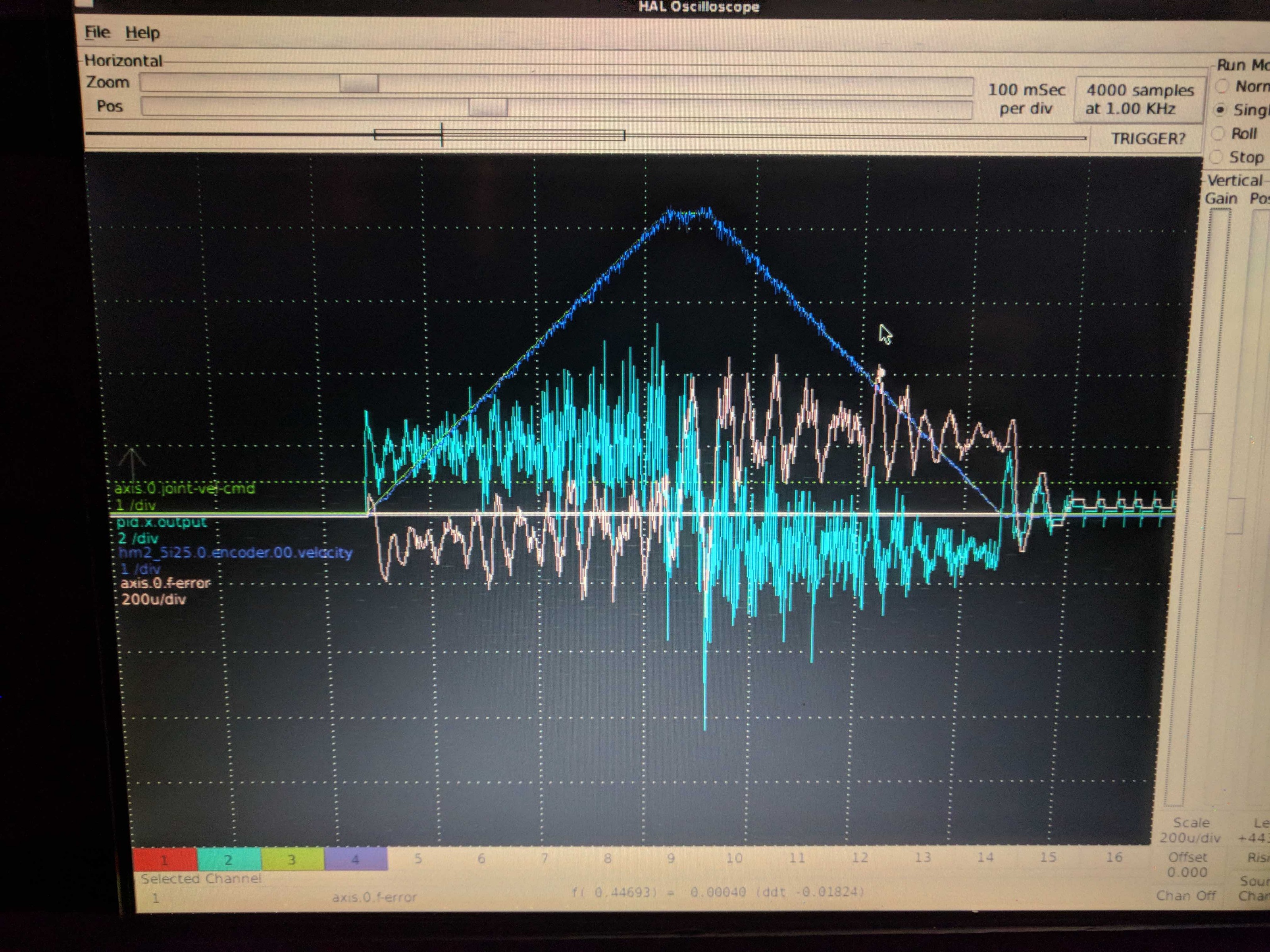

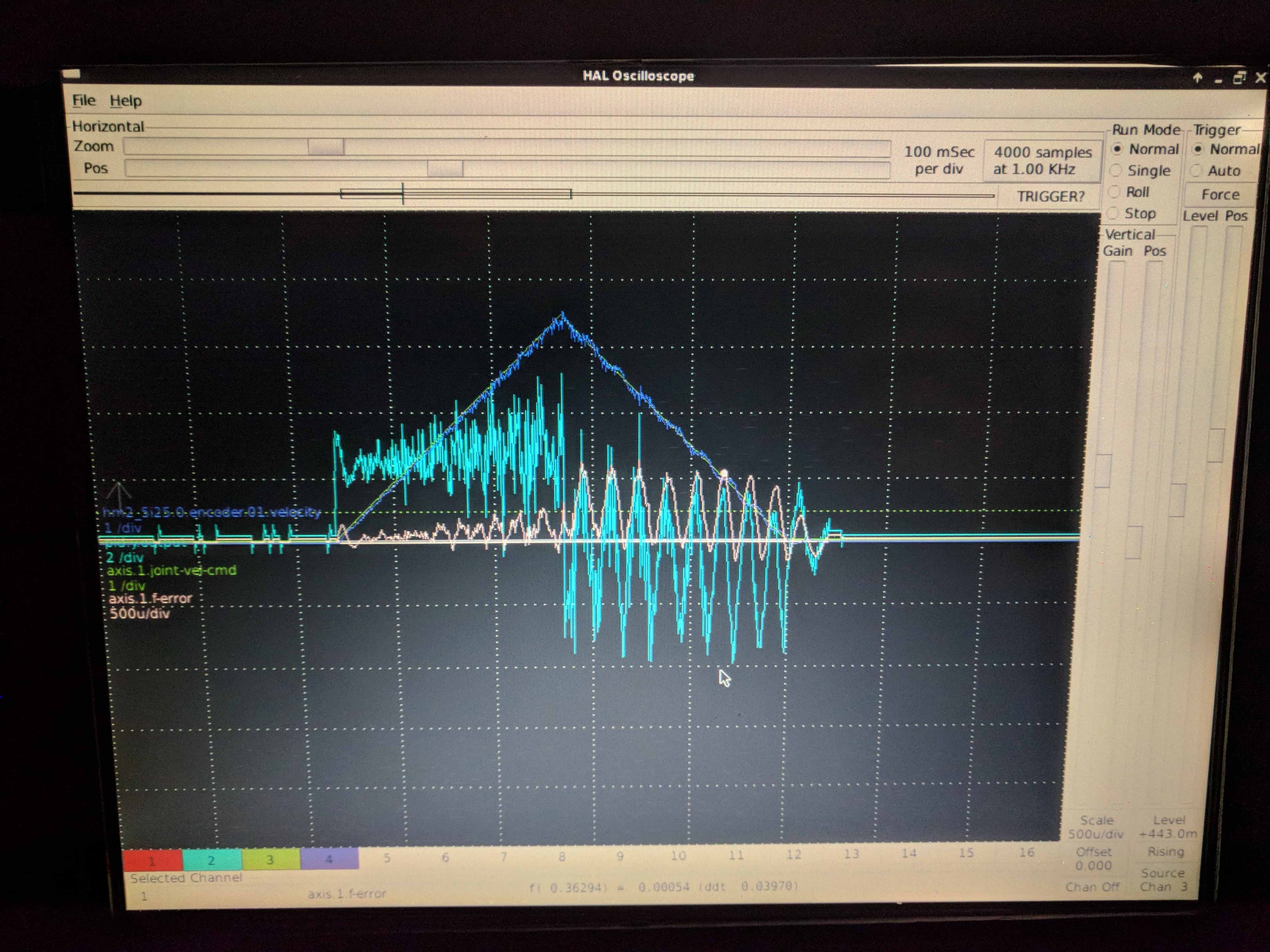

I have been working on getting the servos tuned and could use some advice. I have gotten what I feel is acceptable, but also feel like it could be better.
As a refresher, im using Dmm-Tech Dyn4 drives and 1kw servos on all 3 axis. These are running in torque mode as velocity mode is hopeless and cannot be tuned to be stable....
I have tried PCW's tuning suggestions from earlier on: forum.linuxcnc.org/30-cnc-machines/33016...rofit?start=10#97305 but that doesn't seem to work for me. I cannot increase the servo thread speed as it makes the system unstable and I get watchdog errors.
What I have had moderate success with is increase "P" only till oscillations then back it off a bit. The I add as much "D" as I can and still stay stable, and back it off a bit. Next I adjust FF1 and FF2 to stabilize the error as much as I can.
Well this method can seem to only get me so far. Reading the axis error in hal scope, the Y stays below +/- 0.0006 and the X seems to stay below +/- 0.0005.
I was hoping someone could suggest what speeds I should test the tuning at? Rapid speeds seem to be the most harsh...
Both of the following pictures are rapid jog speed of 258IPM.
Y Axis Hal Scope
X Axis Hal Scope
I have attached the current hal and ini file as well.

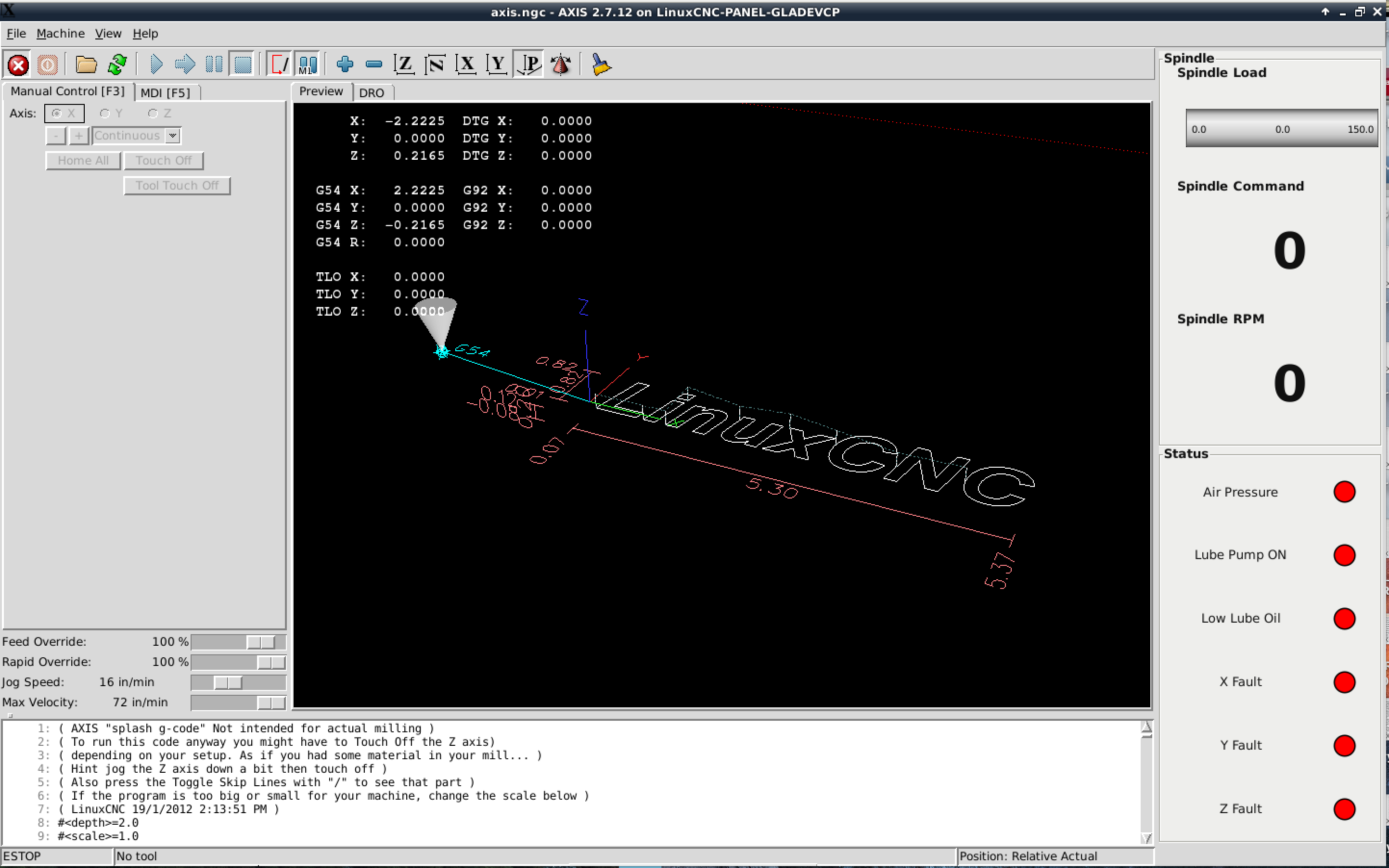

Lastly, I started creating a custom glade site panel to display some machine specific things. I have not linked it yet in hal, but I have the 0-10v output from the VFD going into one of the 7i77 analog inputs and will be displayed on the spindle load meter. The commanded speed comes from halui and the spindle rpm will come from a spindle encoder once I get that installed. Lube pump on is linked to some lube pump delay code to only activate the pump when the machine is moving. It stays running for 1 minute after the machine stops moving. Low Oil and servo faults are just connected to pins on the 7i77.
This is the screen in the simulator on my laptop.

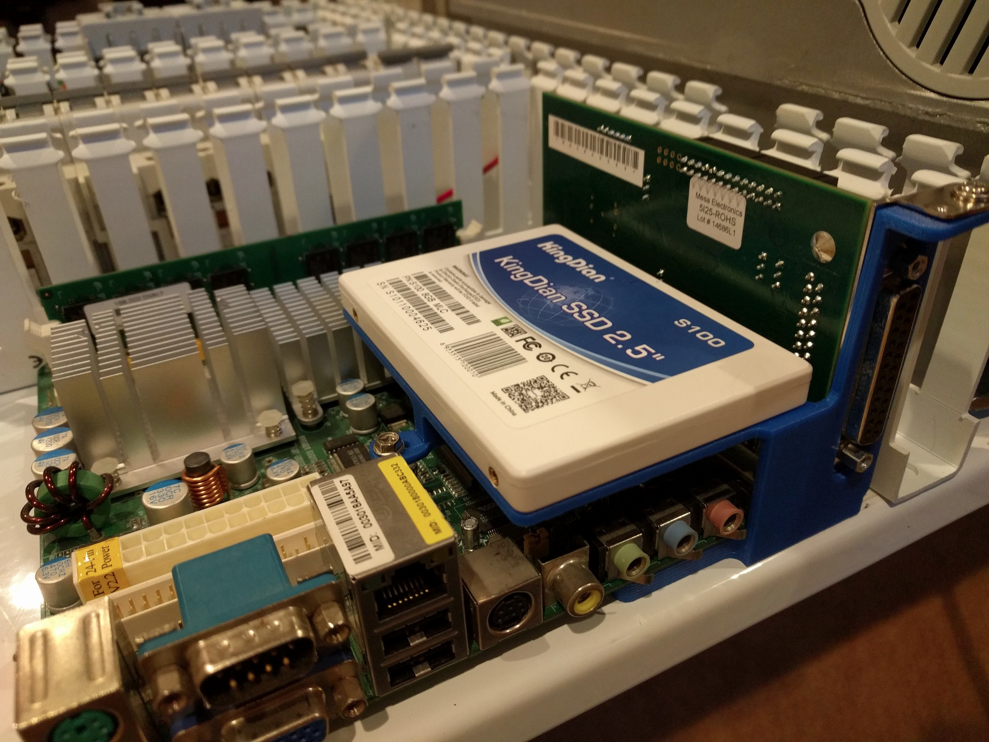

I just saw your ITX/5i25 bracket. Like! much better solution than the ugly sheet metal bracket I bent up to do the same job.
forum.linuxcnc.org/media/kunena/attachments/2917/PB060042.JPG
Would you mind posting your STL please? I would like to print one.

I wanted to mount the Mini-ITX motherboard to the back plate, but was unsure how to stabilize the 5i25 PCI card. What I ended up doing was drilling the back plate for the mini ITX mounting pattern and then designing a stabilizer bracket for the PCI card and a mount for the SSD. It just slipped over one mount of the board and gets held down when the mounting screws for the motherboard are screwed down.

Hello Mark,
Glad you like the bracket. Ive uploaded the files to Thingiverse. Here is the link. www.thingiverse.com/thing:2800306 Ive included the Fusion file if you need to make changes.
