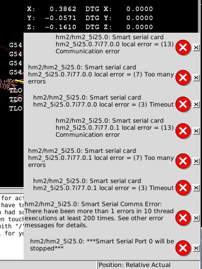

Also while the machine was enabled and running with no input linuxcnc halted with the message below. I don't know what happened?

PCW or Andy may know the specifics to the 5i25 communication errors you show on the attachment. I assume this is on you new PC?

Those errors indicate that the 5I25 has lost connection to both sserisl devices on the 7I77 either due to loss of power on the 7I77 or some other global issue

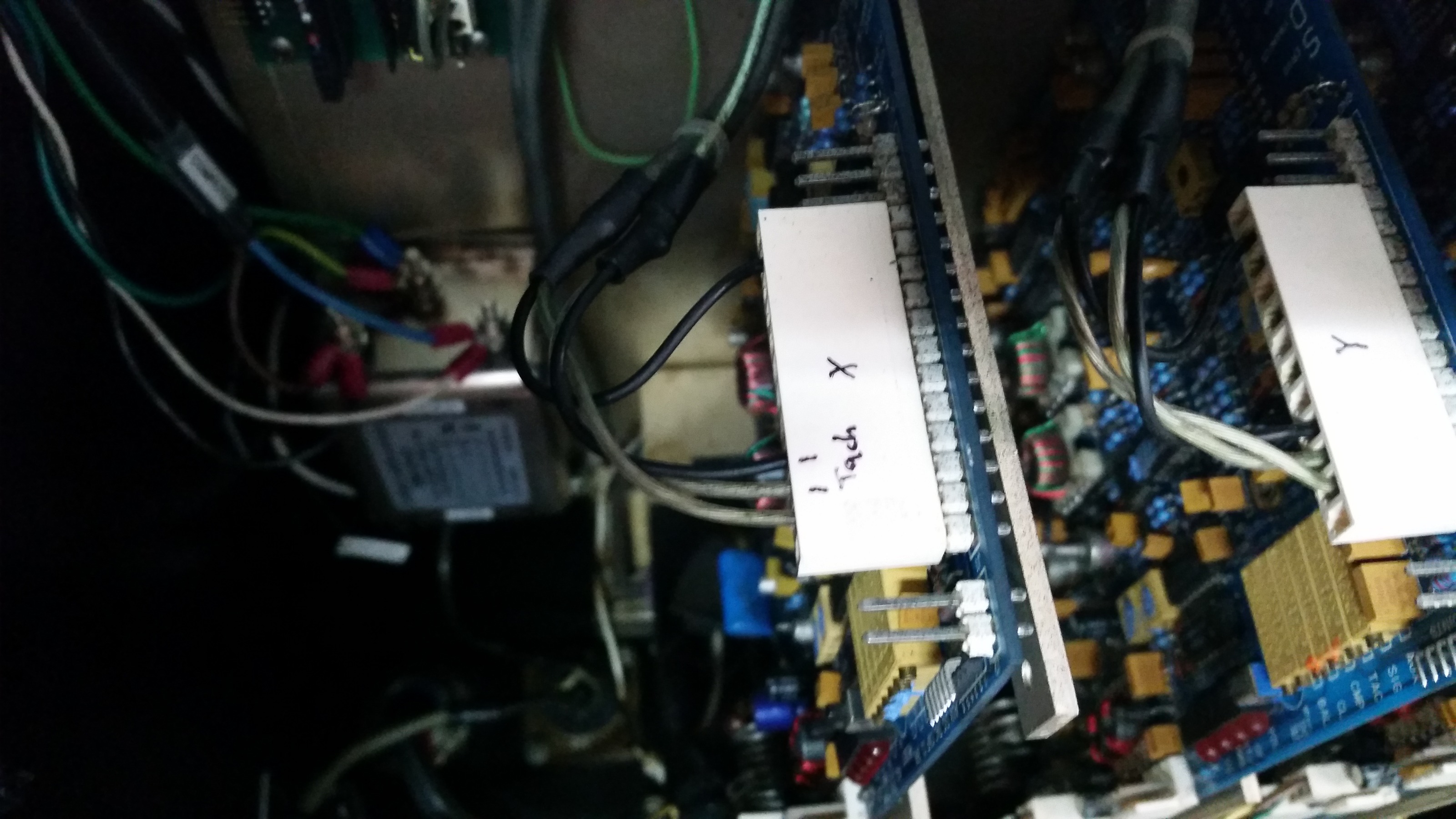

None of the connections to the TB5 changed, they are the same since 2016. The ena- to westamp J1 p-8, ena+ to J1 p-10, gnd to pcb 803 p-2, aout0 to pcb 803 p-1.
Since all the fun I have gone back and checked the ena- and + with a multimeter and both ends or the wiring disconnected.
Jim

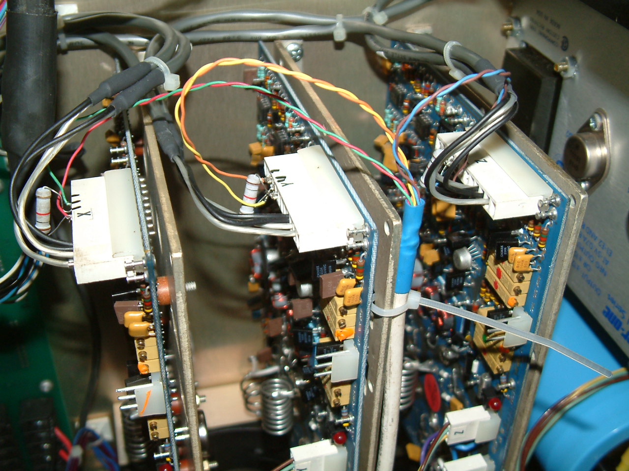

Yes, your first paragraph does make sense. But I never realised that as well as hooking up the P3-2 to TB8-16 and P3-1 to gnd. I should disconnect all three TB-5 1/2,4/5,6/7 ena- and + connections. So they are still connected.
Well then I am going to need to rethink the setup that I currently have and eliminate the TB-5 DRV ena-/+ connections. Below is the setup I was originally using and have continued to use between the ena-/+ and the westamp J1-P8/10.
In the photo the CAT5 cable with the blue tape at the end of the casing connects the ena-/+ to the westamp.
thanks
Jim

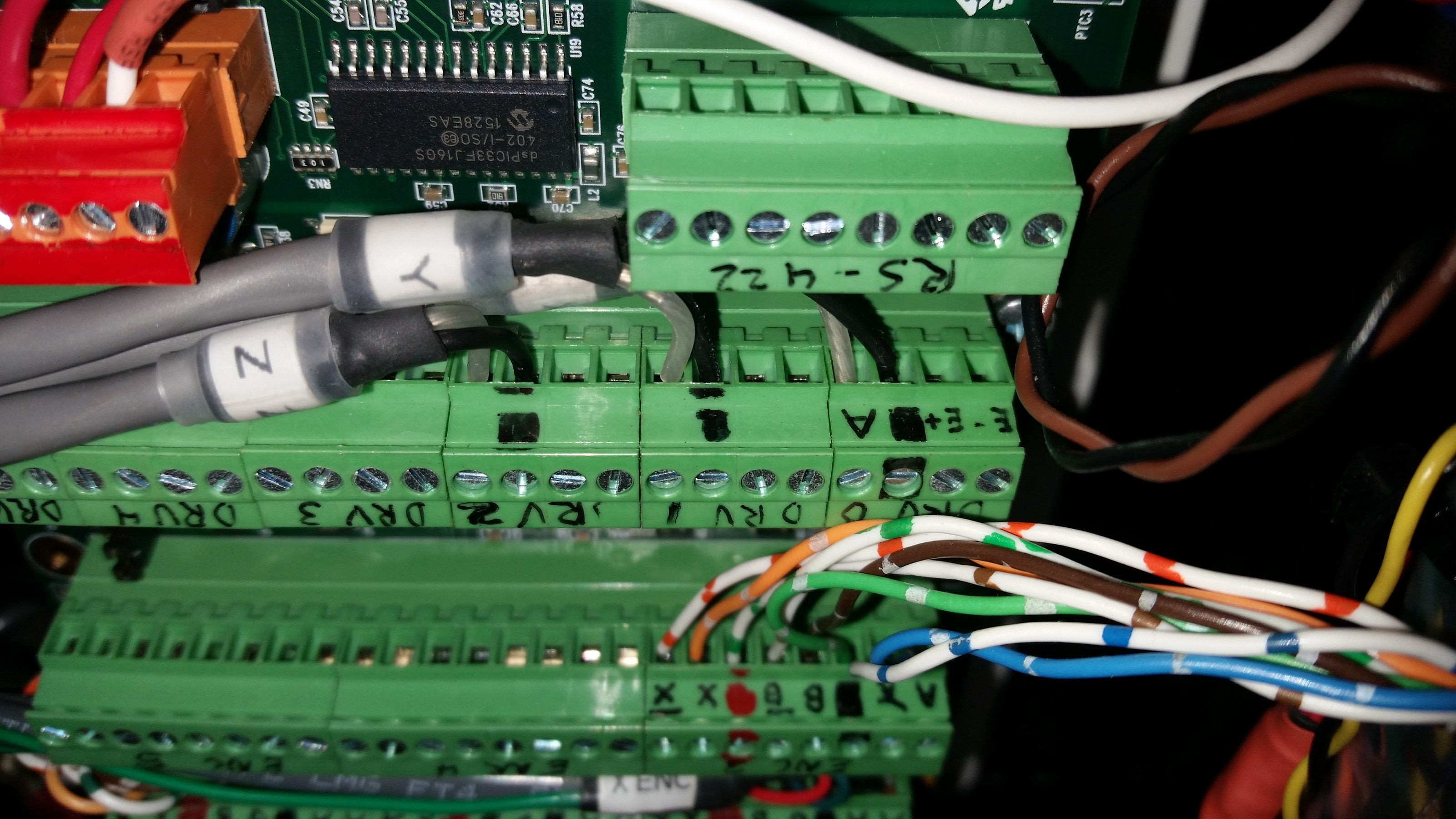

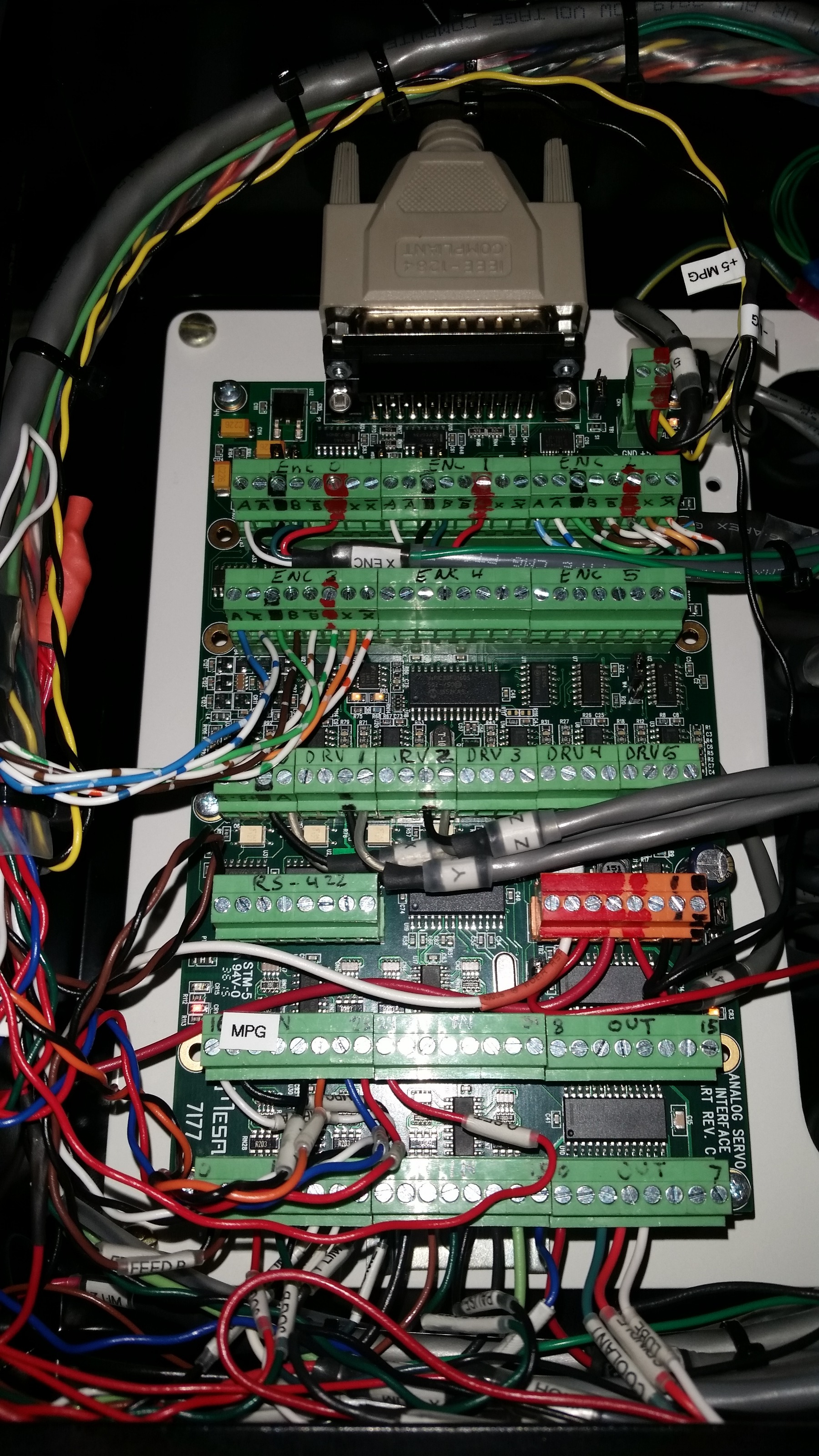

Here are a couple of photos of my setup. The 7i77 showing the drv connections that only go out to control the analog signal to the drives. It's the black and clear wires and these are not the enables. You can see the other end connections on the white J1 connector on the SD1525 (I assume westamp is the same or similar. Check the docs) same black and clear wiring as well as another set coming from the motor tach. I don't have any other wires connected on that J1 connector. I assume my boards enable by default simply by powering them on. If you remove the resistor and the extra wiring you added via the cat5 cable, do the drives enable when you apply 24v to P3 on the 801?
