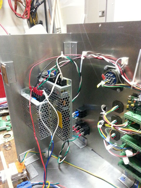

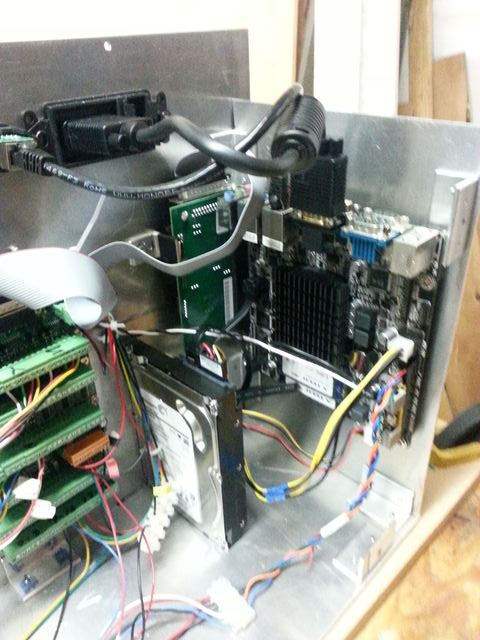

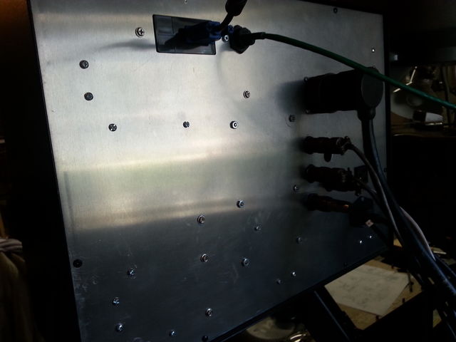

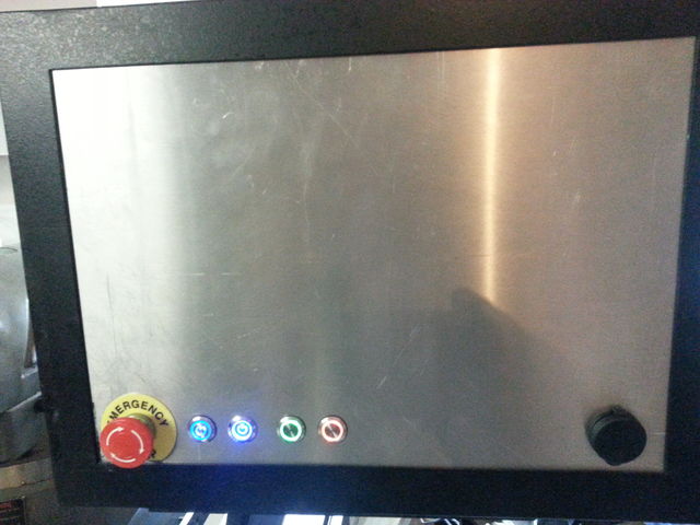

Thought I should post some pictures of the finished product. Well almost finished I still have to make a mounting bracket for the monitor. Pictures are inside and outside of the box.
Jim
