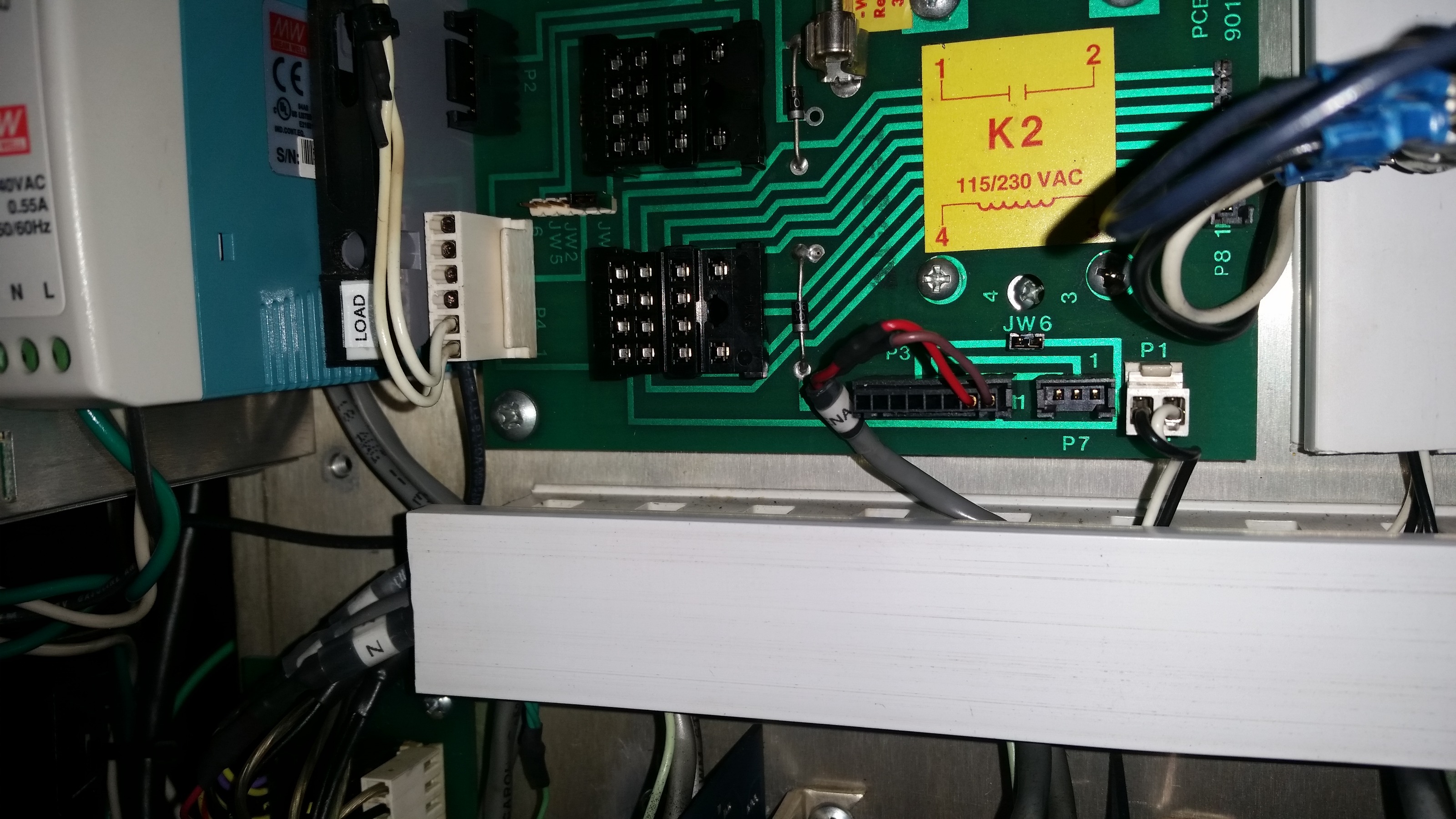

Replied by OT-CNC on topic 2nd stage of Crusader II retrofit
And here is the 801 again. I know yours is older but similar. I would clip the connections on the left as shown and documented by others.
Also I think polarity is important on switching the relay. I assume the diodes I see on my board are for flyback protection.
BTW, it looks like pin2 on your left J1 connector has the crimped connector not fully seated? They will pull out super easy if not latched.

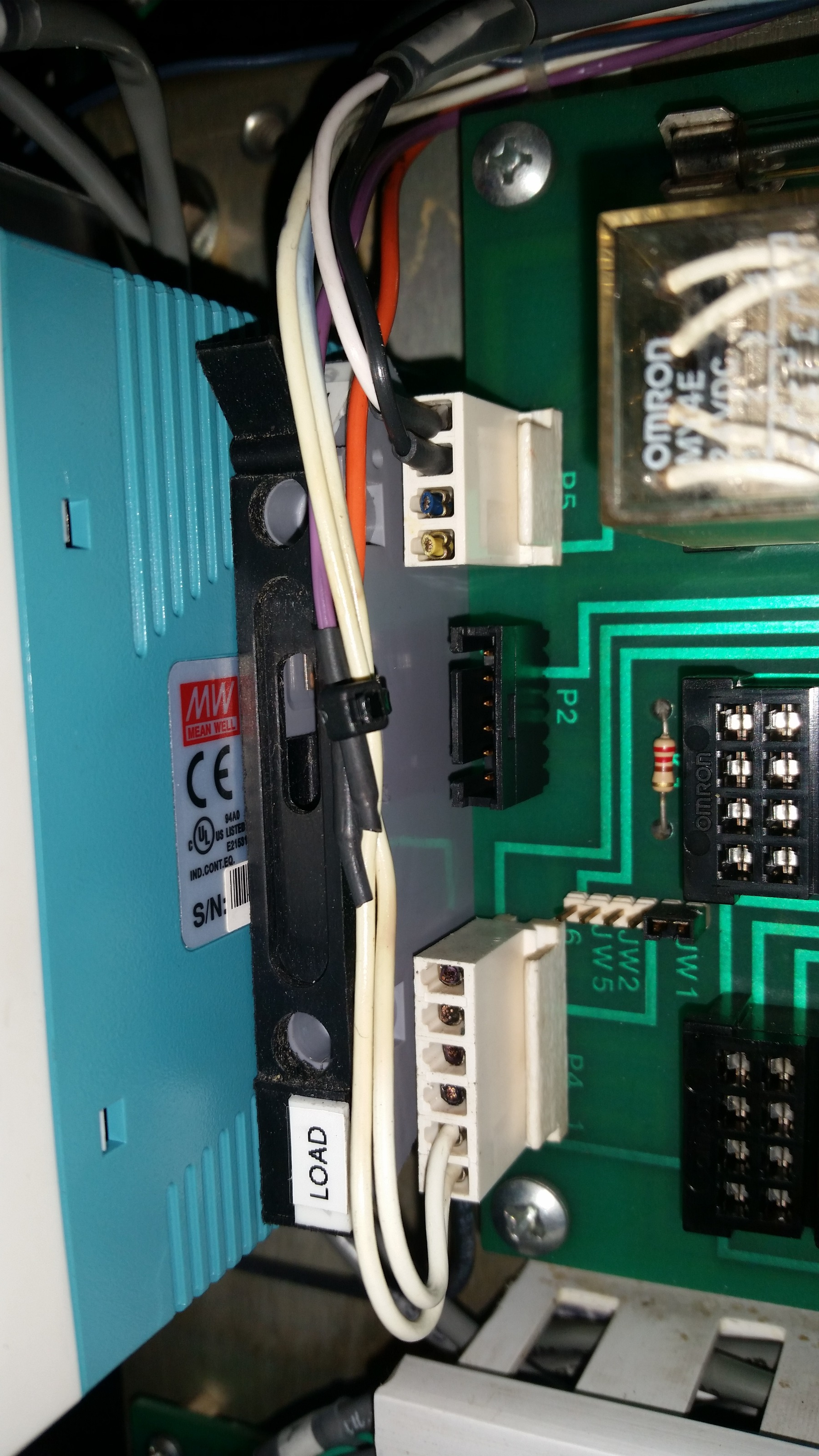

OT-CNC
Looking at your pictures of the PCB-801 you have wires at P5 2 at the top and at P4 are 2 at the bottom. My 801 has no P5 and all the wires coming from the P4 go to the manual/auto switch for the spindle. Is that what the 2 wires on your P4 do?
Jim
31 Jul 2018 02:57 #115197 by OT-CNC
On the P5 connector, I'm powering the oiler. It was a convenient place to tap into for me. On P4, the 2 wires traces back to the auto/man switch.

OT-CNC
Well its 10:00am here and I connected the 24vdc power to the enable circuit on the 801 and the power came up but the drives didn't lock up as they would normally.
I reconnected the P4 connector with all wires and that brought up the 15vdc power on the amp cards and all three axis locked up.
