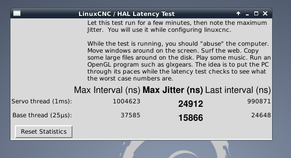

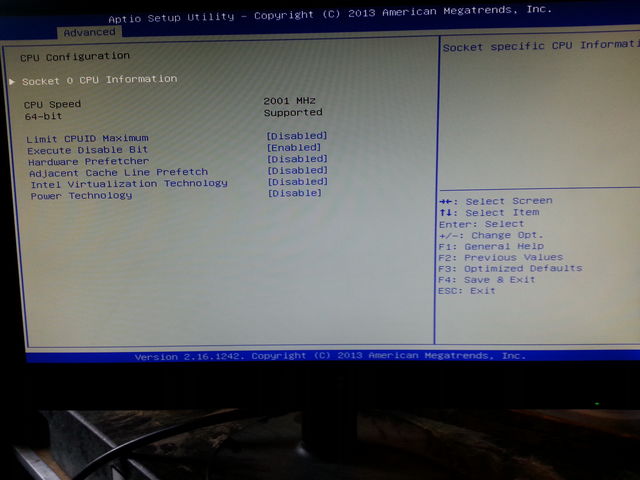

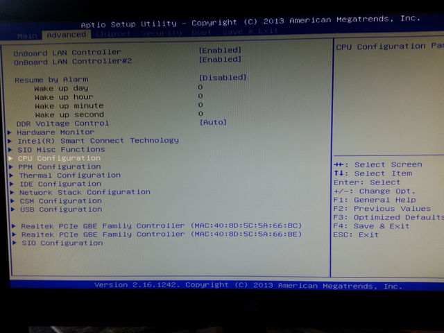

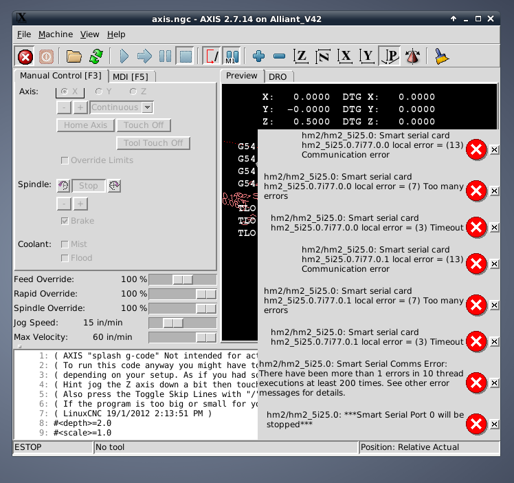

06 Aug 2018 15:53 #115670
by jamby
Replied by jamby on topic 2nd stage of Crusader II retrofit
Over the weekend I was able to run several test programs and at the end cut some parts. All went well except for the times when the machine was idle and the computer was sitting with linuxcnc running. Several times like that communication between the 5i25 and 7i77 was lost and linuxcnc threw errors (see pic below).
I had tried turning off options in the bios in hopes of stopping these errors but it still occurs. It never happens while the machine cycling but only when sitting idle (drives not enabled).
There's a pic of the latency test I ran this morning below (this is a servo machine). And a couple of shots of the bios screen.
I don't know if this is a software problem or if its a hardware issue, bad connection or badly seated card. I will open it up and look.
Thanks again guys I am so close I can taste it!!
Jim

- Posts: 18111
- Thank you received: 5330
06 Aug 2018 15:58 - 06 Aug 2018 16:04 #115671
Replied by PCW on topic 2nd stage of Crusader II retrofit
Those errors indicate complete loss of communication to the 7I77
Possibly because of 5V issues on the 7I77
How is 5V power supplied to the 7I77?
Have you checked the 5V voltage at the 7I77 card?
5V power option jumpering should be:
7I77 W5 RIGHT
5I25 W2 DOWN
External 5V supply to 7I77 TB1
7I77 W5 RIGHT
5I25 W2 DOWN
