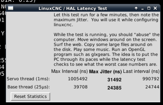

This indicates that your host PC has stopped communicating with the 5I25 card for longer than the default WD timeout (which is 50 MS I believe) This means your PC has a big problem with realtime or there's a hardware issue with the PC or 5I25 card
I would run a latency test on the PC for at least a couple of hours and if that does not show anything, measure the PCs 3.3V (low 3.3V can reset the 5I25 card causing this kind of symptom) Other things to try are moving the 5I25 to a different slot and cleaning the PCI slot

12 Aug 2018 02:50 - 12 Aug 2018 03:04 #115939
by jamby
Replied by jamby on topic 2nd stage of Crusader II retrofit
PCW
Latency test ran for 3-1/2 hours. It was a idling motherboard but is 31500 bad?
I'll hook up another power supply tomorrow or monday and see what happens.
Finding a place to check the 3.3vdc power looks tough from the google check I ran.
Also the log files showed this just after the latency test started.
RTAPI: ERROR: Unexpected realtime delay on task 1
This Message will only display once per session.
Run the Latency Test and resolve before continuing. [
Jim

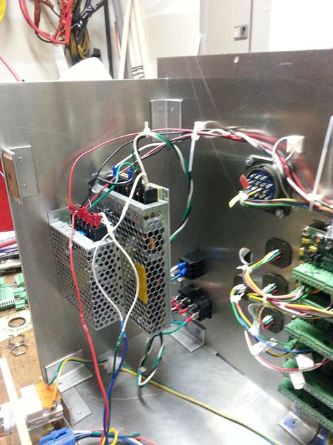

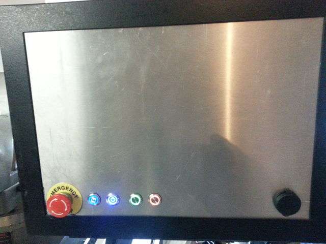

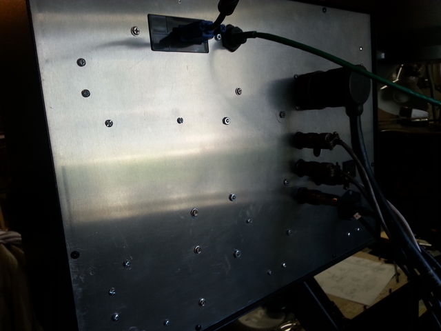

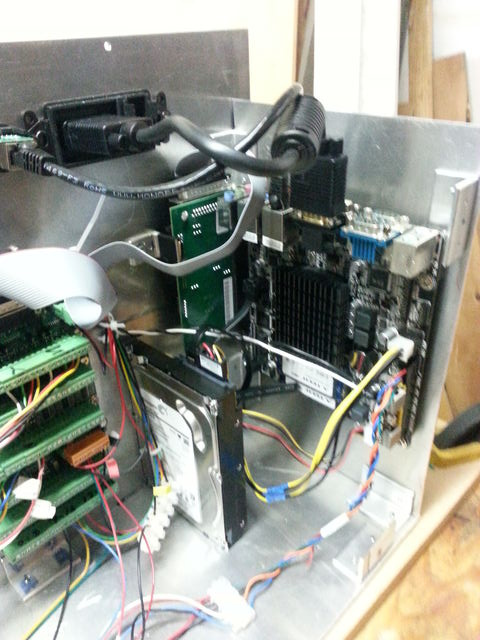

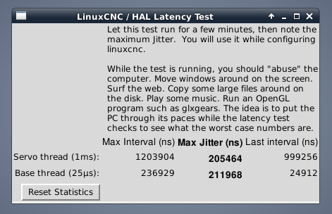

Hey, time to check in again. I have been able to stop the problems with the screen by using "xset s off -dpms" this will keep the screen from going to a blur when returning from when it goes blank (not screensaver). The connection issue between the motherboard and the 5i25 appears to be corrected by a number of changes I made to the bios of the motherboard.
The computer has run for over 10 hrs with no problems and cut a couple of parts after that. The screen never goes blank or the screen saver come on. So I turn off the screen when ever I leave it. Am attaching a number of photos of the finished box and a latency test where there were three glxgears and youtube running dufing the test, run after the bios changes. Odd because a test run earlier without any other programs running showed 1300 after 20 min. ? oh well.
Also interesting, during that test the cpu temp rose to 167 dg the highest I've seen yet.
Thanks to all for their help
