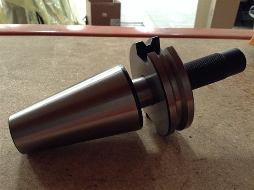

09 Apr 2021 21:35 #205480
by J Green
Replied by J Green on topic Bridgeport Torq-Cut TC4G Retrofit
Align tool changer (Purchasing tools to align this) What tools did you use ?
Don't forget to share your latest INI and HAL files . They really helps others trying to do retrofits .
Bob
Bob
- chopper79
- Posts: 193
- Thank you received: 44
09 Apr 2021 21:42 - 09 Apr 2021 21:46 #205482
by chopper79
Replied by chopper79 on topic Bridgeport Torq-Cut TC4G Retrofit
I was able to use the one from work to align the umbrella. Saved me $1200+
The tool has the 40 taper flange, adapter (goes in your tool pocket on umbrella) and then the centering pin. Keep adjusting umbrella assembly until everything is aligned. Snug bolts and recheck, then final tighten. I checked pockets ~90° from the next one so I had 4 points aligned with no issue.
Looks something like this.
Last edit: 09 Apr 2021 21:46 by chopper79.
