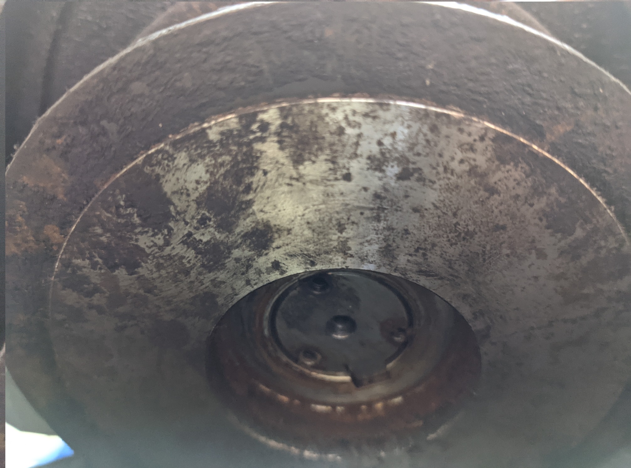

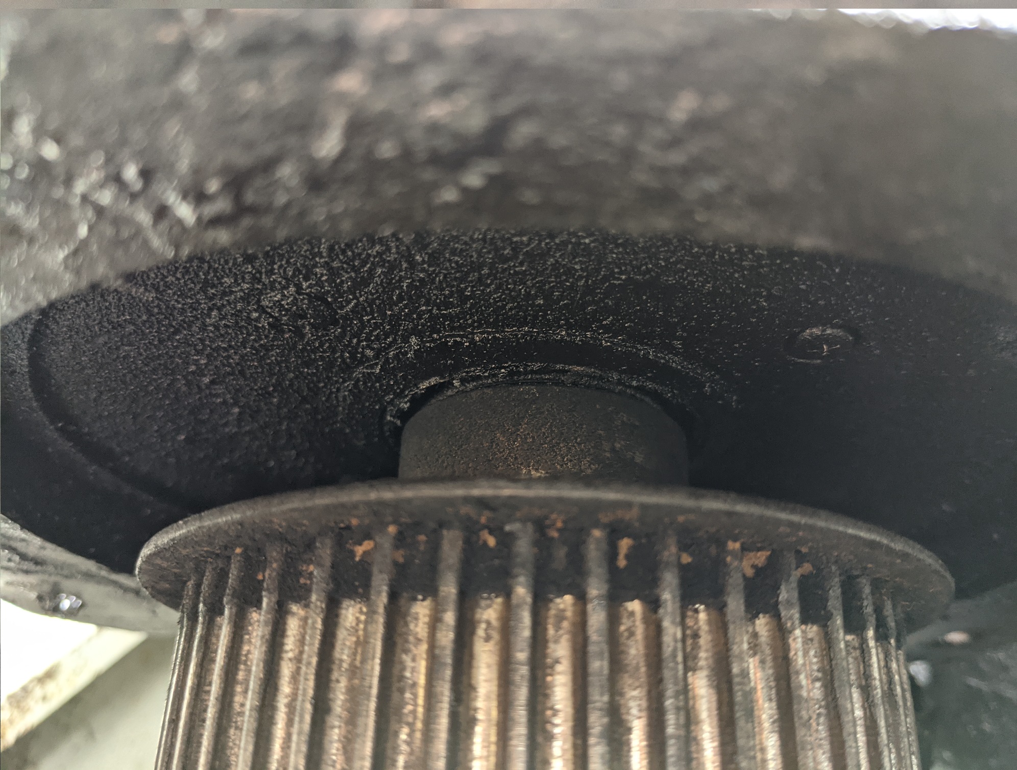

When you rebuilt your spindle motor, how was your pulley configured on the shaft and how did you get it off the shaft. I have attached pictures of mine. It had 3 small screws holding an end camp to the shaft. There is a collar between the pulley and motor casing that seems to keep the pulley in place. Before I start pulling on this or applying heat I wanted to make sure there is nothing I am missing. This appears to be a press fit and the axial offset is handled by the collar and end plate.

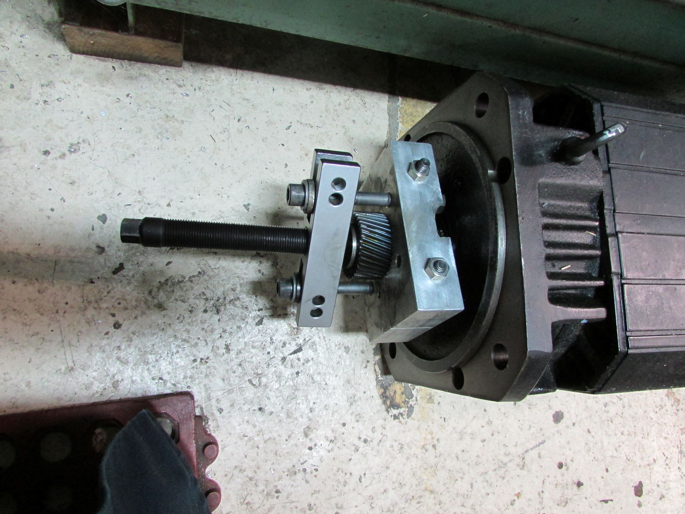

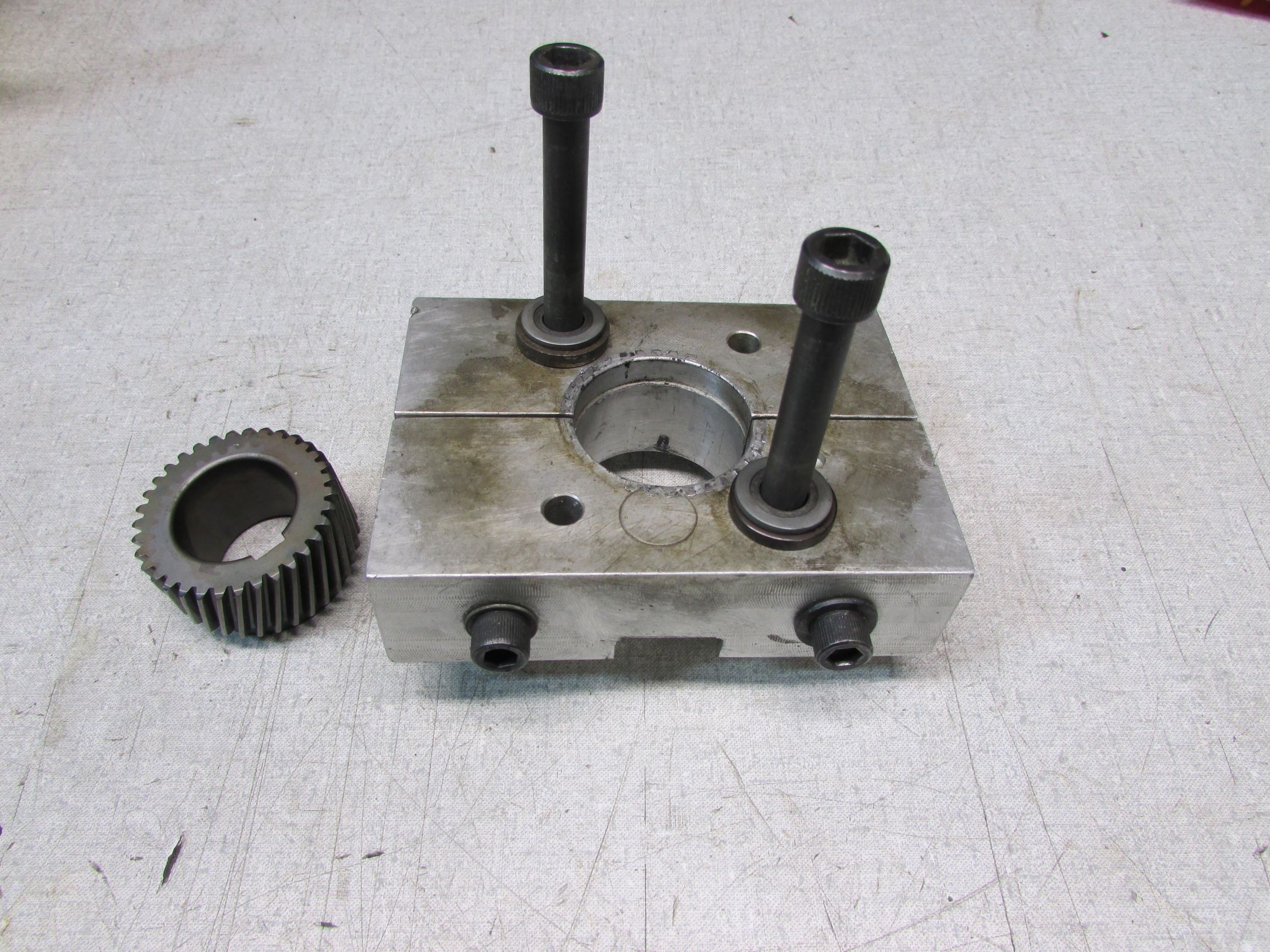

Yeah that was a fun one...
1) Remove the (3) screws and end cap
2) I had to make a puller setup for it
3) The gear is shrink fit not press fit
4) Used an induction heater to heat it then remove
5) Used an induction heater to heat for installation
Blow torch would work as well I would think, but would allow the heat to soak into the motor by the time it was to temperature. I purchased one of those hand held induction heaters from ebay and it works awesome! I had to get the gear up to ~ 500°F to remove and install which took about 45 sec with the induction heater.
The collar on there is just a spacer so the offset distance is correct for proper gear meshing.

Shoot... After I posted your pictures showed up. Do you have a transmission? Is that the spindle motor or the transmission output shaft?
I would use a standard pulley puller and an impact gun for that setup. Should need a little heat and some penetrating fluid maybe.
I am beginning to wish I did not have the transmission... I need to make it shift gears and I am no good at code..haha

Yeah I realized you have the transmission also. But technically the motor shaft and whatever its attached to should be similar. I will give it some heat and see if we can get it to move. Also may make something like your puller. I don't have a puller that gets around the flanges on these pulleys. I could just put the torch next to the pulley and spin the spindle at 10 rpm until it falls off!?!
If you remove your transmission the spindle motor should need an adapter plate (maybe able to reuse the one on the transmission) to mount to the head and a drive pulley and be good to go, 8000rpm 32 ft lbs torque. Unless you are tapping or doing all your work in steel with large cutters I don't see the need for the transmission. My spindle is shot so I am exploring a rebuild or new spindle made overseas with a higher rpm limit. All my work is small cutters in aluminum so I can afford to loose some power.
I looked at your S remap stuff but am no good at code. I would love to see what you did for the tool change remap though. I am waiting on a sensor and will be trying to implement mine shortly.
