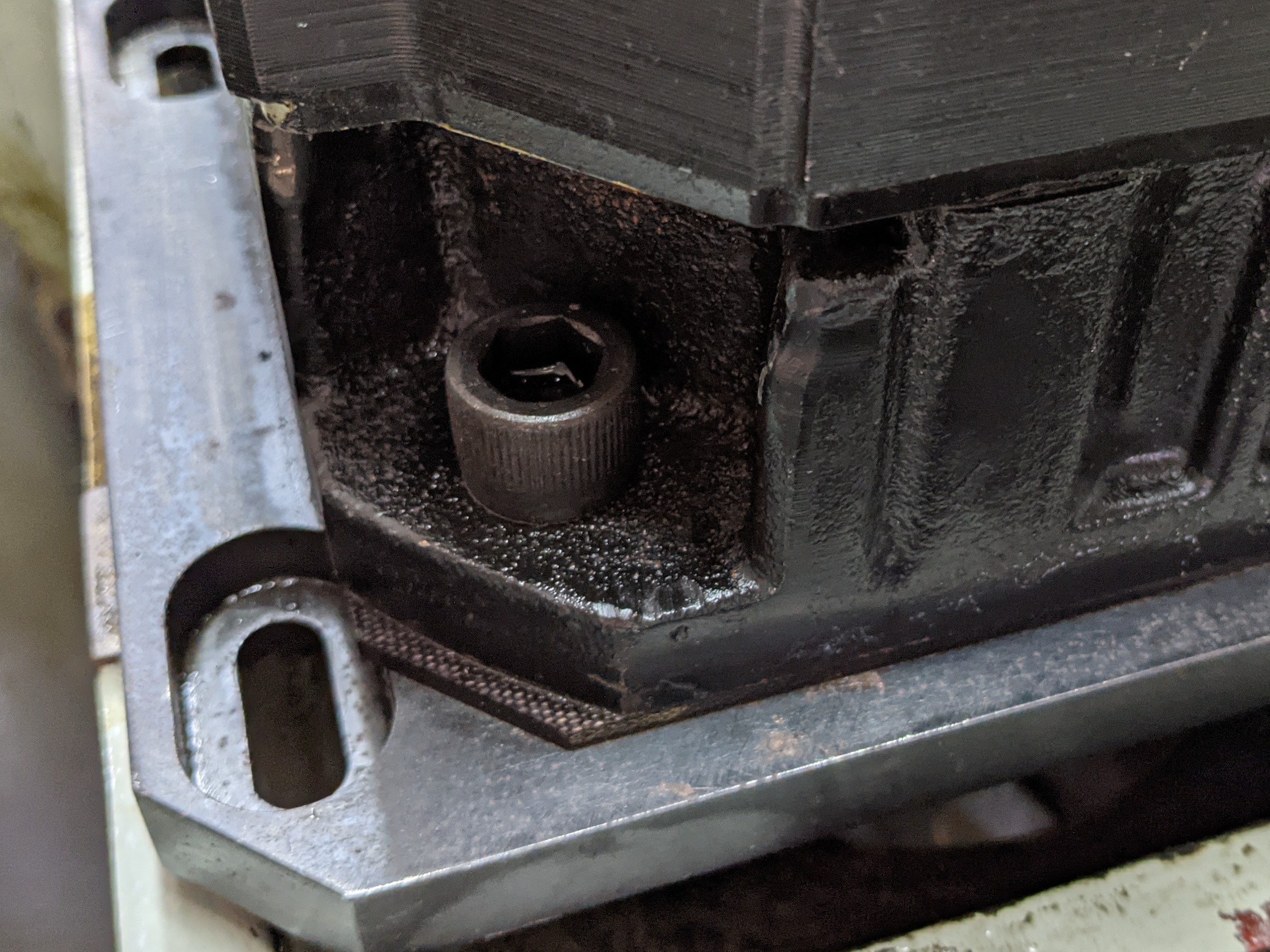

- Michael
- Posts: 335
- Thank you received: 59
19 Mar 2021 18:04 #202869
by Michael
Replied by Michael on topic Bridgeport Torq-Cut TC4G Retrofit
Thank you for sharing the files!
You have to get rid of that transmission. Unless you plan on doing a lot of tapping or steel work. My spindle is out for repair and I had them check to see what max rpm could be for the stock bearings. I was happy to find out it's a bit over 11k rpm. So I am having them bed the bearings at 10k, check for heat issues and plan to run the motor with a 56t pulley to get 10k out of it. I do almost exclusively aluminum so speed is my friend.
I attached a picture of the spindle motor adapter plate that the 8k spindles use in place of the transmission if you have any interest or need to ditch it some day. It's a simple part to make. Only critical tolerance would be parallelism.
The following user(s) said Thank You: chopper79
