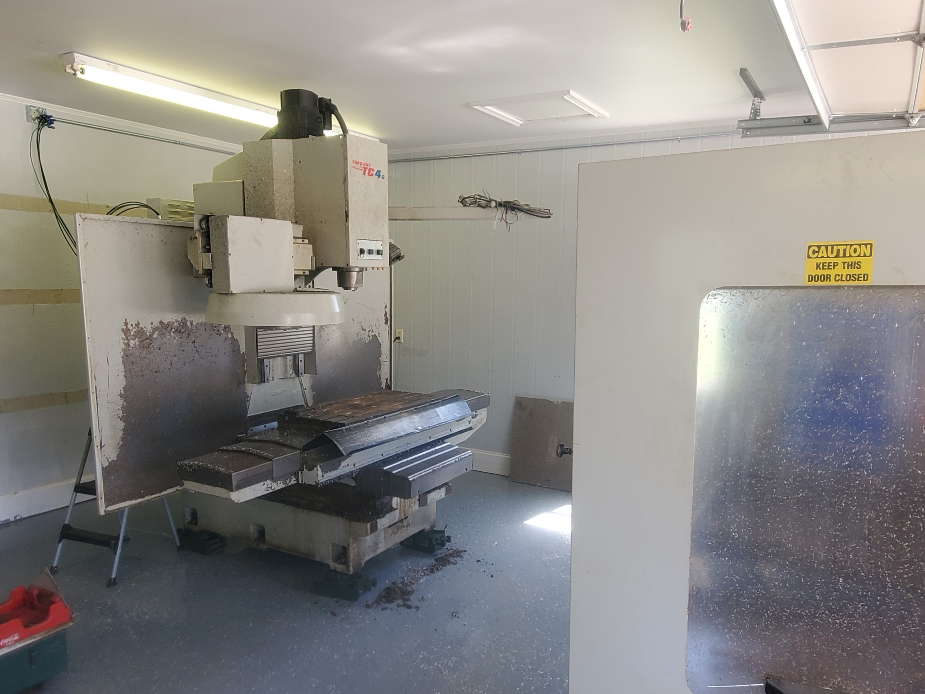

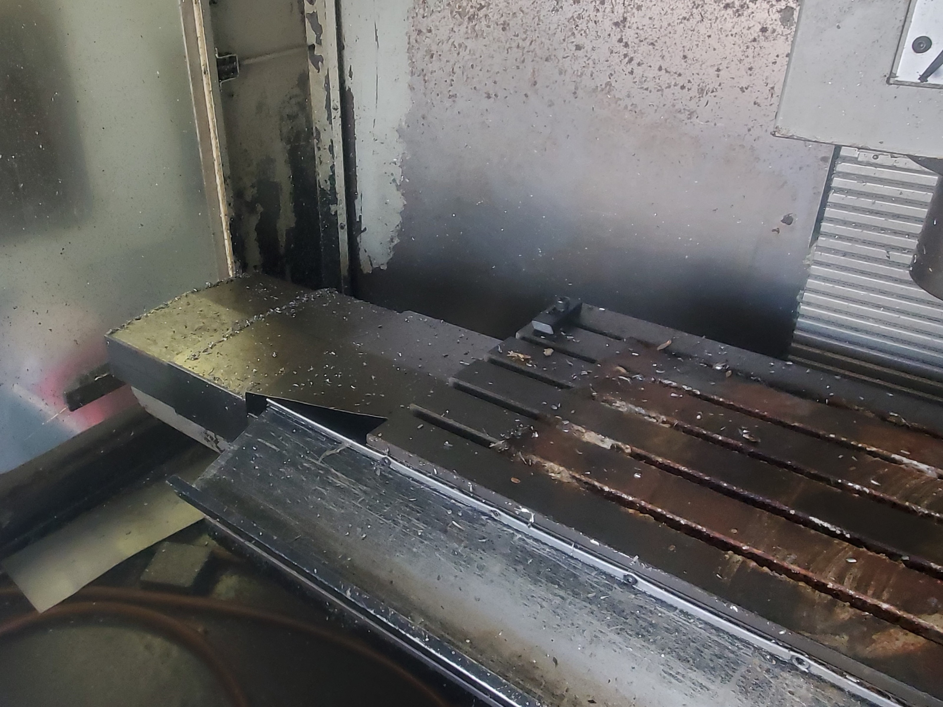

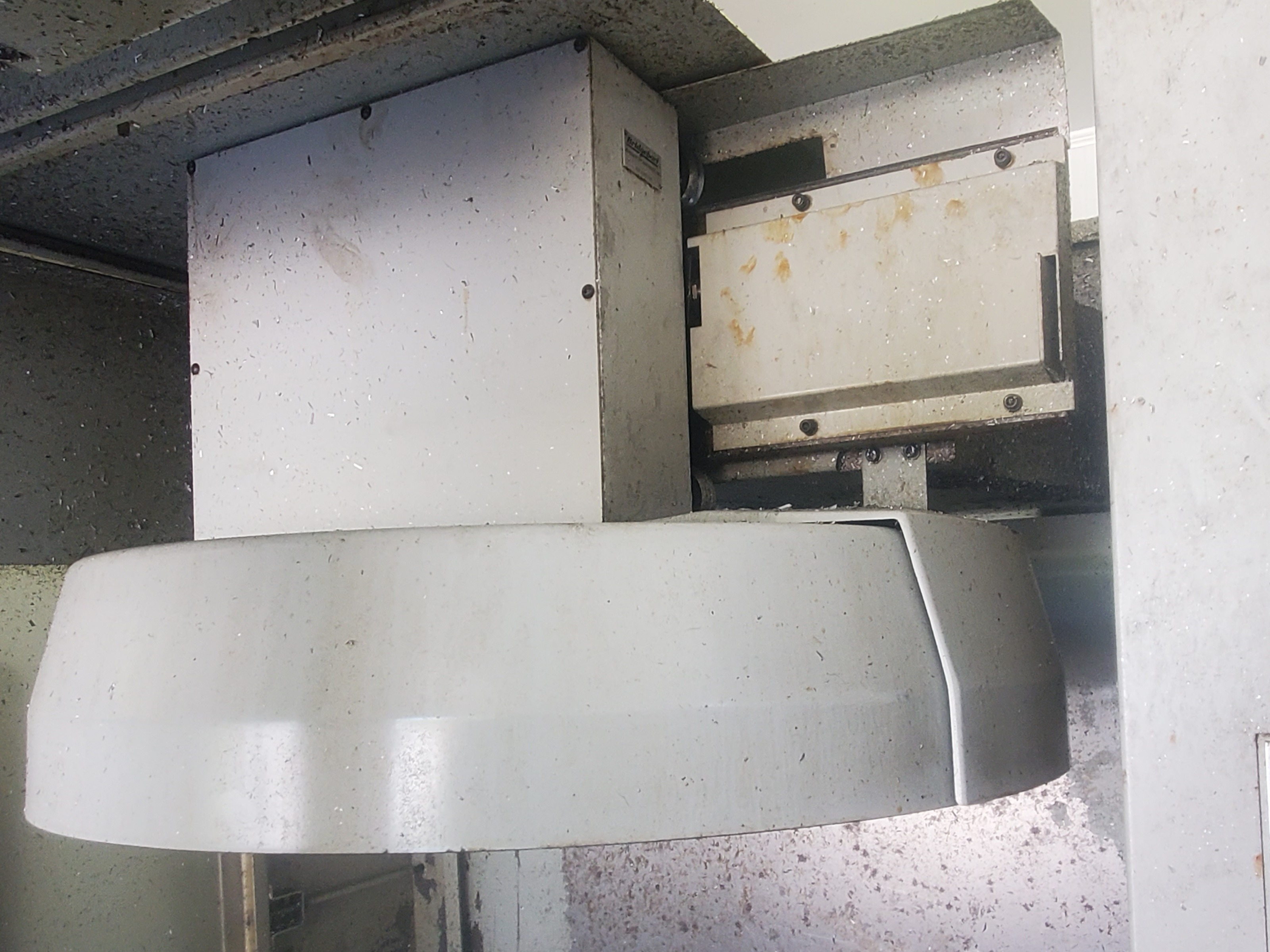

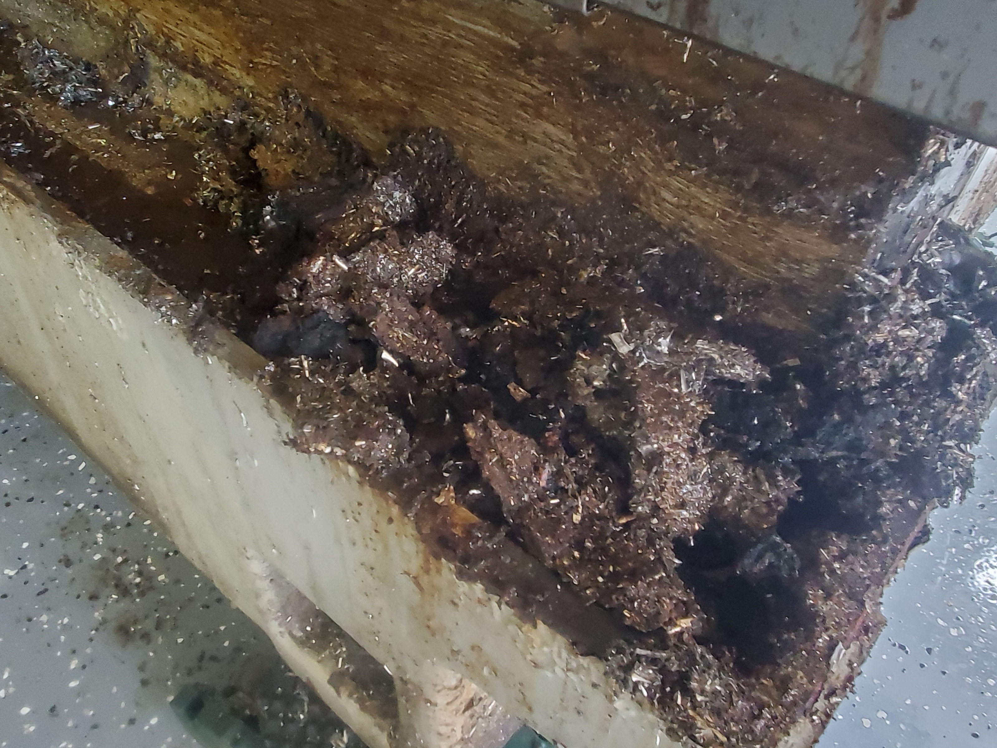

18 Apr 2020 21:26 - 18 Apr 2020 21:32 #164518
by chopper79
Replied by chopper79 on topic Bridgeport Torq-Cut TC4G Retrofit

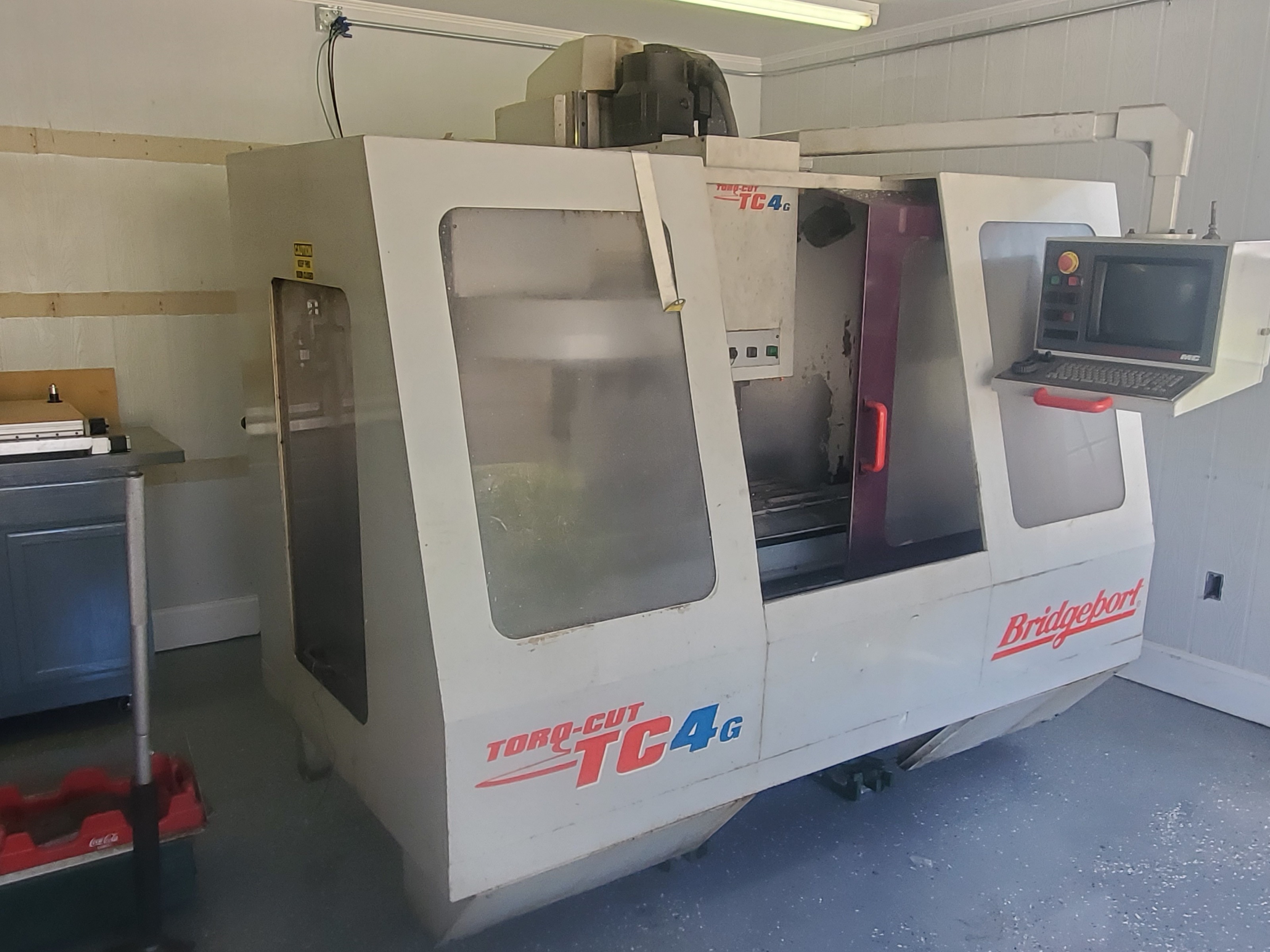

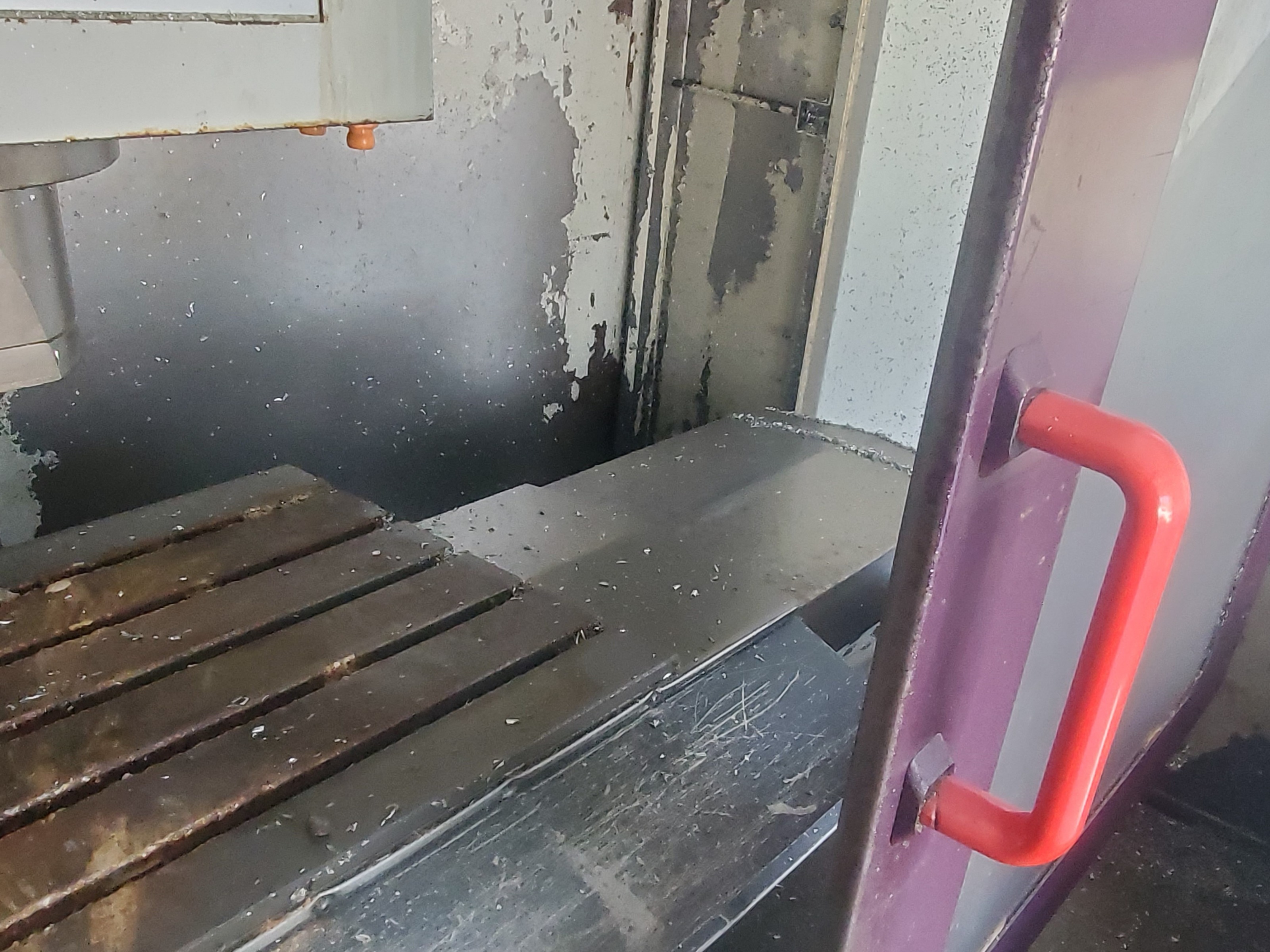

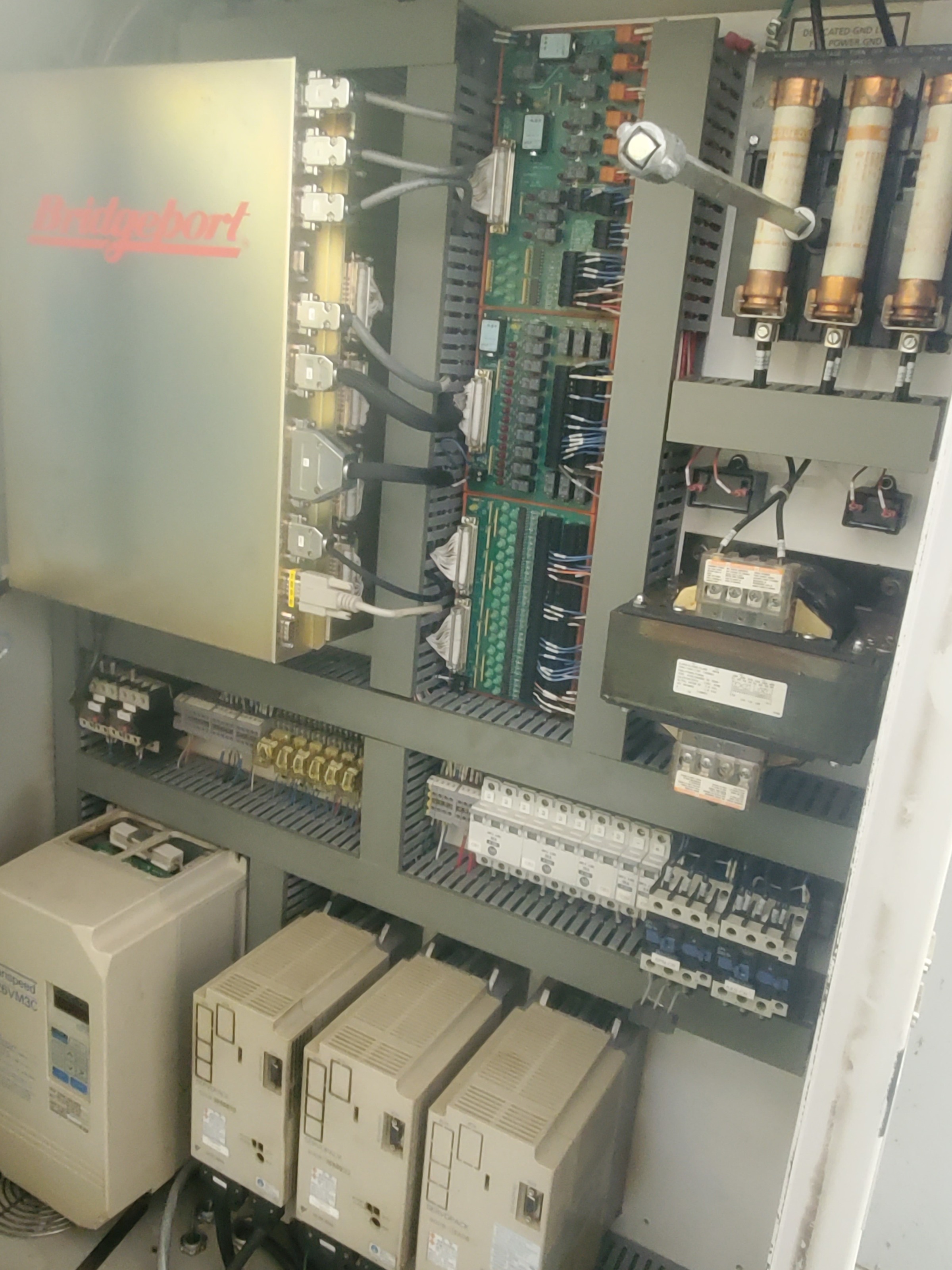

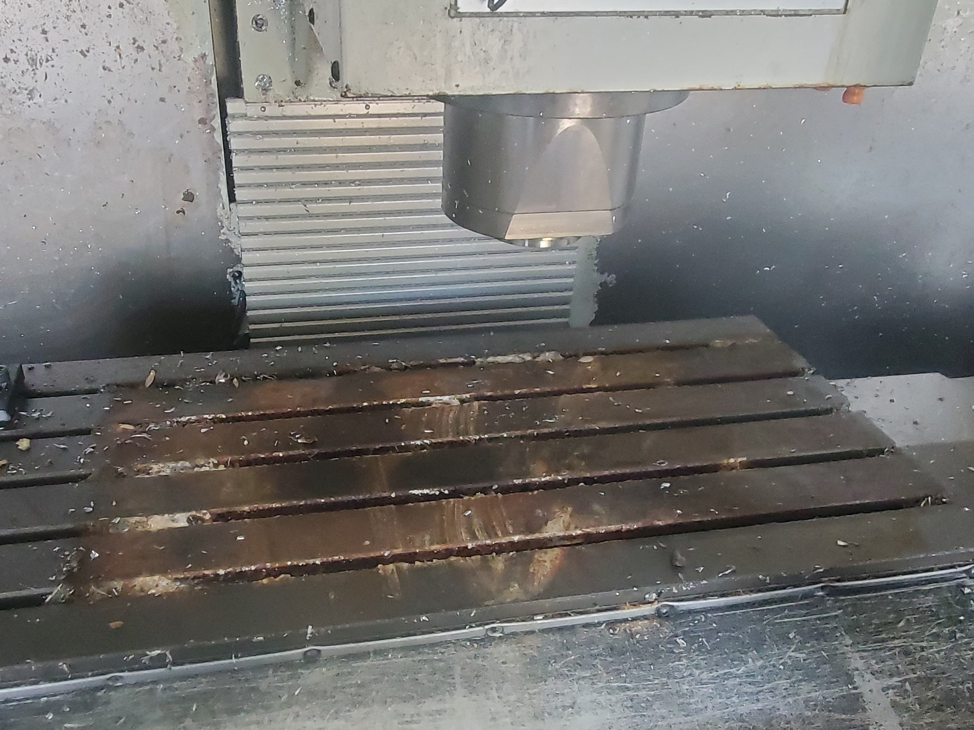

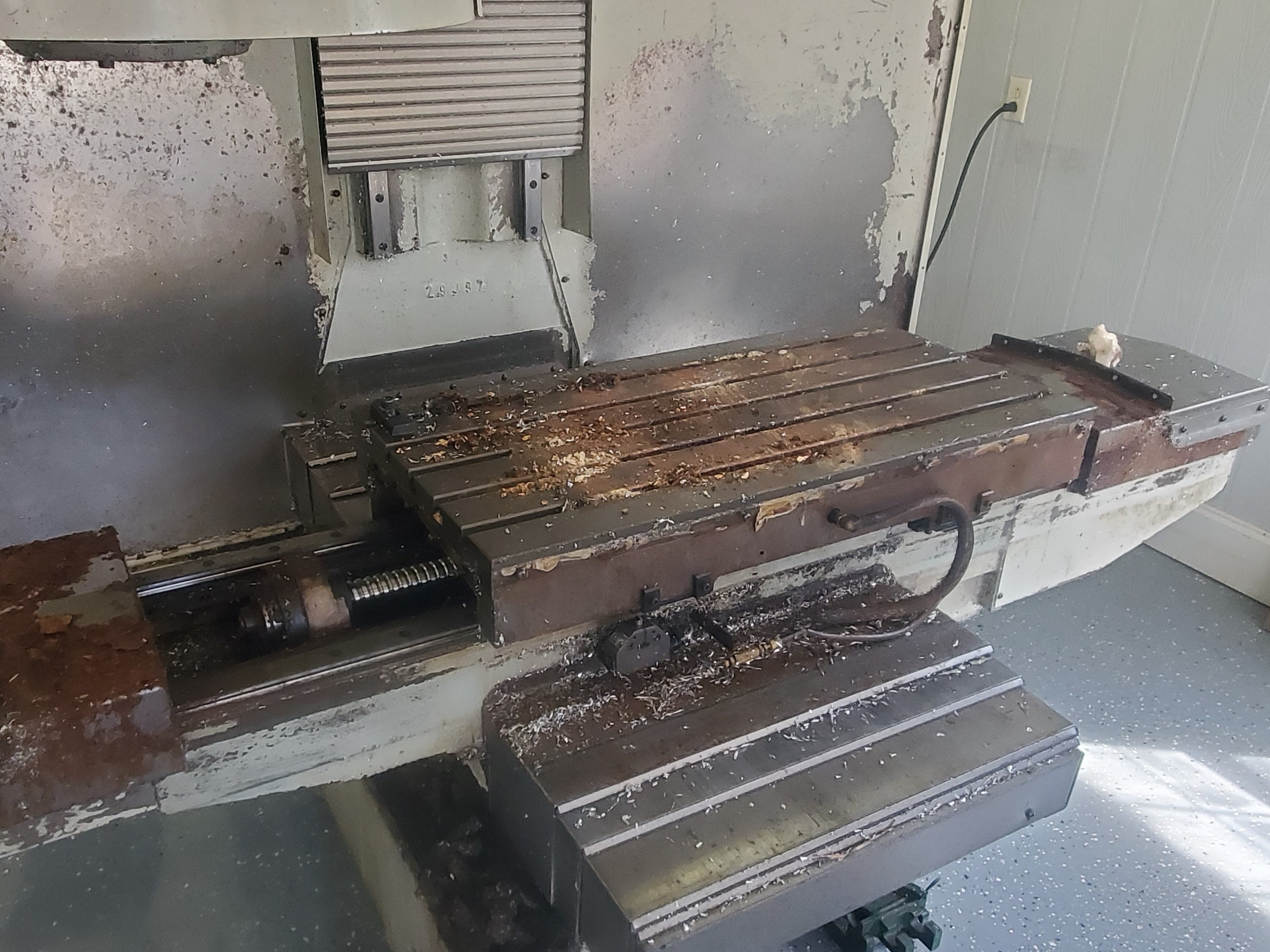

The fun has begun.
* Floors painted (Had my kids throw the paint sprinkle chips. They had a blast doing that)
* Ran power to machine (Ignore the temp wire connections. Will finish conduit once machine is on the floor)
* Tested all functions of machine

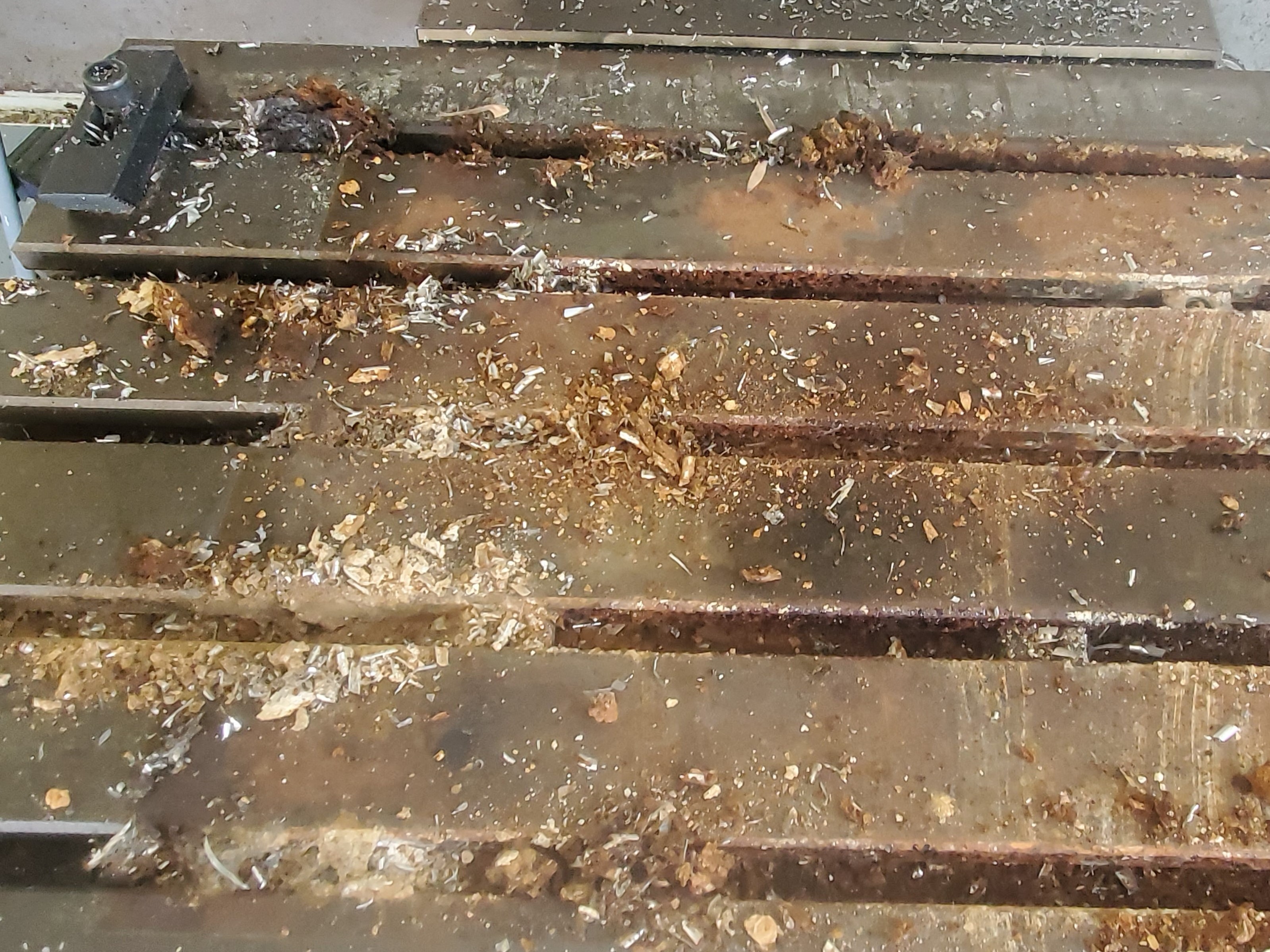

* Began disassembly and cleaning (Machine is filthy behind the scenes)

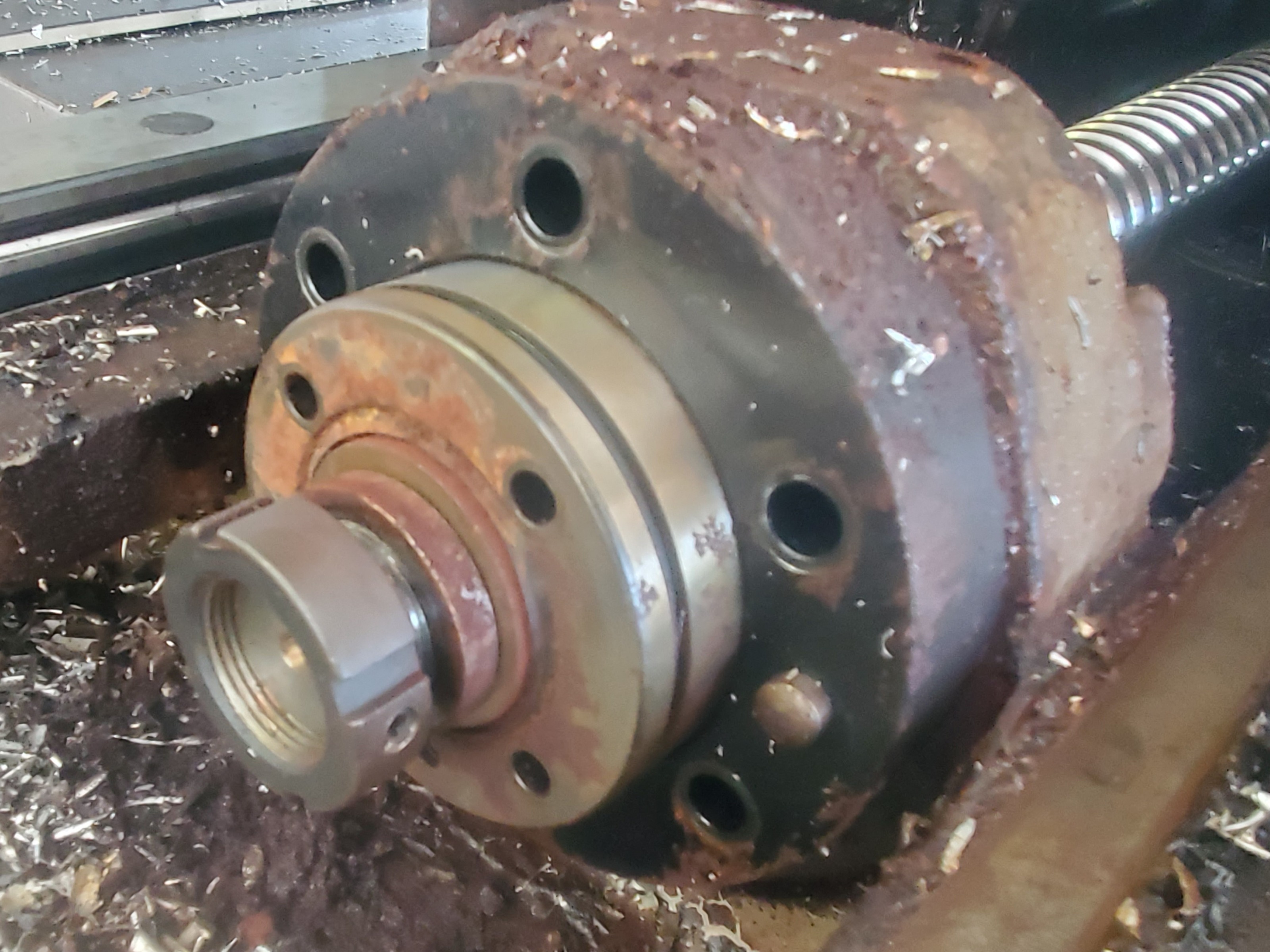

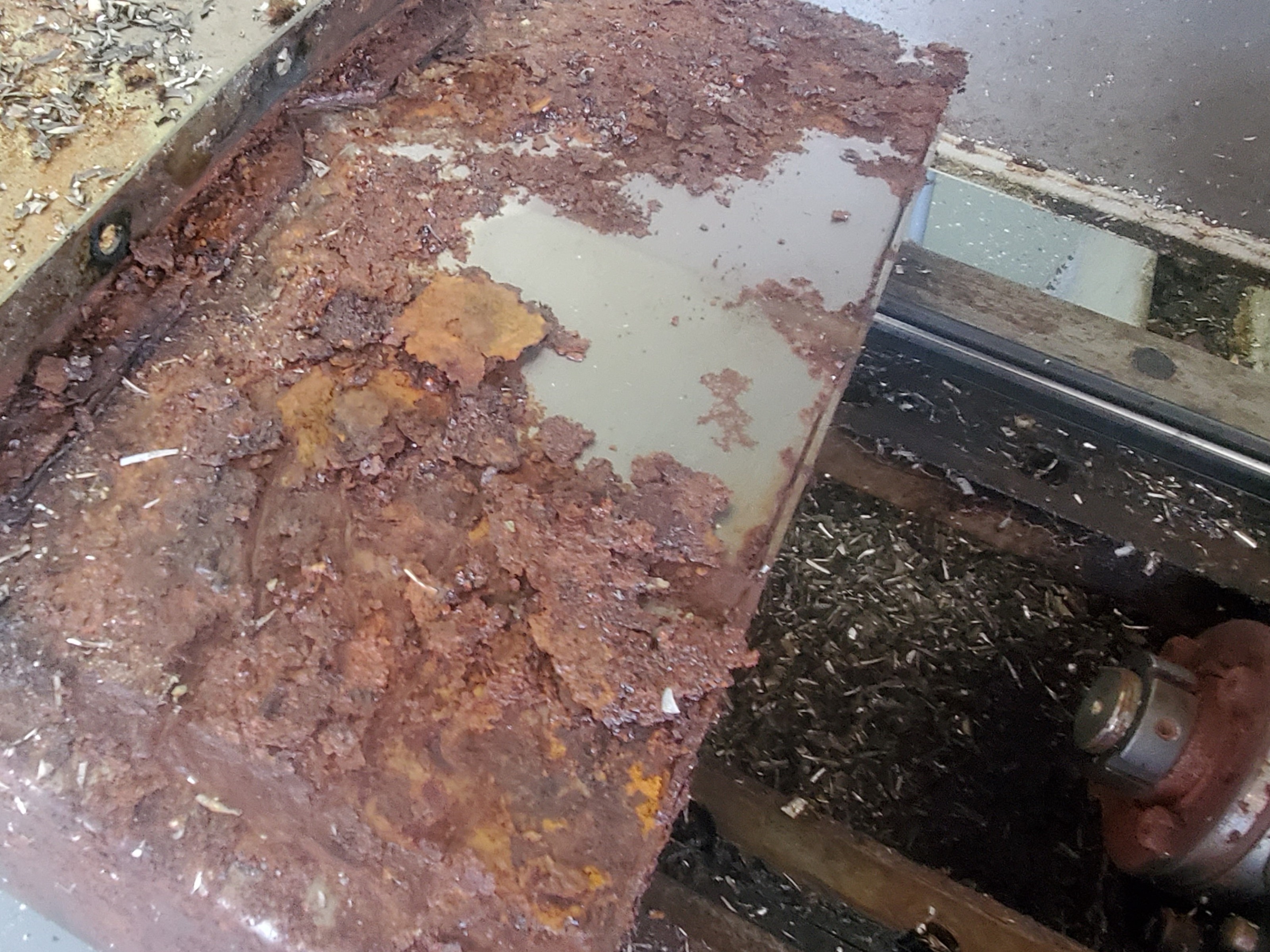

* Looking over mechanical components for issues (Found bad X axis thrust bearing. Appears rusted badly on the left side of X axis. Makes me think machine may not have been level and also do not see any drainage holes.)

18 Apr 2020 22:08 #164529
Replied by andypugh on topic Bridgeport Torq-Cut TC4G Retrofit
It looks lovely until you undress it, then horrors emerge.
But they look like good quality parts, at least. That probbaly means they will clean up.

19 Apr 2020 01:53 - 19 Apr 2020 01:55 #164564
by chopper79
Agree with both of you.
I ordered the replacement thrust bearing already. Part number below for anybody needing it.
Thrust bearing = INA ZKLF 2575 2RS

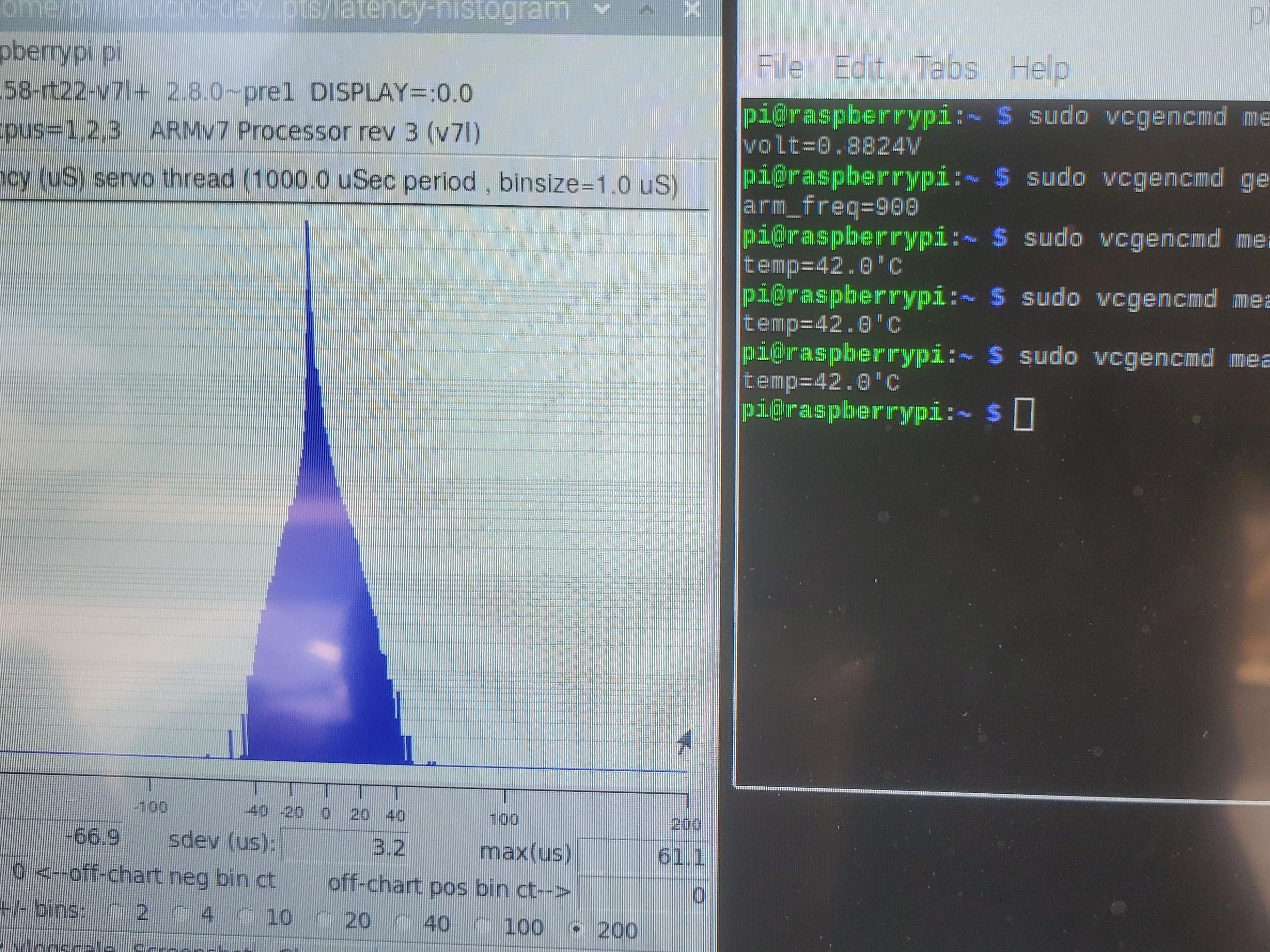

21 Apr 2020 01:40 - 21 Apr 2020 01:41 #164911
by chopper79

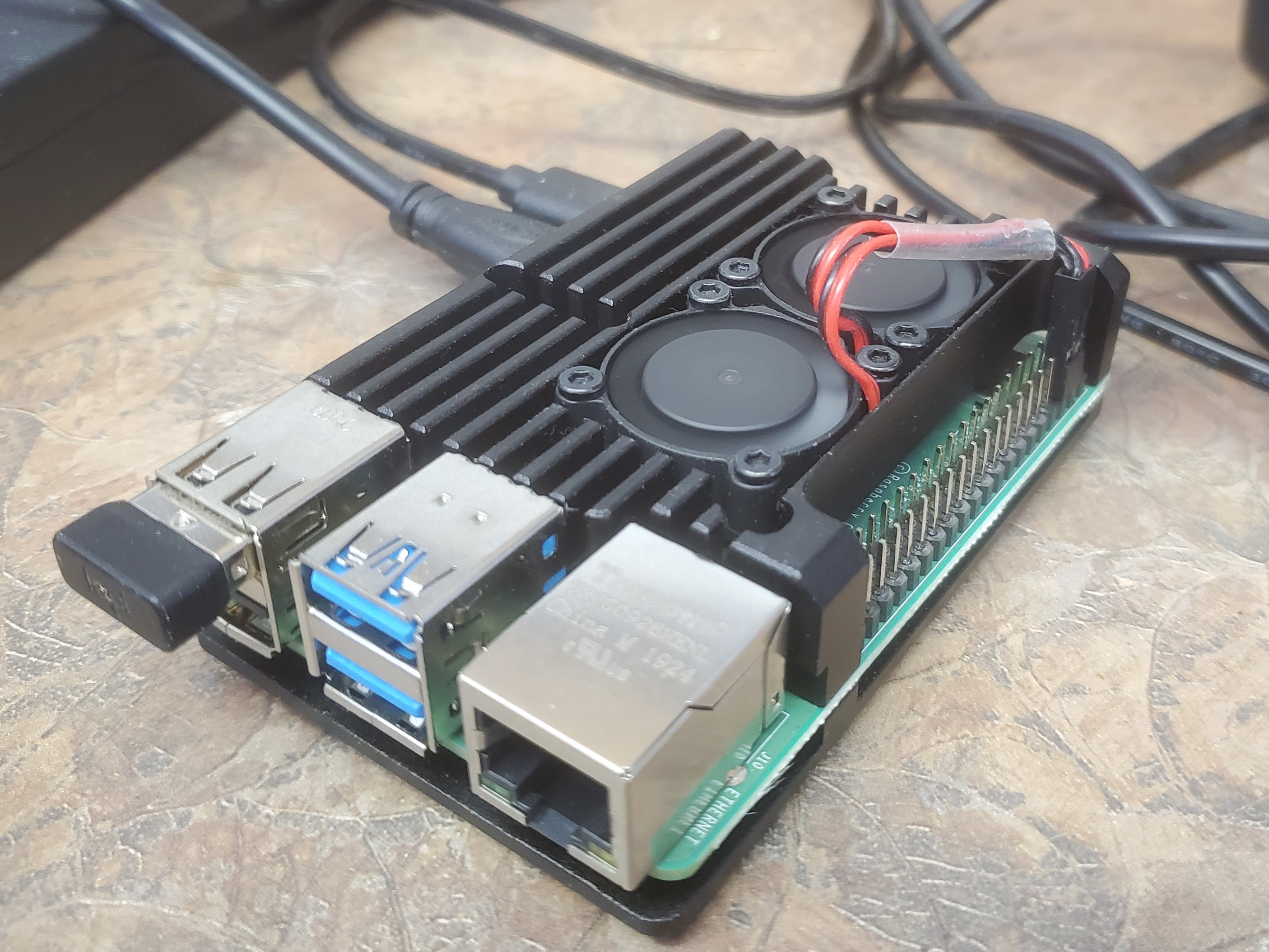

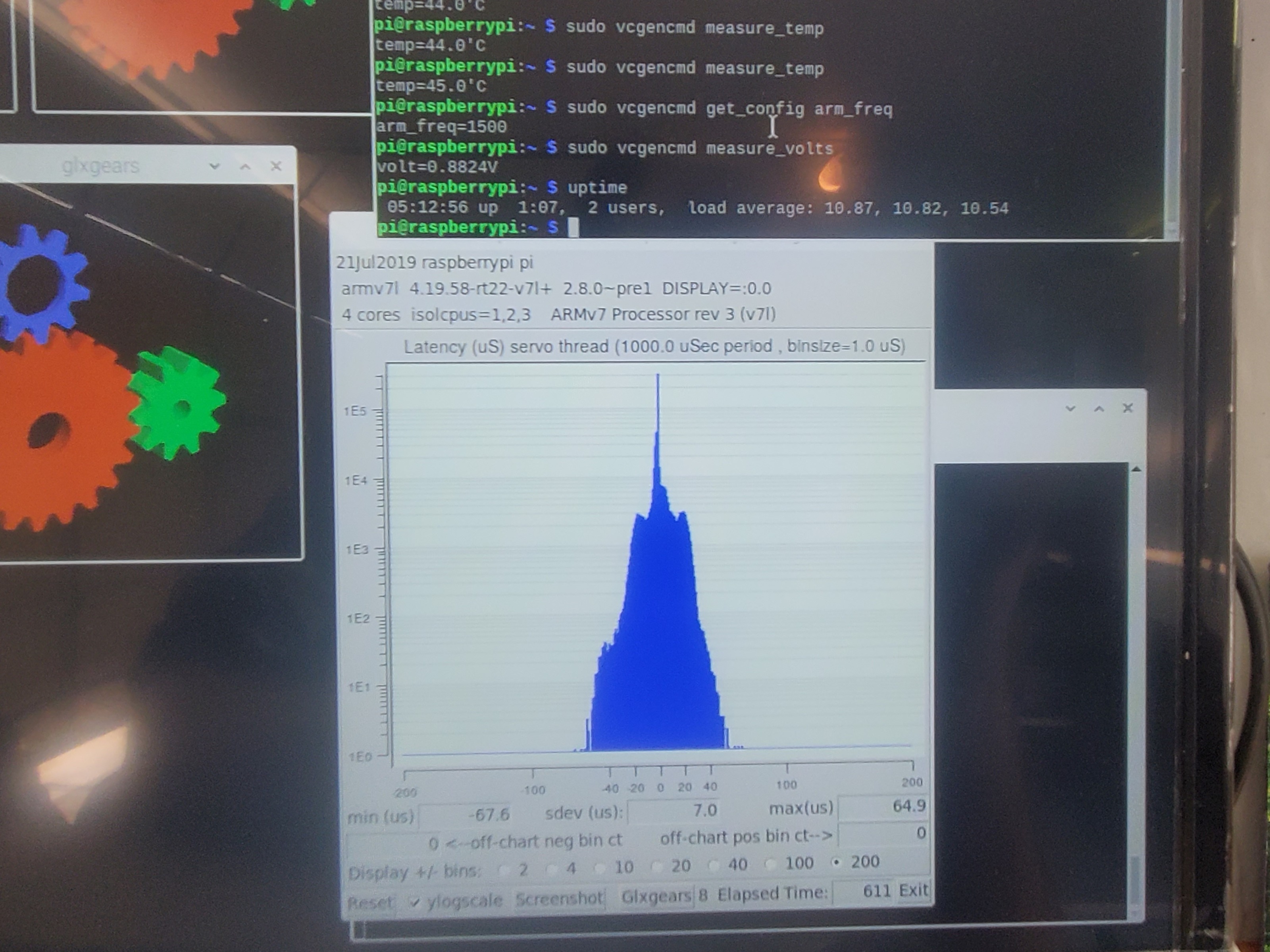

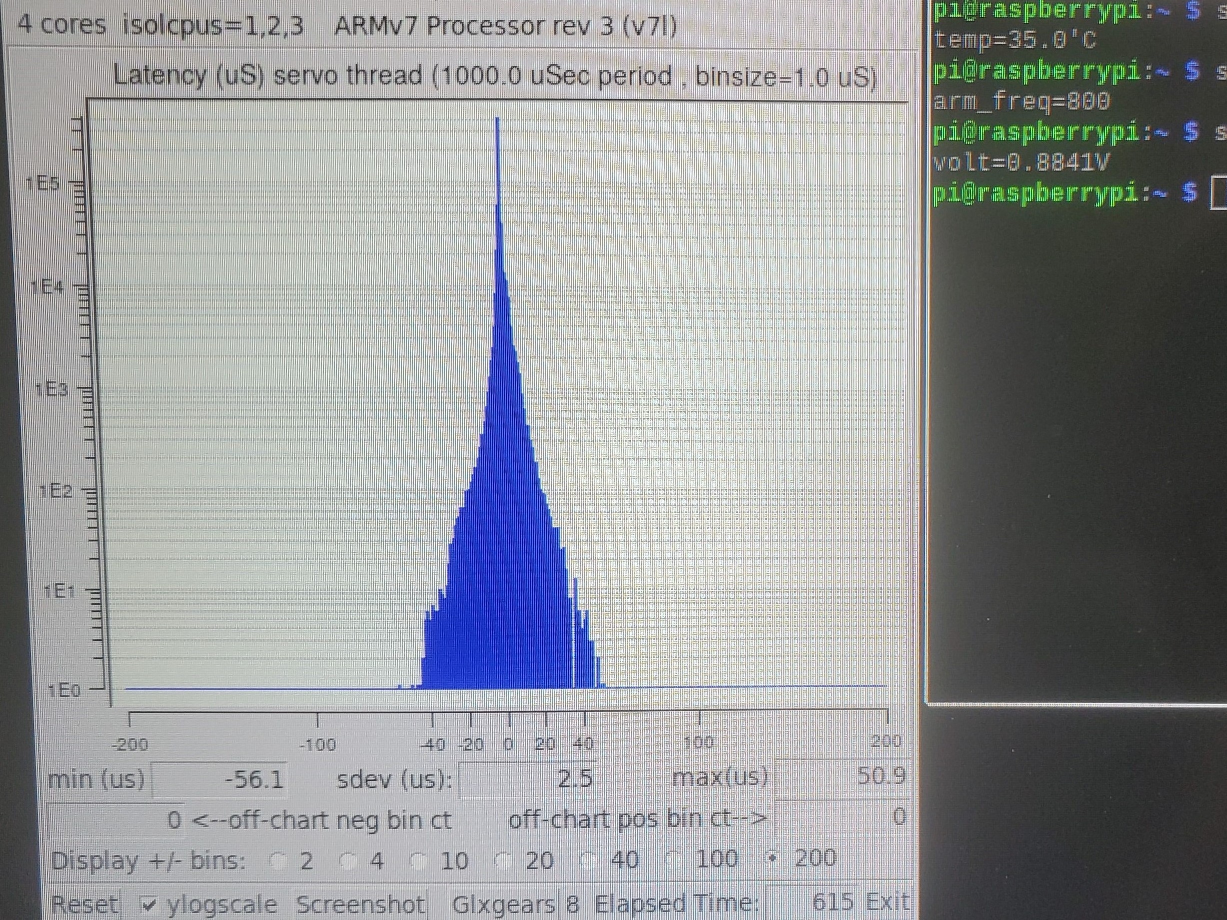

While I was cleaning the mill I have been contemplating what computer I should use to run this thing. I keep coming back to using my RPI4 communicating with a 7i92.
Here are my latency results over a 10 minute duration with 8 glxgears and moving files around. The 3 different views are from different arm frequencies. (800mhz, 900mhz, and 1500mhz)
Notice that the best numbers come from the 800mhz frequency.
What do y'all think about the results and why does the latency change with arm frequency? Any reason I should not run the mill from a RPI4?
