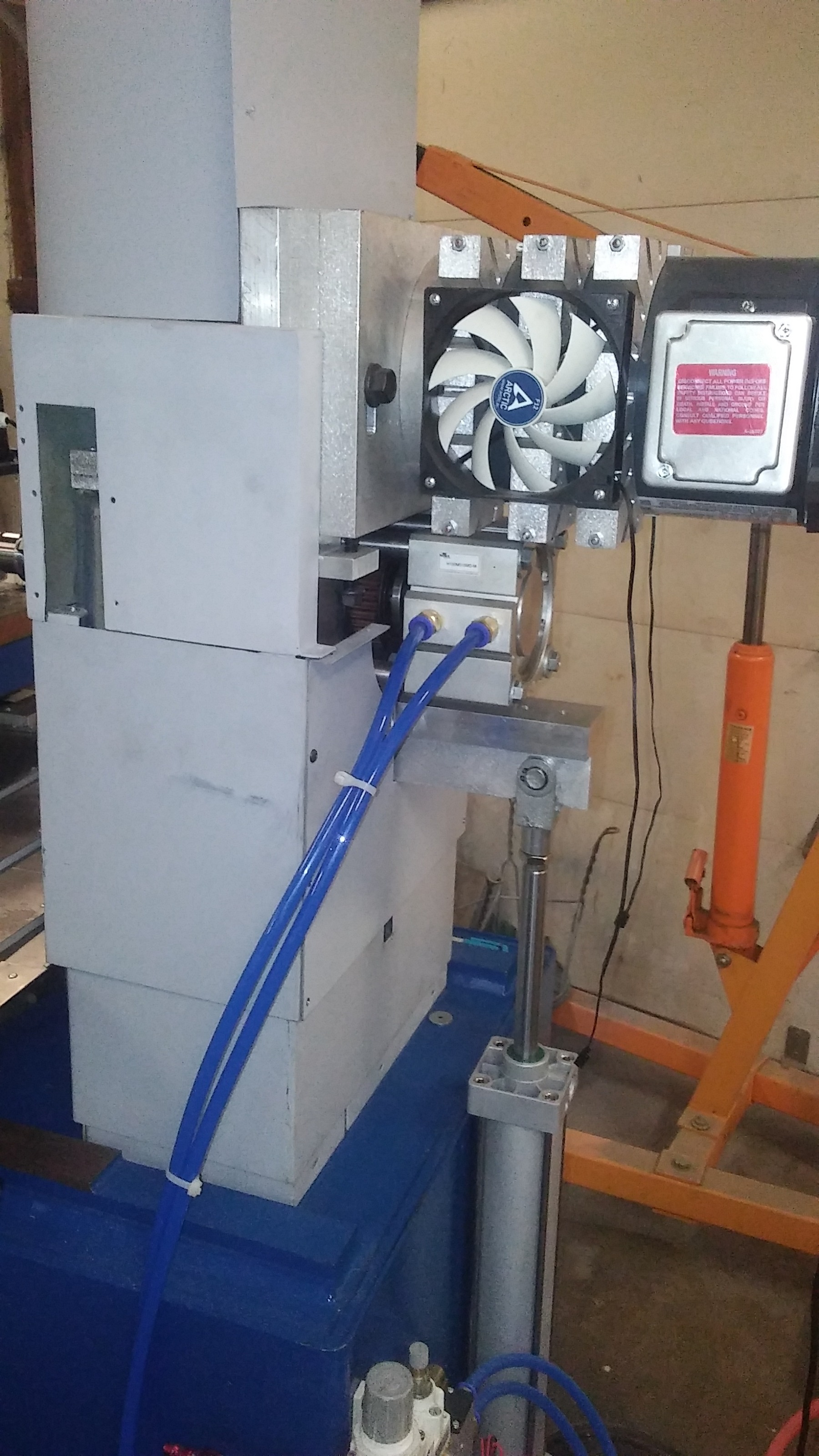

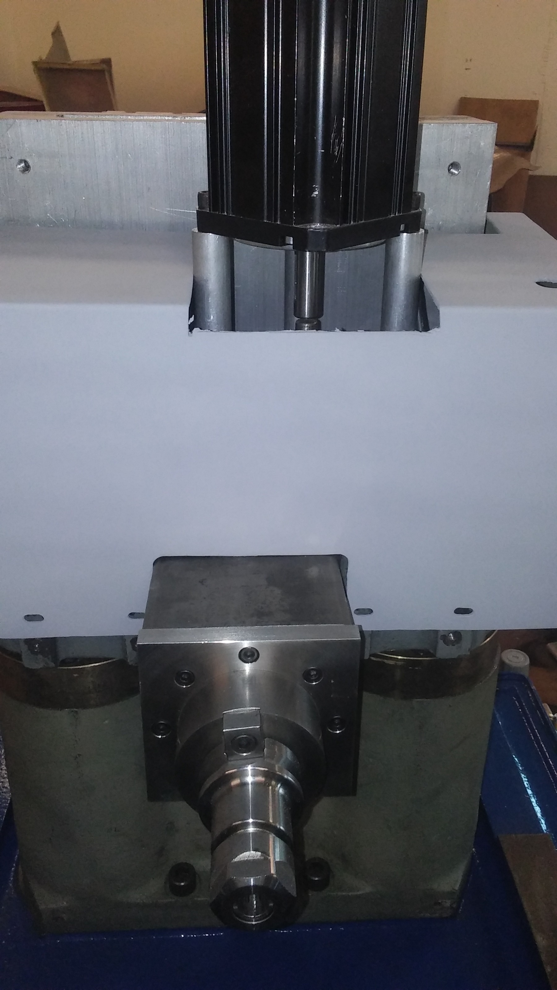

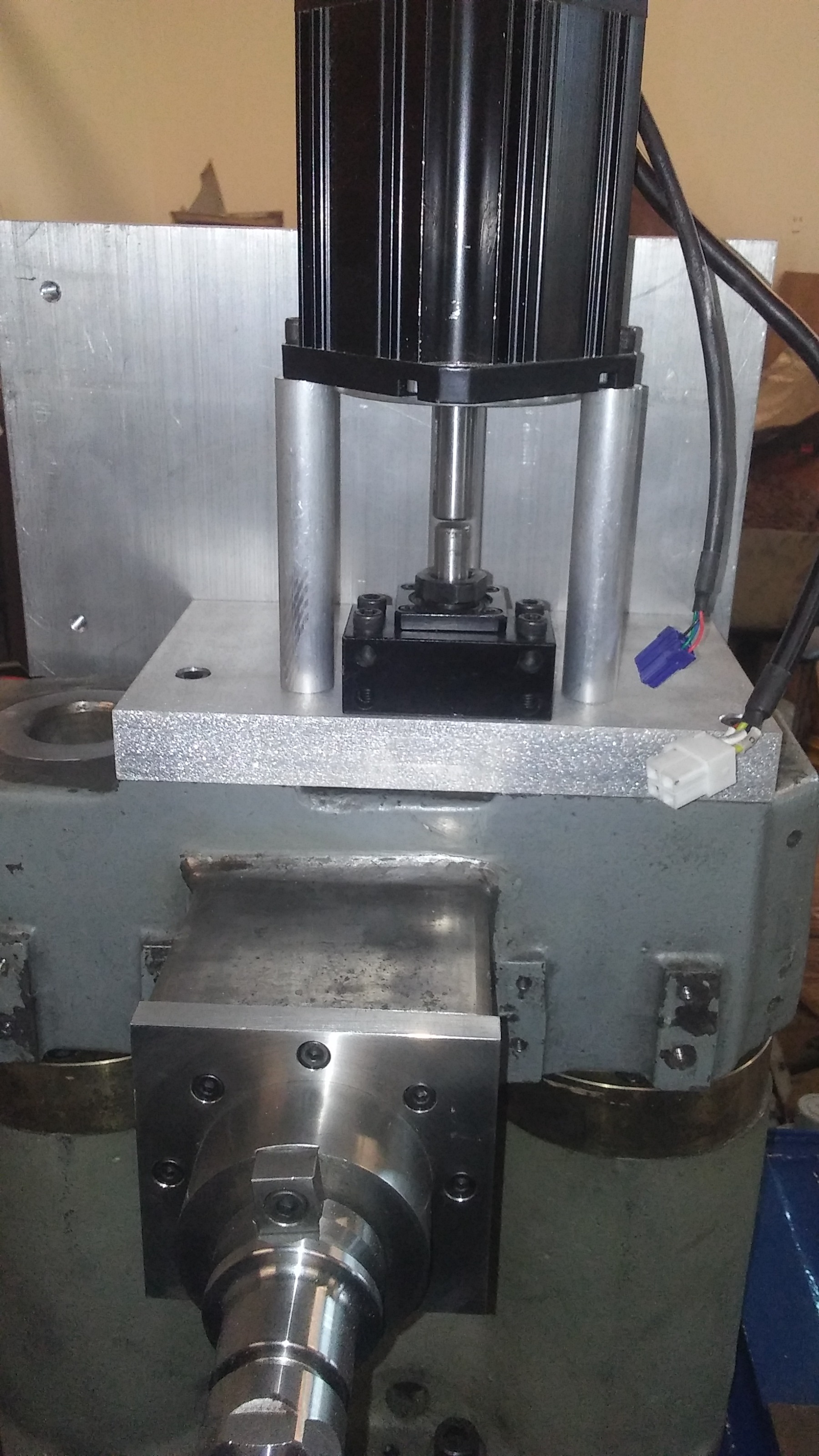

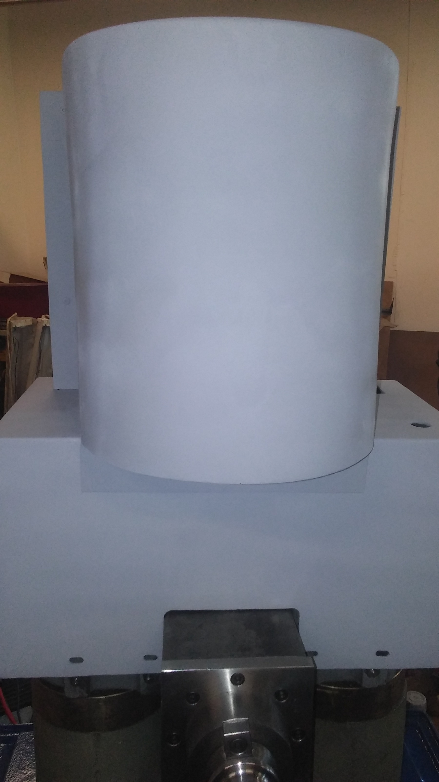

i have had the longer bolts needed to mount the servo for a while but needed to make those stand offs for the motor. i finally got around to making them yesterday. i was not to excited about only having 3 points to mount to but if it works and i can't see it then it won't bug me as much so i came up with a cover to hide it all. out of sight out of mind
i should be able to use the original way covers for the head so that part is figured out i think i just need to strip the rest of the piece down to bare metal so i can give them a fresh coat of paint. what i cleaned up just has some rattle can primer now. i was a little cut happy with the clearance for the motor but the new cover hides all that.

Can you get thick-walled aluminium tube to make one part containing 3 standoffs?
I have done no analysis, but visually that looks too compliant.

those standoffs are 1" diameter with a .330 thru hole so the walls are about as thick as i can get them keeping them basic.
i will have to look tomorrow but i might have a flat motor mount section made or needing some slight modification to make use of the boss on the motor? i will have to look tomorrow. nothing is ever final or complete with this project

It's probably best to try it and see. I don't imagine it will flex enough to cause any actual inaccuracy. My concern is that it might have a torsional resonance at some speeds.

i actually checked this morning to see if i had some extra parts and i have some NEMA 34 flat mounts made from 1/2 Aluminum. The servo's have an 86mm frame size but the boss on the motor for the 86mm fame is actually bigger than a NEMA 34 frame. so i can bore the boss hole to fit the 86mm motor boss and relocate the the mounting hole since the are close to the 86mm mounting hole. the flat mounts have a small taped hole and i only need a trough hole in that part so i have some correction room. i can bore half way into the flat mount and press fit the standoffs into the flat mount. this way it's almost a 1 piece mount. i like this much better since i only have 3 points on the connection.
i probably got ahead of myself on the motor mount and was more tied up making the cover. i know i had a lot of my free day over the weekend used up making the cover and hardly an time making standoffs

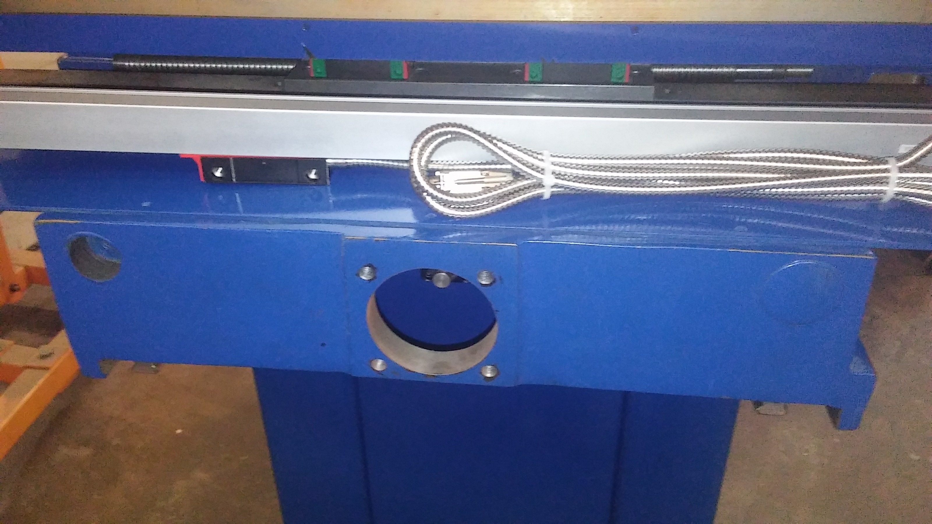

once all this is sorted out i can start mounting the linear scale on the upright. i have one 400mm scale here and just ordered the other two i need today so i should have those next week.

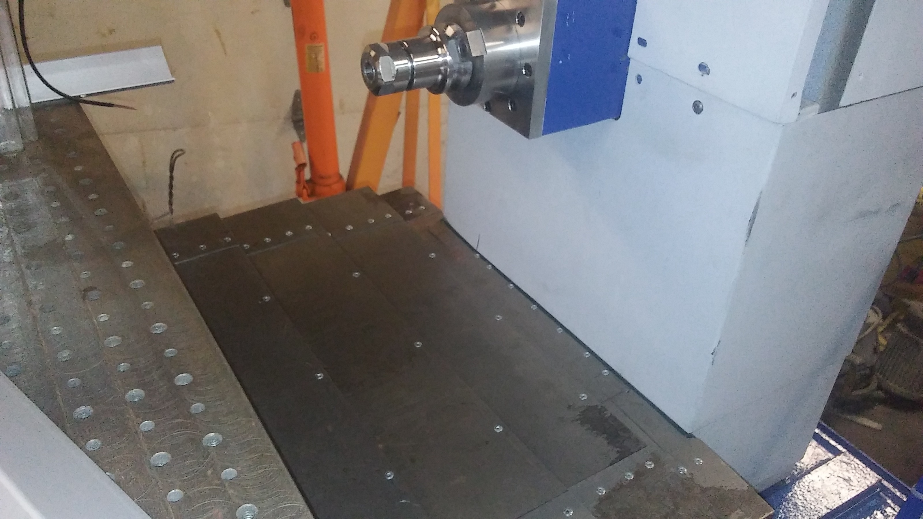

but am getting close to having it all sorted out. i now have all my linear scales and 2 out of three of them should be simple to mount i have to think about the Y axis mounting a bit more. i think i figured out why the old covers were giving me a hard time. i should have taken pictures of things before i tore the machine down. i had one of the cover section on wrong and i need to shorten up the guide rods that i replaced they were hitting the base when the travel was almost all the way down.
as for the chip cover on the back i had just enough sheet metal here to make a crude telescoping cover to keep the chips away from getting under everything. i had to resort to attaching some bent end caps since i had next to nothing here to work with. i still have some things to adjust and maybe add some clearance for but they will do what i need them to do for now. i still need to do some kind of skirt on the table to close it up better but it's getting there slowly

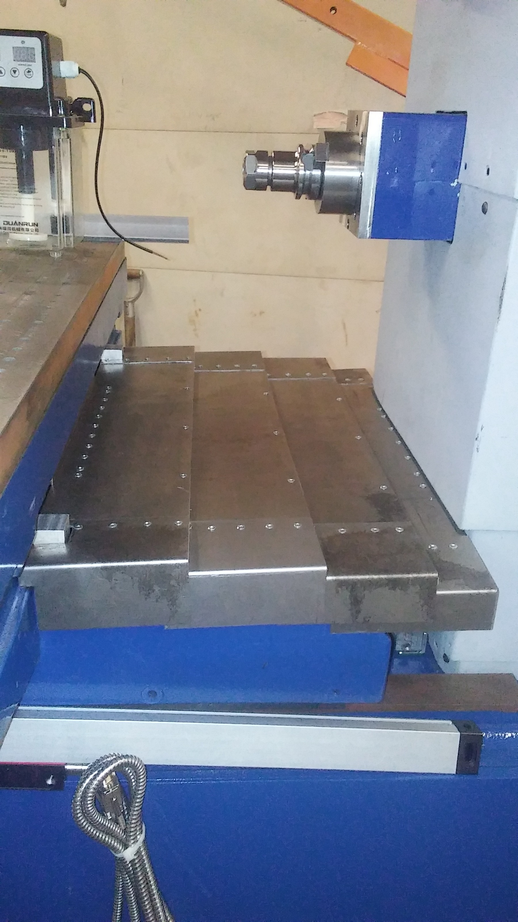

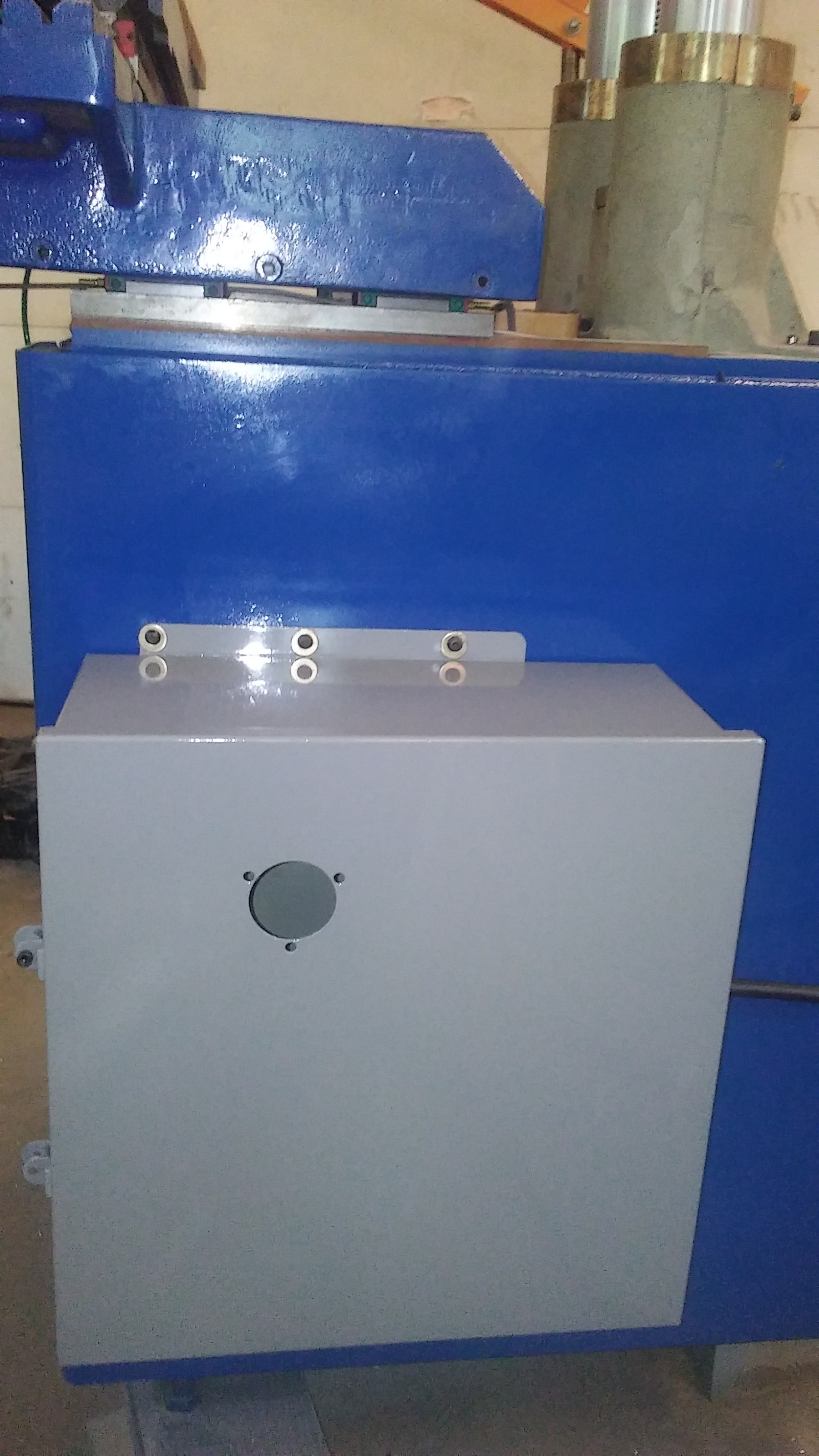

Part of the trouble with the oil point connections was the need for some of it to be able to move with the saddle and table on a few of the connections. all the bearing blocks and ball nuts have a M6 x 1.0 hole for the grease fittings they come with. i had a bunch of 10-32 barbed fittings ( will probably need another pack of 10 ) so what i did was get some brass M6 x 1.0 bolts and tap the head so i could attach the barbed fittings and put around a 3mm through hole in the bolt so the oil can flow through it.

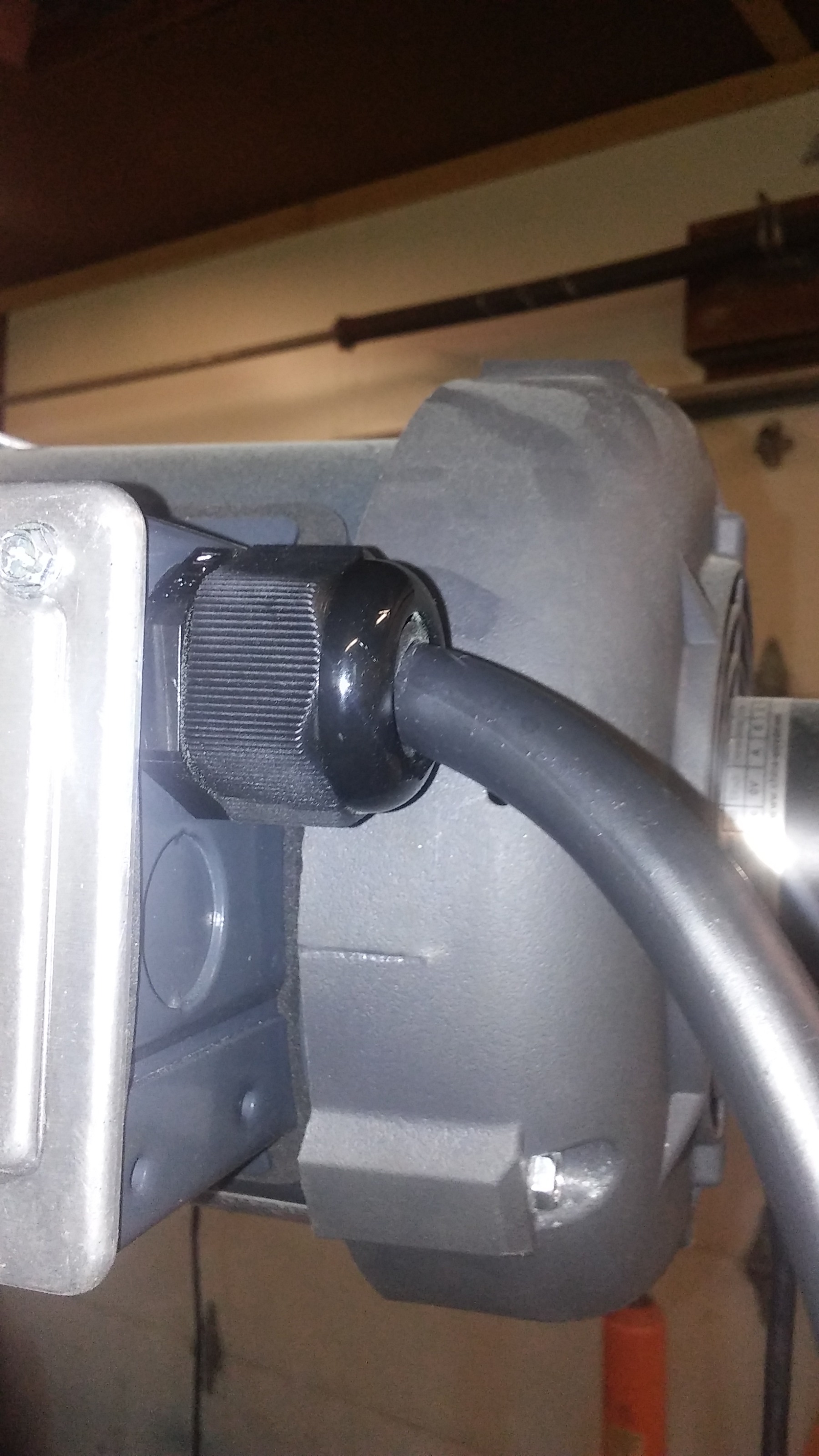

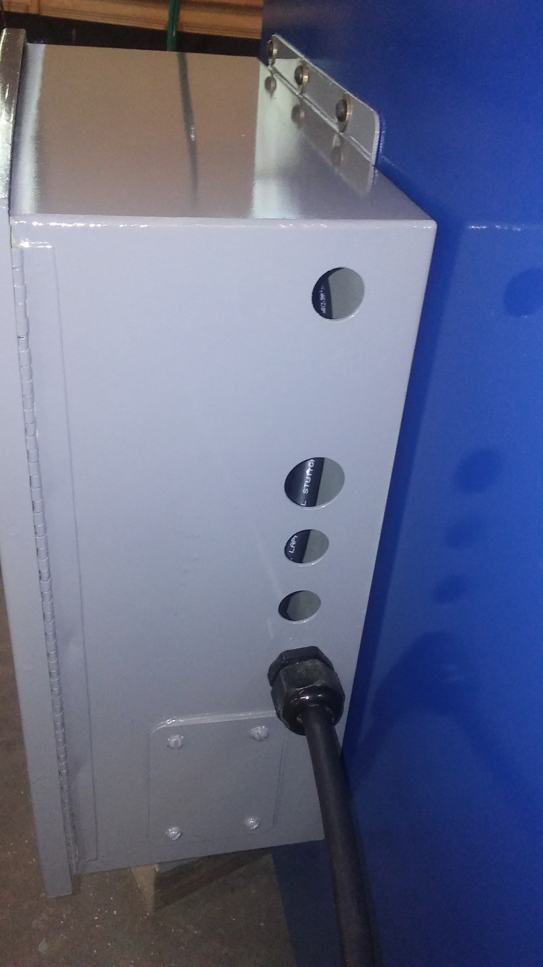

i also gutted the old control box and stripped it down bare and put a fresh coat of paint on it to freshen it up some. I got that back on the machine in the original location and ran my VFD cable into this box. the plan is to use this box for the VFD and probably some DC power supplies to keep it away from the sensitive stuff. the braking resistor i will probably mount out side somewhere since they generate some heat. i'm not sure if it would be wise to mount it in the box?
i have check vales for all my oil points too. i just have to sort that end out still. i was try to use the old manifolds for the oil lines needs but i might have to make something custom since i have more points than what was original.
not much progress but the way oil pump in mounted and the lines for the head axis was already done so i reused that part and it's hooked up. the rest i will most likely end up making taking a guess. but here is a few pictures. everyone like pictures

Those are original HiWin HGH20 carriages !
