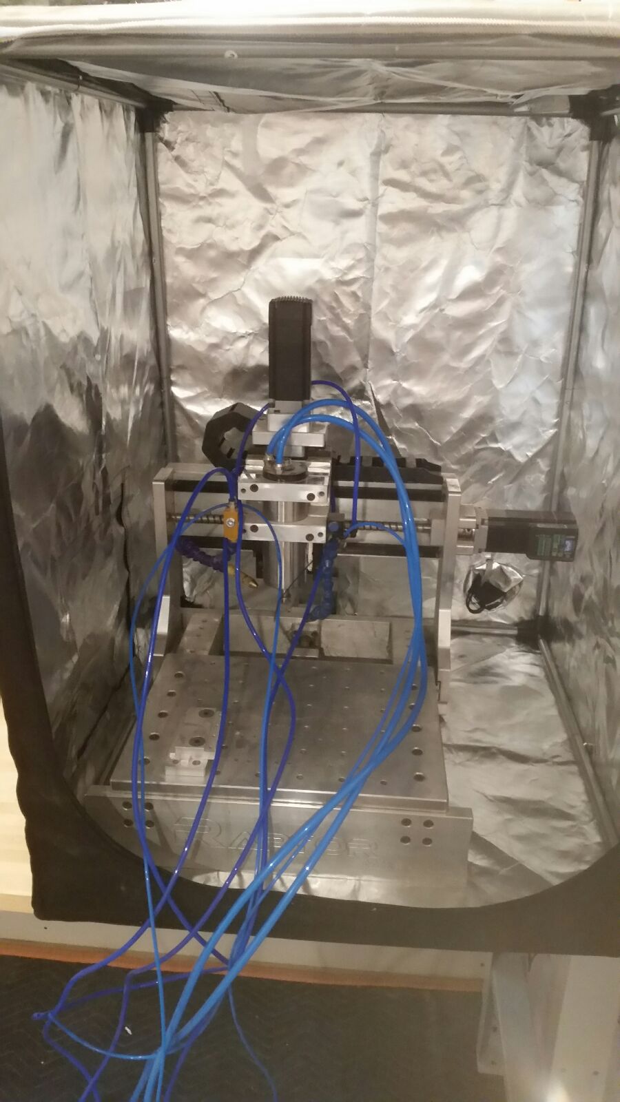

Aaaand we're back.
Got a new bench, and an enclosure.
Enclosure it pretty slick, it is a 3d printer enclosure from creality, but in reality it is a common grow op tent. Pretty neat. its water and dust proof, and has little velcro pass throughs for wiring, and even a round one that could be for a dust collector.

Vroom

its already drilled, put the support block on that badboy. if end isnt stepped, just change the bearing. you are gonna get screw whip. really nice unit though. I recommend getting it anodized before you get to far ahead, makes such a difference.

"its already drilled, put the support block on that badboy"
wrong pattern for the vises on the side.
"if end isnt stepped, just change the bearing. you are gonna get screw whip. "
Nah. this is within spec of the screw. They can run up to 5000rpm like this.
"I recommend getting it anodized before you get to far ahead, makes such a differenc"
Meh, no point. if you look earlier in this thread, it is going to get some heavy modifications soon. i'll anodise it when its actually done
