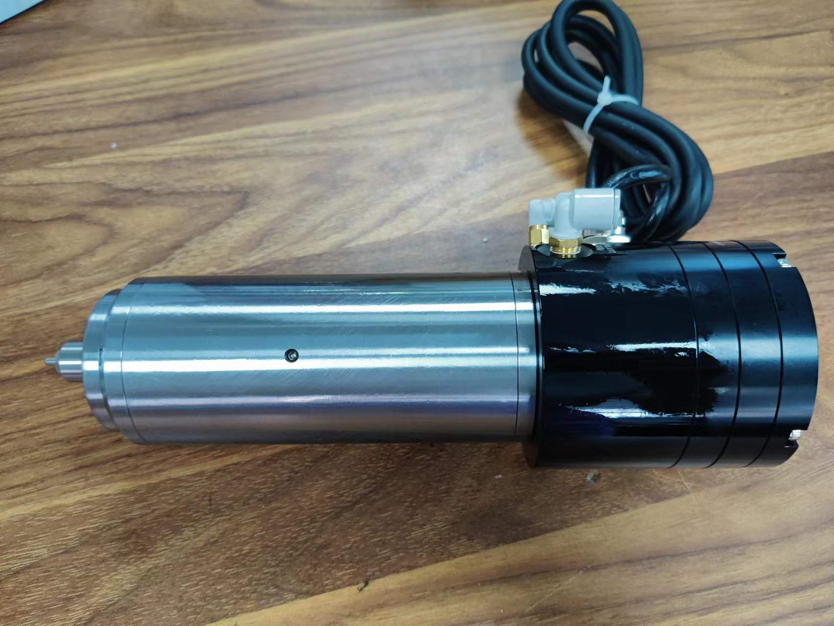

Ordered a little 3d probe. Also ordering a new spindle which can magically make one tool into another...
Seems to me I should change to probe basic to make the most out of this. Need to read up on how to install that. Looks like I need to install a different linux version maybe? Any insights would be appreciated?

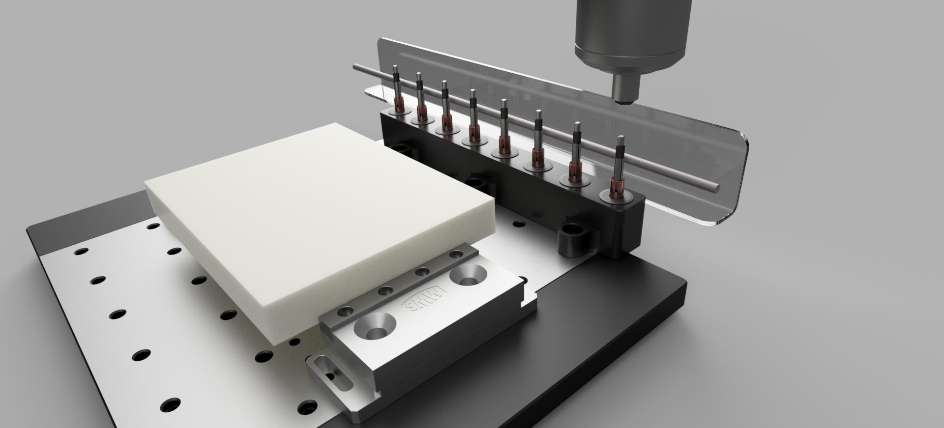

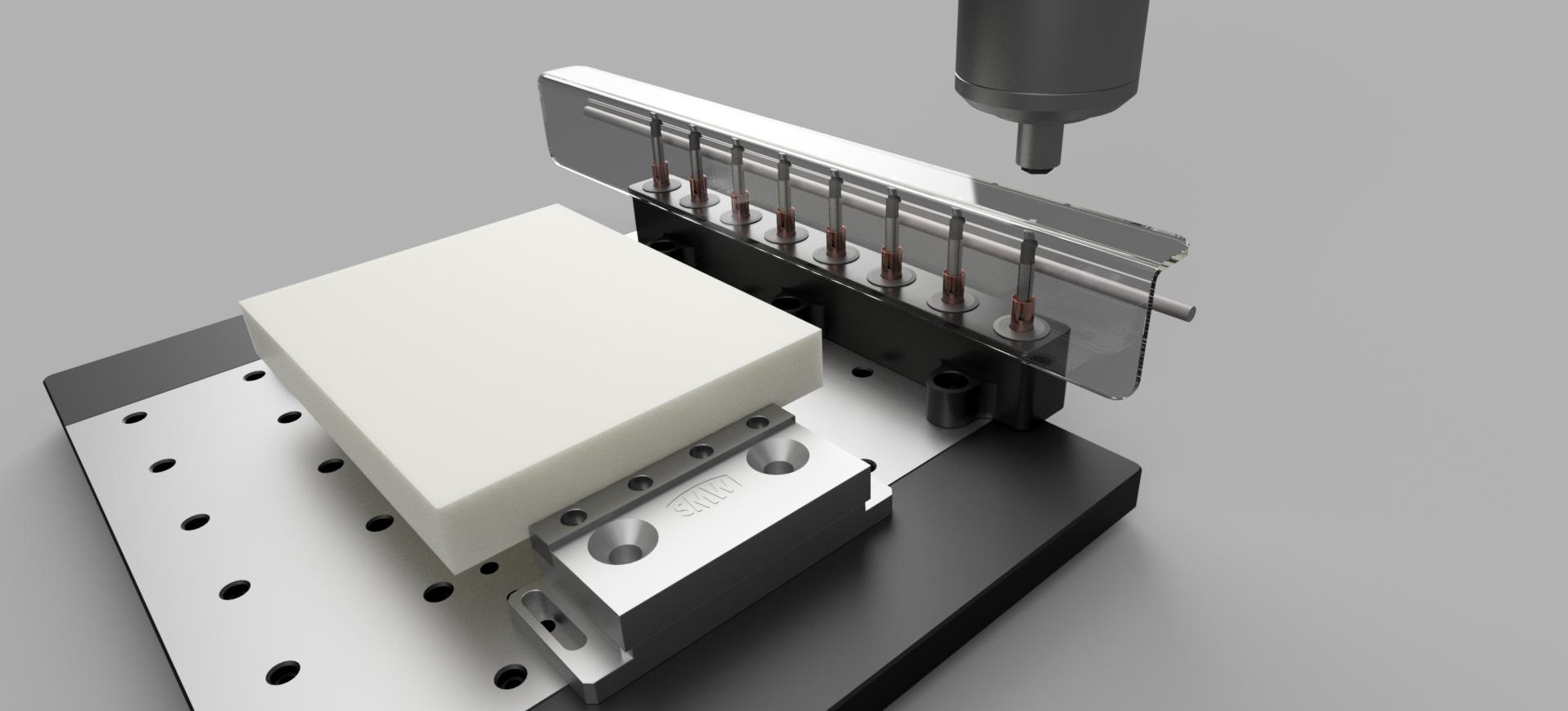

Trying to think up a tool magazine cover method. with this one, i need the rod the cover is attached to to spin 180 degrees. Does just using a stepper axis seem like the easiest way. Probably with a switch to tell it it is open. Everything else (arduinos with rc servos, air pistons, etc) seem needlessly complex.

A while back i saw on youtube a guy made the lid open and close by using 2 bearings on both sides of the gantry to push levers on both sides, and those open the lid.
That saved a a bit of usable travel and worked perfectly well.

That mechanism is very complicated. I thought of those already cause the look so cool, but, i think for me in the space i have a little motor is best.
