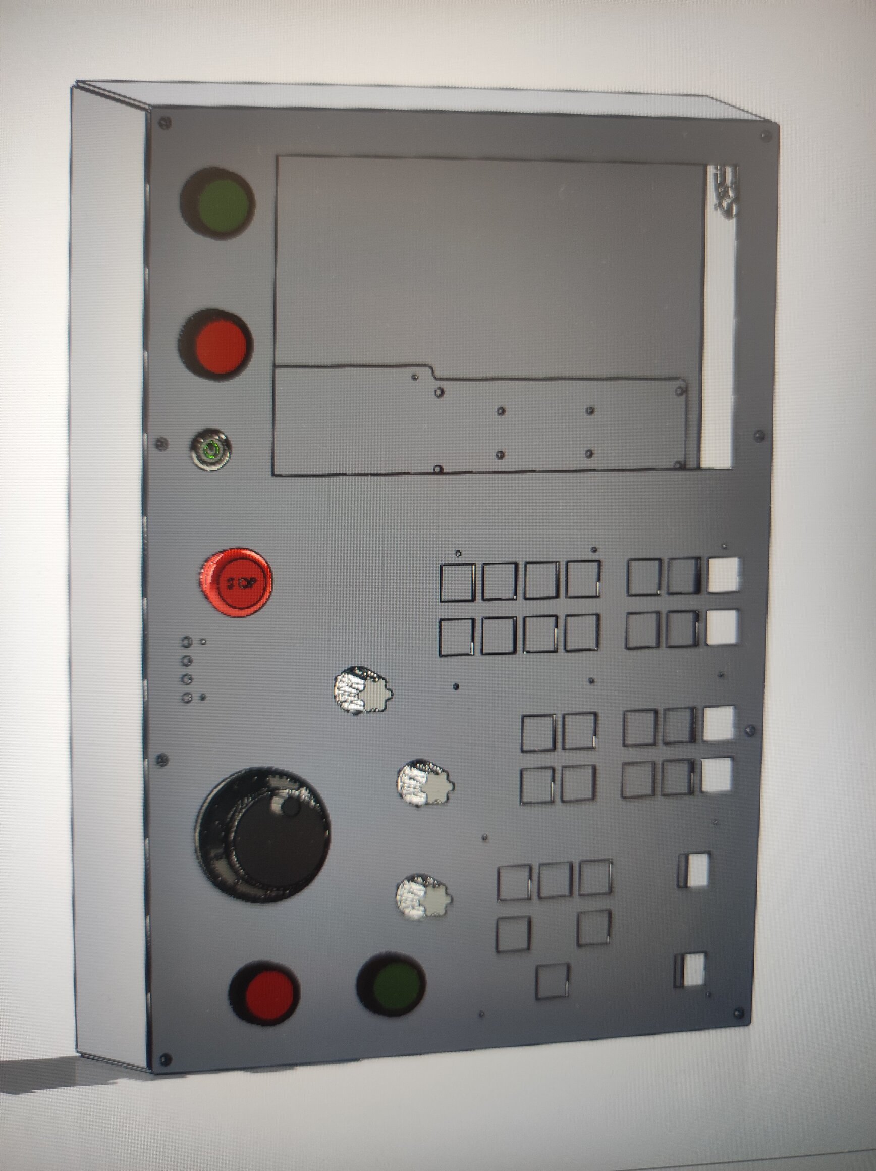

Reading up on using keystrokes i see a number of potential issues.
Gave me a thought. Still have the RP2040 as a usb keyboard, but add a modifier that can alternately send certain key presses out to the mesa. 2 keyboards in one if that makes sense. No modifier, keys map like a regular keyboard (with text written on them for that). Modifier engaged and special functions go to the mesa either single or in a matrix. Modifier On is probably default, and if you need to type etc, you engage it. Would probably want to remove/disable the default axis key mapping to functions if possible.
So the mesa doesn't need to deal with dumb stuff taking pins like qwerty letters. But it can deal in hardware with M functions, Jogging, etc. RP2040 IO is 3.3v, will need a level shifter.
Hmmm.
Hmmm.

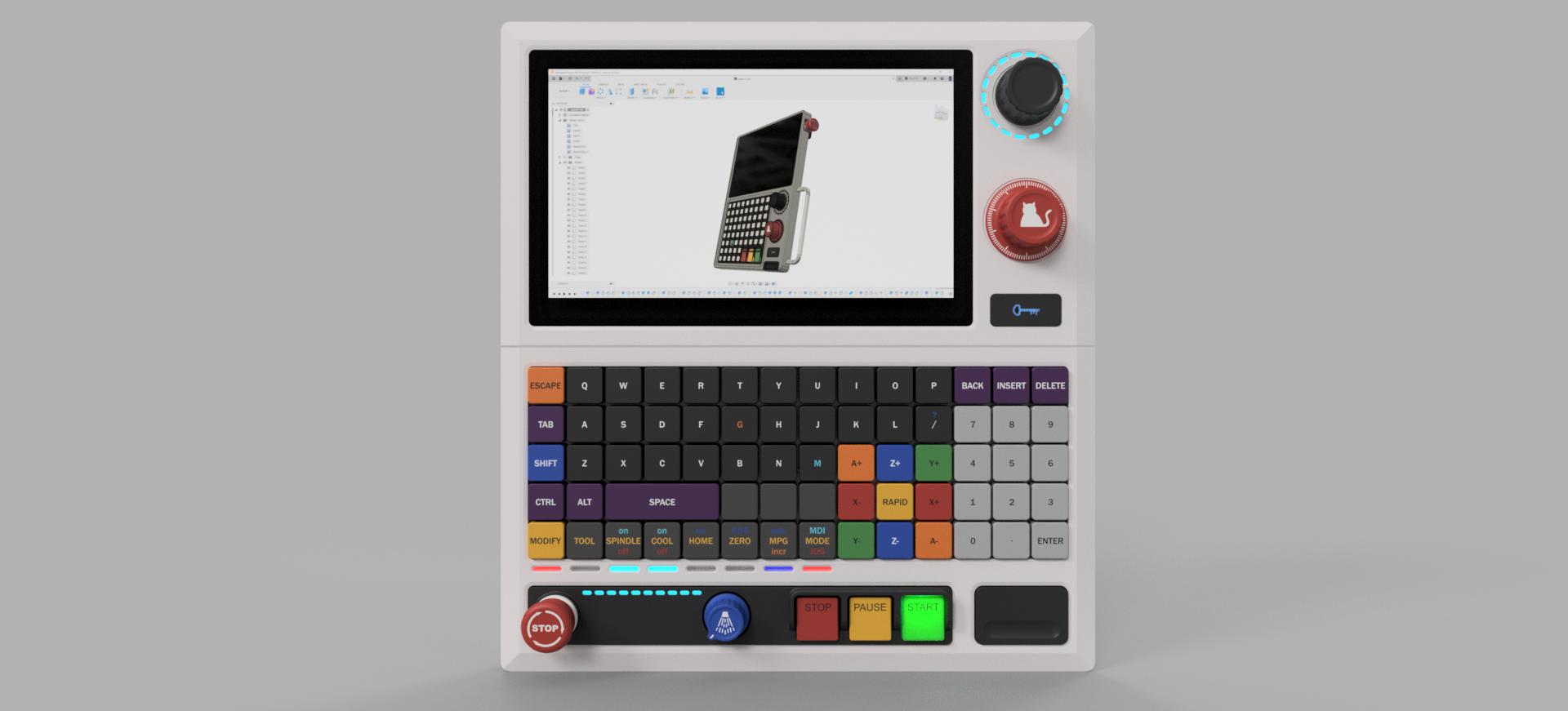

- ihavenofish
- Posts: 1029
- Thank you received: 286
04 Sep 2023 19:42 #279873
by ihavenofish
Replied by ihavenofish on topic Mini wannabe datron build
Cool!
The keyboard will be a custom pcb that will take cherry switches. The controller is a rp2040 board that will socket in. this will take care of the usb side, as well as "funneling" keystrokes to the mesa.
The LED's are still a mystery as they really need 2 way communication. Torque isnt too hard i think. Read the torque from the drive to the RP2040, translate that into pretty colours on the leds, and trip a pin on the mesa for overload warnings etc and flash leds red etc.
The rest is a bit tricky. if you change mdi mode for example, how does the keyboard know to light that led the right colour. Likewise the override ring. It needs to get that info back from linuxcnc in the form of a number cause all the dial is doing is incrementing.
The global "stale" leds are easier cause they can just be 2 or 3 pins, one for "error", one for "running" and one for "idle" (or maybe a lack of the other 2 means idle). That led is not on the control itself. it is a 50mm long strip i have that will be up high on the door.
I found a new 8" lcd for it. so it got 1 row of keys smaller. I don;t know if i want the lower panel to be smaller though as the key layout is working well.
Pondering haha.

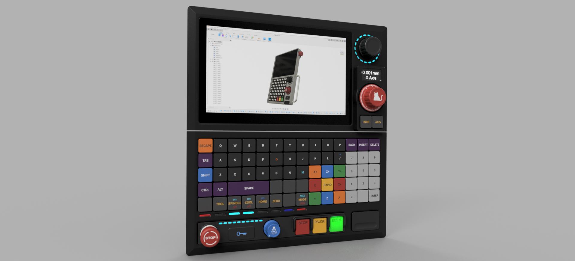

04 Sep 2023 20:54 - 04 Sep 2023 21:02 #279884
by ihavenofish
ok, new 8" screen. keyboard is the same, it just extends to the flange which is not a big deal.
There is nor enough room really on the top now for the mpg features, so it is a fully separate unit. it is still controlled by the rp2040, so it has no "brain" inside of it.
If anyone is wondering why the size constraints and why its 2 pieces. it is partly cause that's all the width there is on the cabinet, and partly because that's the size that can fit in my vise jaws for milling.
I will be using a big plate of scrap 25mm mic6, so that is dictating some things as well.

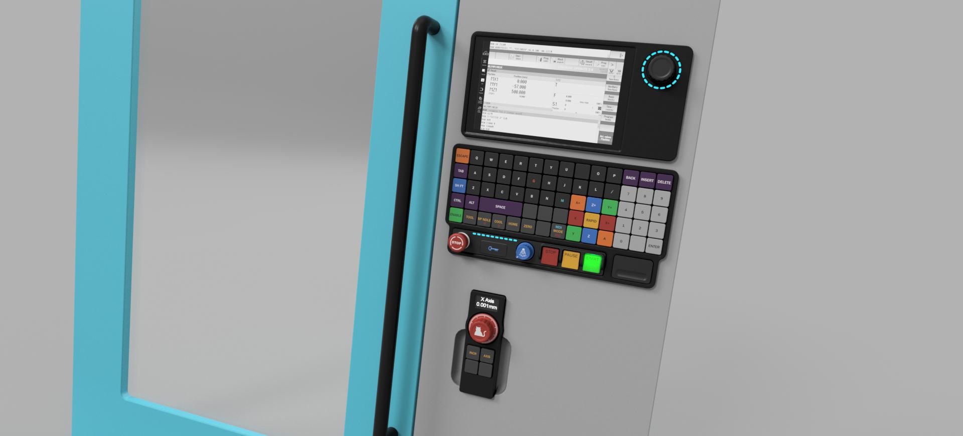

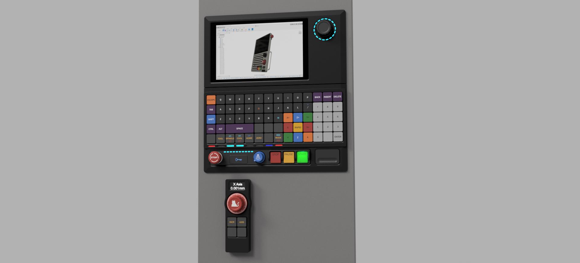

I think we are on the same page. multiswitch on the penda would cycle. on the spindle button it would cycle m3/m5 (or with shift, m5/m5) etc. So the lighter grey lower buttons are "hardware". in the RP2040 you could map whatever keys you want to bypass to hardware. basically all keys go in, and up to 10 maybe can go back out (only so many pins on the rp2040 and we need 20 for kb input and 1 for led's and a few for the torque inputs, alarms, etc).
Latest refinements. Working out how to attach it to the cabinet - I think in the end it will just be on the surface with a gasket and a non precision hole behind it for access/wiring. The back of the panel will be open. so you open the right side cabinet door and have easy access all the terminals and wires. This is basically how the brother panel is. It is basically a cabinet door that opens. Mine's just made of mdf.
Also been pasting on various UI's at real life scale to see what is readable. The Probe Basic ui is completely unusable on anything smaller than maybe 17". The siemens 808 ui unsurprisingly works well at 8". The 840 ui (in the render) seems optimised for 10".
