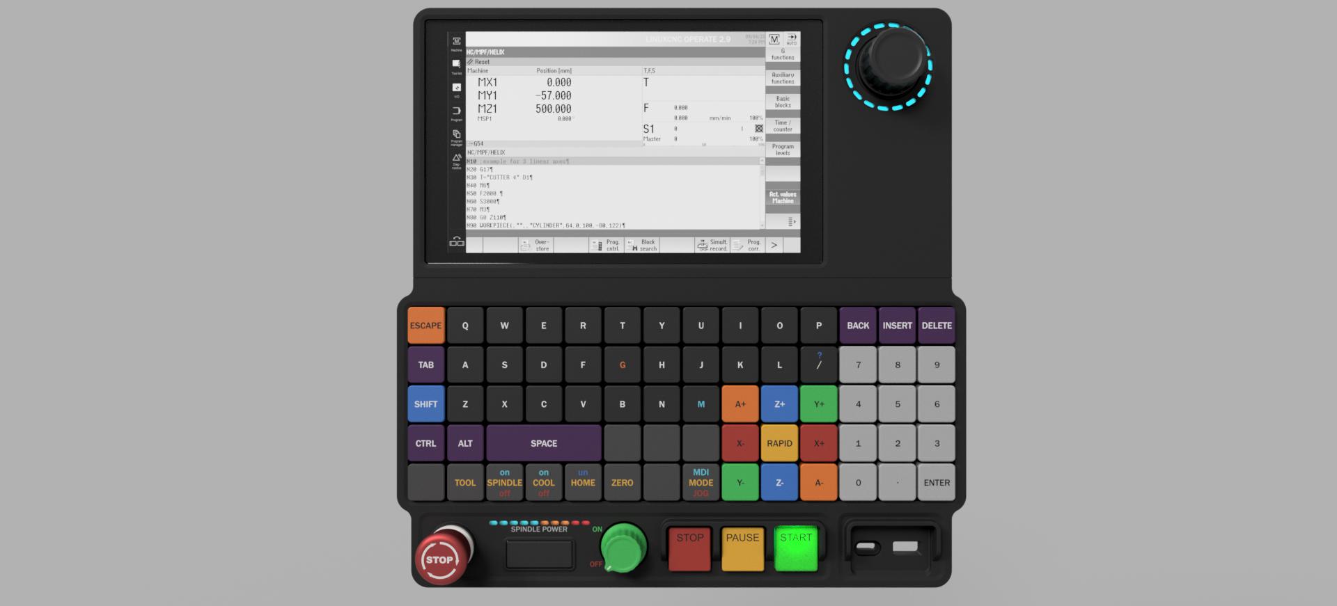

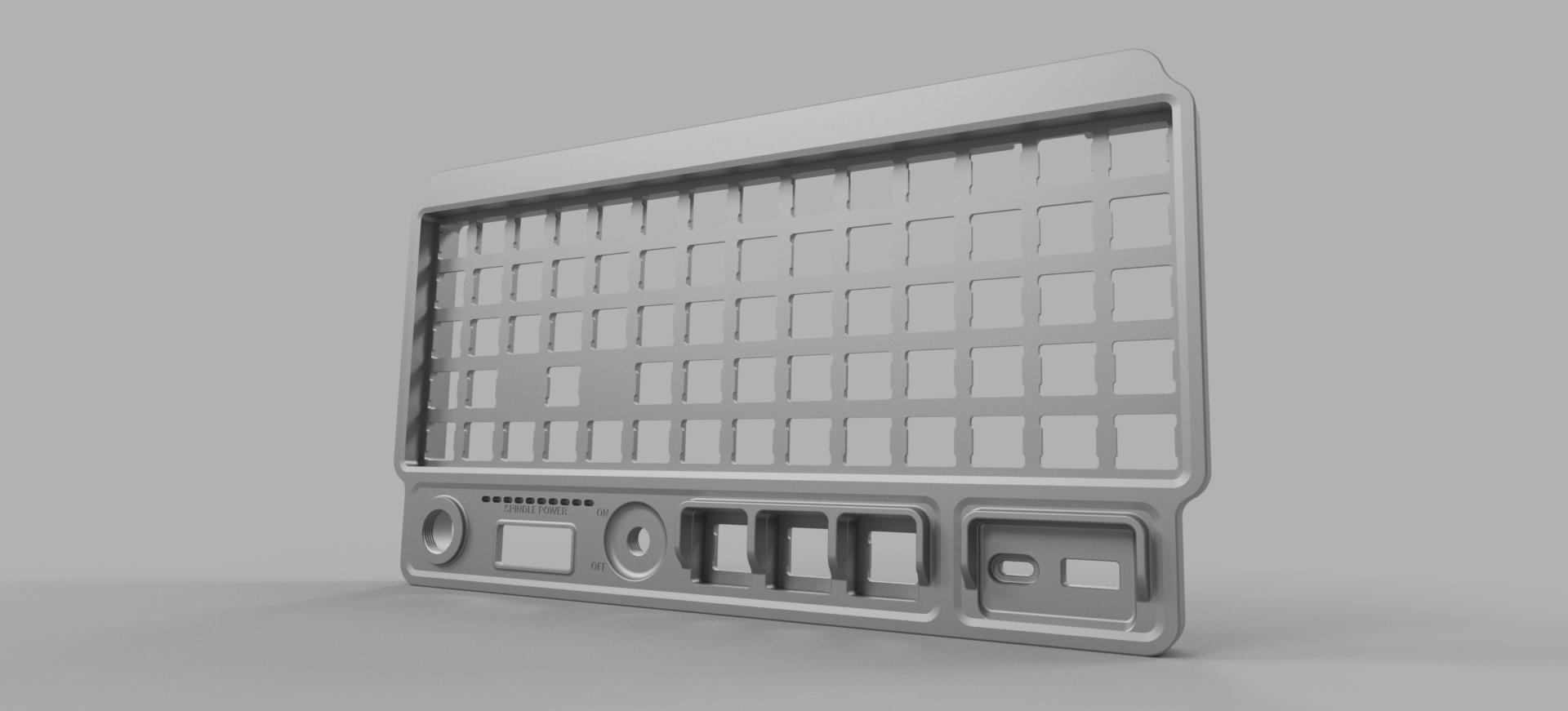

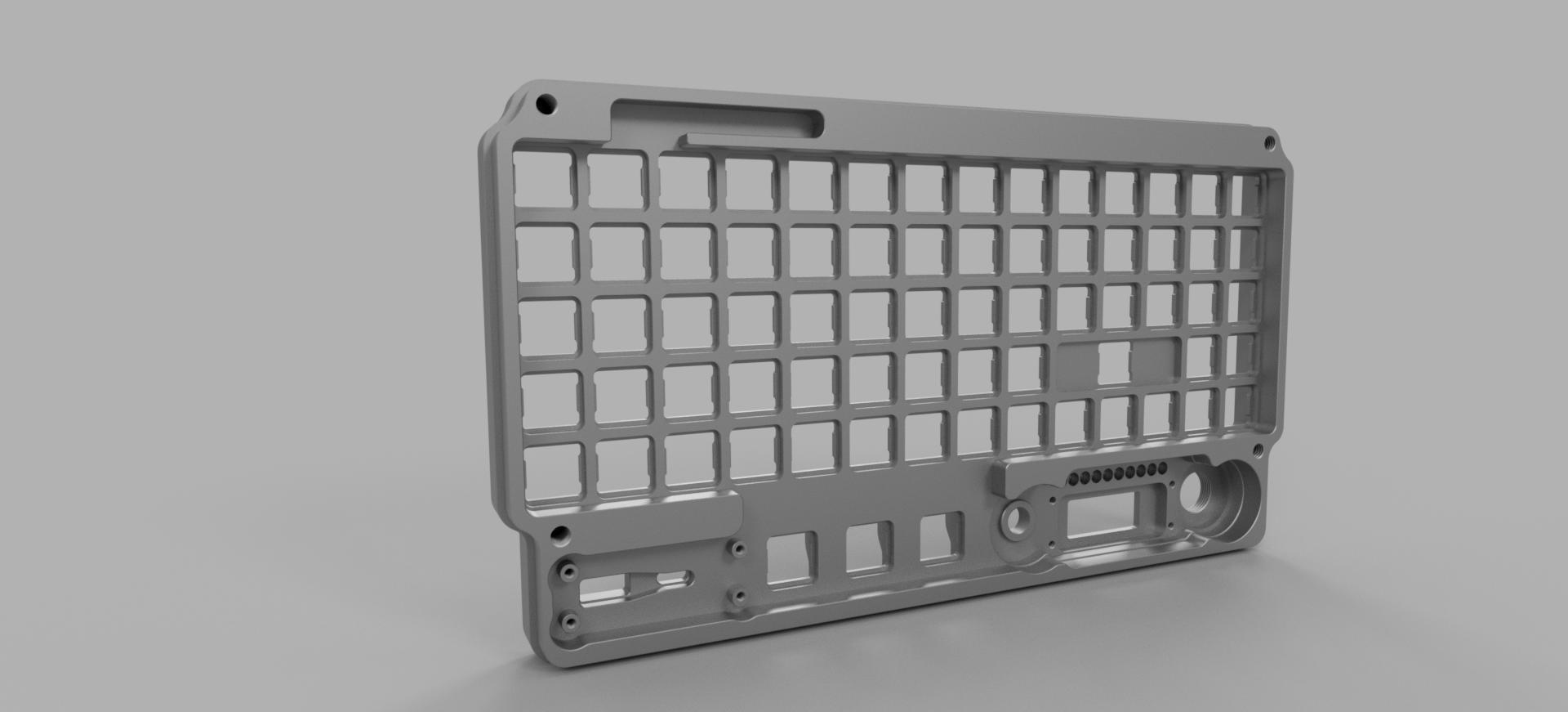

"Assembled". I found an led strip with a 5mm pitch that can do the torque meter and can curl around for the override dial. ill make a mirror polished bit of aluminium on the case back to reflect it outward. the rp2040 board, keyboard driver and io expander along with a usb hub all go under the override dial area. that is why it is left empty although it might be nice to have another little oled there to display tool number and other things.
For scale, the keyboard part is now 152mm x 278mm. Fits easily in the saunders vise and inside the machine travel. Ive been careful to not have any cuts deeper than 12mm. 4mm end mills are optimal on my machine, and the DLC ones I have are 12mm flute. I have some 6mm, but I don't see them having any benefit with 0.26NM torque.
Once this is done I need to raid the corian samples to make the keycaps. 8 colours! haha.

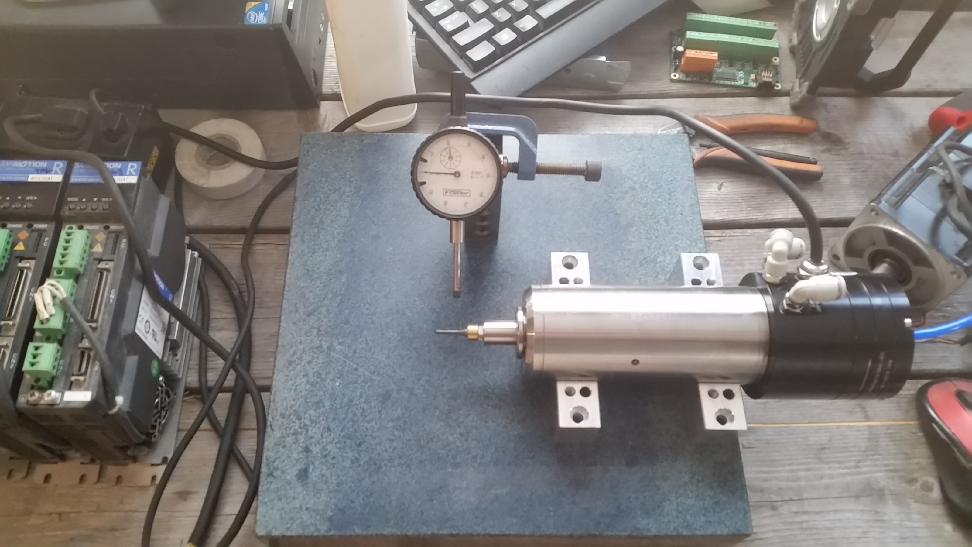

So this works now
It is on a 1.5kw "MS300" house brand drive from automation direct. I give them a gold star for both delivery (less than 24 hours!) and phone support. Price was pretty good too.
Only drawback is we are still limited to 36000rpm like the last spindle. Eventually I will source an economical non mystery meat 1000hz drive.
Now I need to get it onto the machine. It needs a 6.35mm spacer behind the clamp cause the air cylinder is hitting the z servo. Bough some ground 4140, just need to just and drill it now.

Good timing - I've got a couple of surplus air bearing spindles laying around and I've been researching drives lately. The OEM stuff from Precise or Fisher are priced insane, even used.
I've not seen an "MS300" drive from AD, but the Delta MS300 series can do 1500hz in the high-speed version. Looks for model numbers ending in "SHA" instead of "SAA".
A 2hp 1p to 3p version for your spindle should be VFD7A5MS21AFSHA.
Replied by spumco on topic Mini wannabe datron build
Very sweet.
