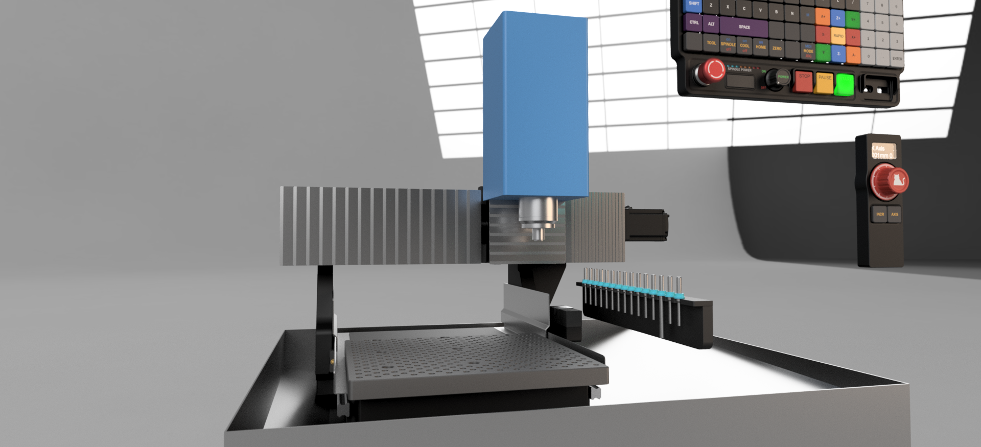

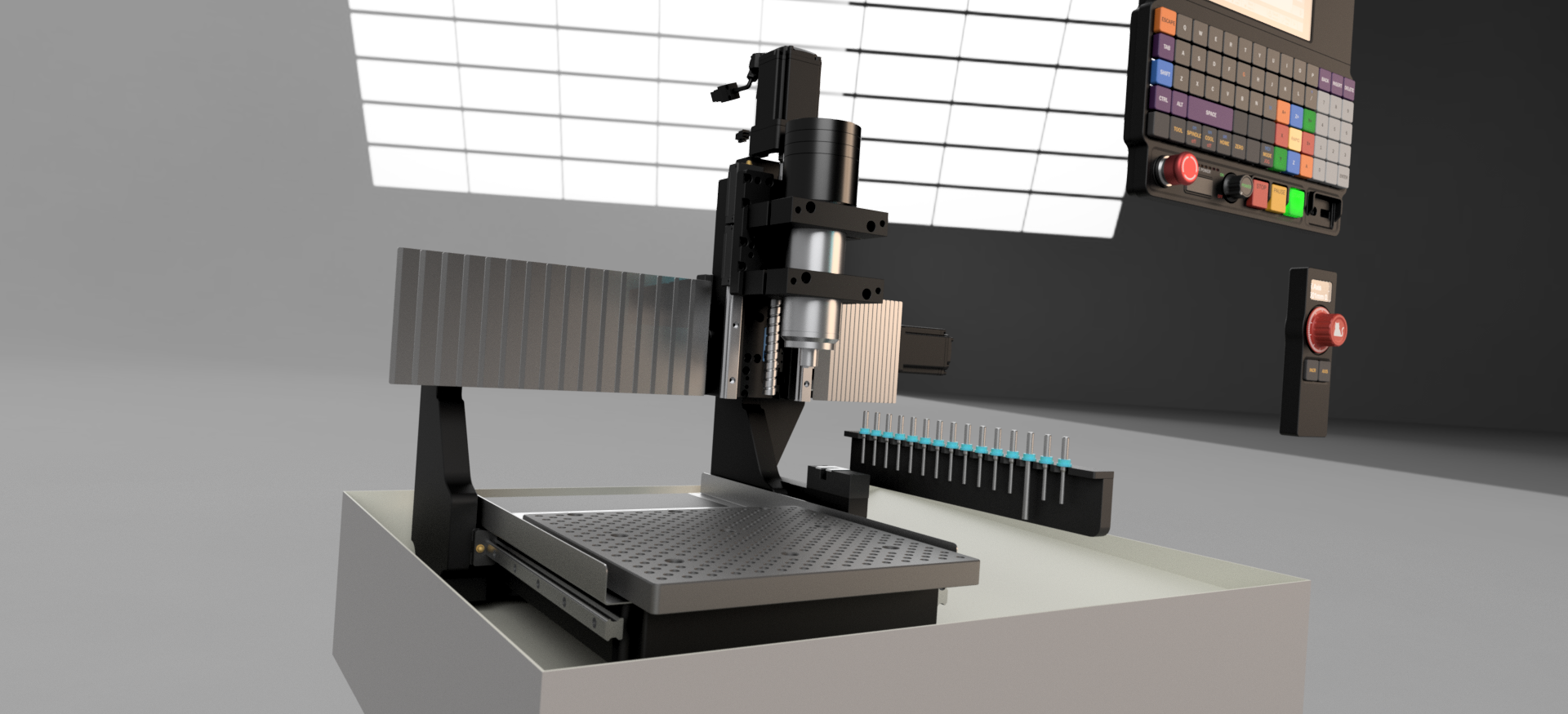

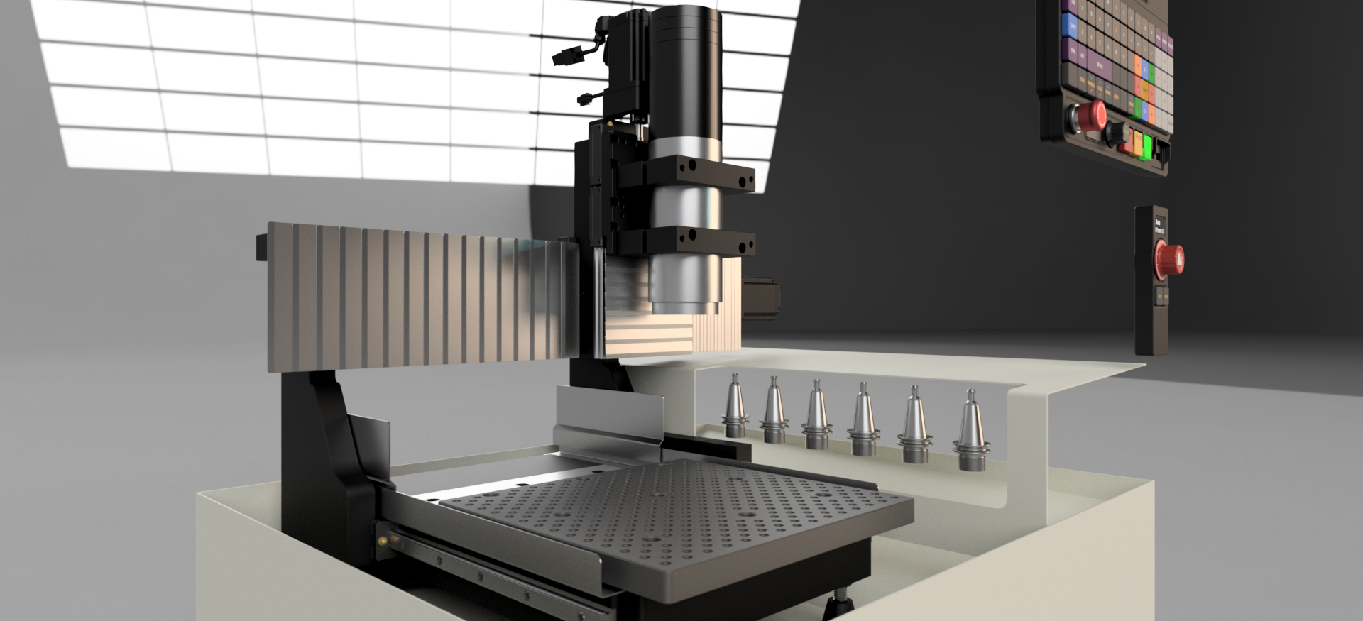

Very cool machine.

Replied by ihavenofish on topic Mini wannabe datron build
My spindle has caused a big issue. I wanted my 60000rpm spindle for micro milling etc. But it turns out the drives above 599hz are basically banned now.
So now i have to either get the same spindle custom wound to 36000rpm, or alternatively go to a larger 30000rpm iso20 spindle which has a lot of plusses but is really kinda too big for the machine.
Hmmmm
On the bright side I did get the existing spindle behaving since the steel cutting video. It doesn't bog down anymore. Gonna do another nifty video cutting 0-1 steel next week. Waiting on cutters.
Hmmmm

The spindle i have no is DECI brand, although i am working with jianken on the the one we will use for the final machine. I need to order 5 or more to do modifications though beyond the simple winding change to 36k. They do an iso10 variant, its a few hundred dollars extra.
Your in aus right? you can buy 1000hz drives there still, but they couldn't be sent here and even if i "smuggled" one in, i could not then resell the machine with it anyway. So annoying.
There seems to be a possible exemption on PMSM spindle "kits" like a jaeger because the drive is only usable with that spindle, and not generic (so you couldn't run a centrifuge with it.
So annoying, but i think the smartest thing to do here for customers is to restrict it to 36k. 36krpm is still pretty amazing for micro cutting.
i am looking for 2 "guinea pig" buyers... nudge nudge.
