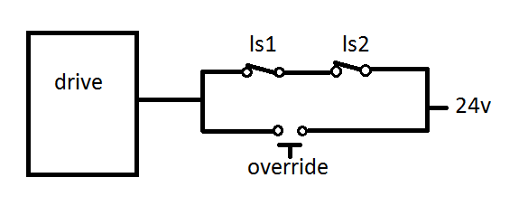

Yes Todd, thanks, thats what I was thinking also however...... the 24 is com.
I just spoke with the prior owner and he said they never had an override button, they just jogged off the axis. He shut power off the machine and the Z dropped on him overnight also everynight.
Bizarre, since if they ever went the wrong way bad things would have happened.
I am contemplating on what to do, but I have another issue I will make another post here in a sec.

If it worries you that the machine may be jogged the wrong way when trying to get off the hard limit. It would be worth your time and effort to wire the + and - limits separately on thier own inputs into Linuxcnc. I am pretty sure that Linuxcnc will restrict movement in the direction of the sensed limit and only allow the machine to be jogged away from it.
As to your jogging feed rate question, I don't know. What are your settings in your ini file?

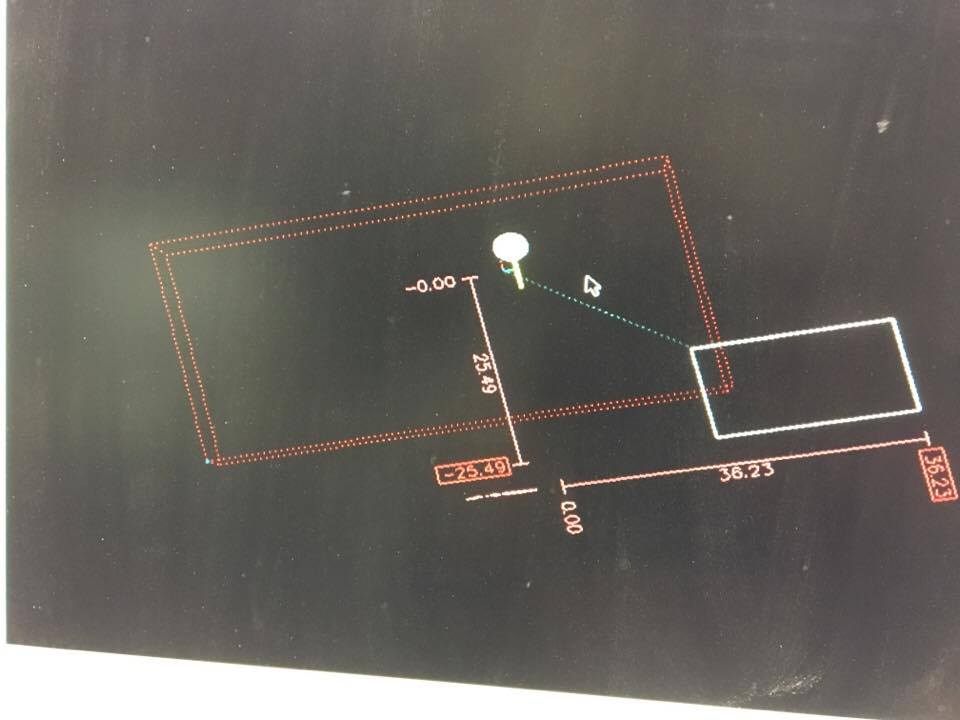

Screenshot?
Was it homed before you did that? Does the tool on screen also move in the right direction? Do you have any offsets active? Where is the Y axis home in the ini? It ahould be set at 0, usualy.
- Posts: 21900
- Thank you received: 7465
08 Feb 2017 06:31 #87512
Replied by tommylight on topic Biesse Rover 346 Retrofit
Definitely looks like something in the ini, Y 0 should be down, near the X 0.
How did you manage that???
- Posts: 19896
- Thank you received: 4648
08 Feb 2017 10:24 #87519
Replied by andypugh on topic Biesse Rover 346 Retrofit
I actually think this might be a misunderstanding.
XYZ positive and negative are all from the point of view of the tool relative to the work.
