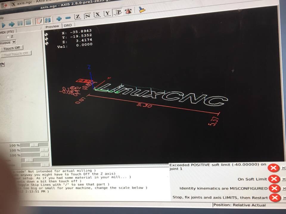

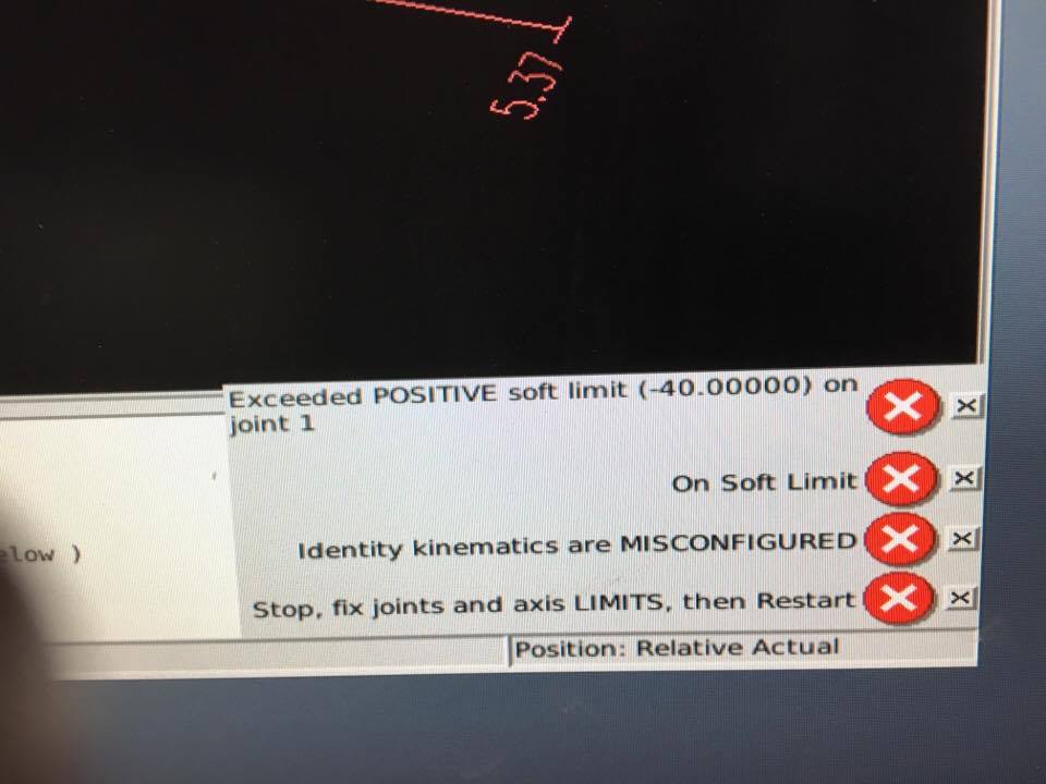

OK, I am pulling my hair out now....... and I have none....
I cant get it to home properly. Can you check my ini? I tried all the possibilities. I have the UCS ok now, X,Y 0,0 top left.
I am getting these errors. I attached my ini file.
Looking at it again, it thinks it is at the other end of the Y. -40 is soft limit away from the home, but it LinuxCNC is thinking opposite.
What have I got backwards?

Replied by Todd Zuercher on topic Biesse Rover 346 Retrofit
Just change this for your Y and joint1
MIN_LIMIT =-40.0 (was 0.01)
MAX_LIMIT = 0.01 (was -40.0)

08 Feb 2017 16:59 #87587
by bevins
I did that and swapped the sign for searching and all is well. I dont understand what happened but it is all fixed. I think I was changing things and changing the required mating pair that needed it. Anyway all is good.
Ran some Gcode and it is working.
On to the spindle/inverter and switching spindles.....ARRKKK...... It doesnt get any easier from here....lol

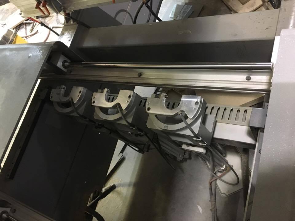

Whats left to do is the following:
1. Spindle / inverter and switching (3 spindles on this head)
2. Tool Changer
3. Aggregate and horizontal and boring motors
4. Logic for the pods and accessories.

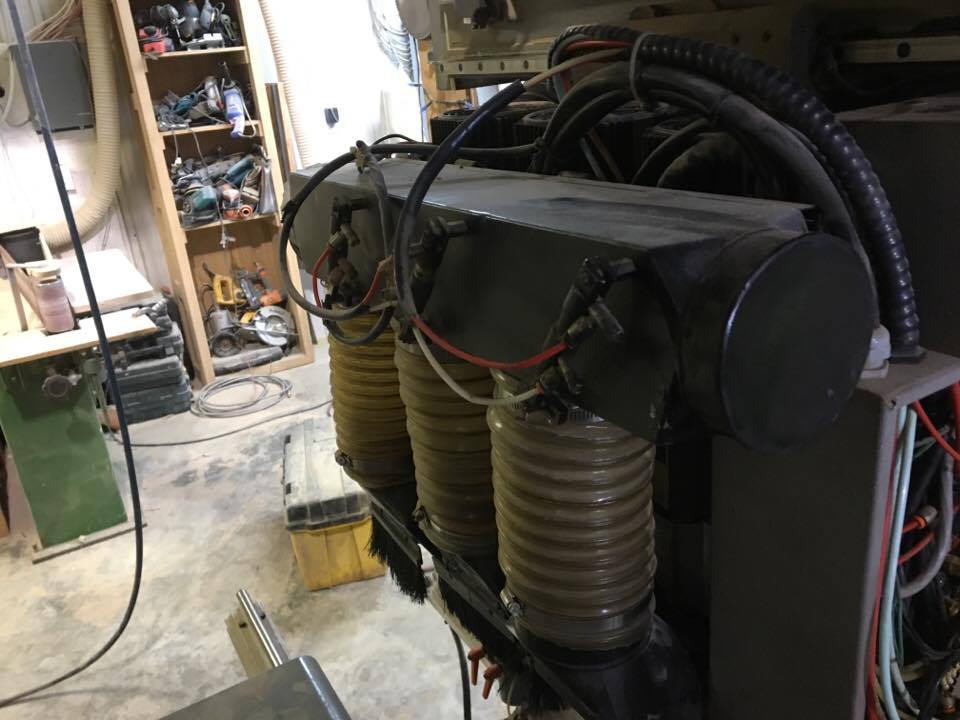

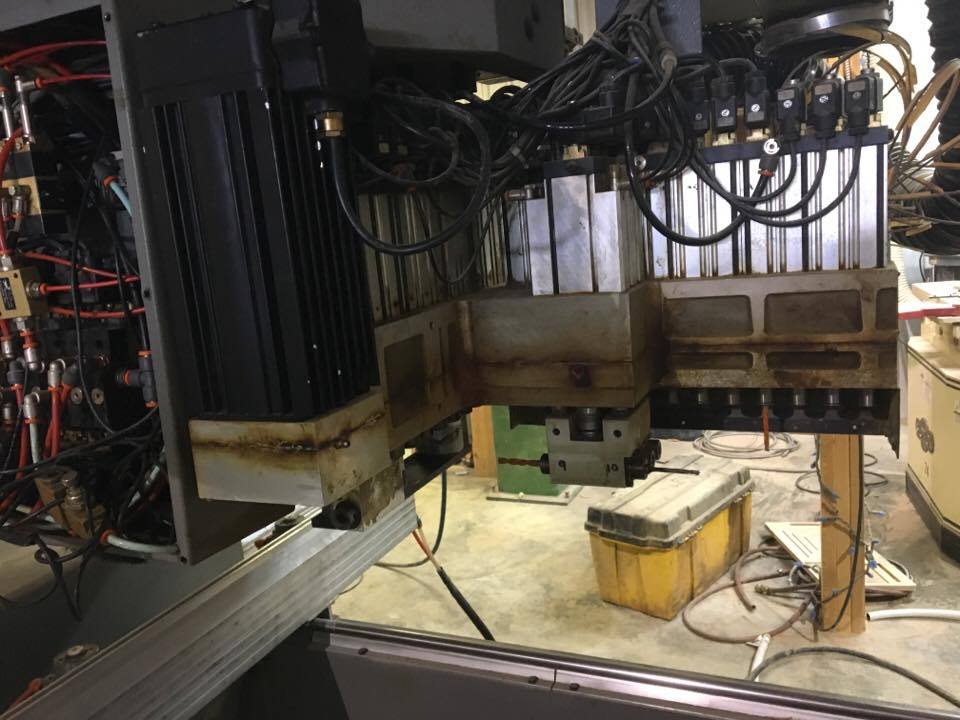

Three Spindles
Horizontal and Vertical Boring heads. 32 heads with capability to drop each individually.
3 position tool changer. Three spindles so need to keep one open at all times so it has the capability of 5 tools.
It also has the provision to add more if required.

- Todd Zuercher
- Posts: 4781
- Thank you received: 1471
08 Feb 2017 18:44 #87590
3 spindles and 3 tool positions. Do all three spindles need to be able to access the tool change rack, or only one of the spindles?
If all three, that sounds complicated, kind of like a random tool changer with a twist.
I think I'd just set up the drill bank to use a custom M-code (M1xxPxx)to select and lower the tool) and a T code (to set the offsets). (not sure how it would exactly all shake out.)

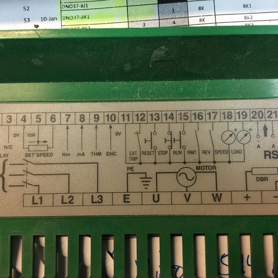

Today is spindle day.......
I have a cControl Techniques inverter Commander-CD-750.
It has a POT option. It was running with RS485 from the old control. I am going to attempt to use the pot interface and control it via 7i77 spindle with 0-10v.
My plan is to connect 0-10v from 7i77 to pins 4 and 5.
Then run pins 11 and 18 into analog input on 7i77 to get spindle at speed so the program can continue.
Then somehow when the spindle out is set in Gcode fire a oneshot relay on pins 11 and 15.
then when spindle is shutdown, fire a relay oneshot and open pin 14 and 11.
Does this sound correct?
Questions:
1. With regards to a 7i77, which bit on sserial_port_0 do I need to get the analog inputs? 0=200xxx ?
loadrt hm2_pci config=" num_encoders=6 num_pwmgens=0 num_stepgens=0 sserial_port_0=000xxx sserial_port_1=00000000"
EDIT
Found it.
loadrt hm2_pci config=" num_encoders=6 num_pwmgens=0 num_stepgens=0 sserial_port_0=200xxx sserial_port_1=00000000"
That should make inputs 0-3 on 7i77 as analog.
/EDIT
