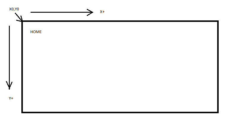

To eliminate any confusion, can you give us a picture of the machine annotated with the machine coordinates of the 4 corners of a square on the table.

08 Feb 2017 13:49 - 08 Feb 2017 13:50 #87551
by bevins
Replied by bevins on topic Biesse Rover 346 Retrofit
Last edit: 08 Feb 2017 13:50 by bevins.

Well what you've drawn above is backwards to the normal Cartesian standard. I suggest you reverse your Y axis.

Your Y is actually backwards. (and you would make mirror parts with that setup)

So Y should always be negative in this scenario. yeah your right.....
So I'll reverse the encoder scale and output scale....... This will do it?

Y Doesn't have to be negative. You can still home to the position you were homing to, but the value given to an axis at the home position is an arbitrary one determined by the setting of HOME_OFFSET in the ini file (and HOME is the position where the machine will park after touching off to the home switch). This only sets the machine coordinate system, that doesn't really matter much any way, what really matters is what the work coordinates are set to.
