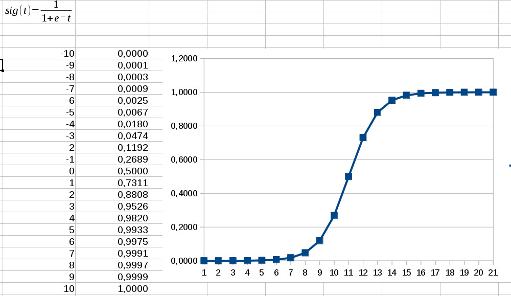

I try to find an easier way and stumbled over Sigmoid function. My Idea is to build s-curve gain and multiply to current acceleration. This function get back good result but i am not able to scale the timer. If its possible to define this function with timers could we bend anything to S curve.
What do you thing about this way?

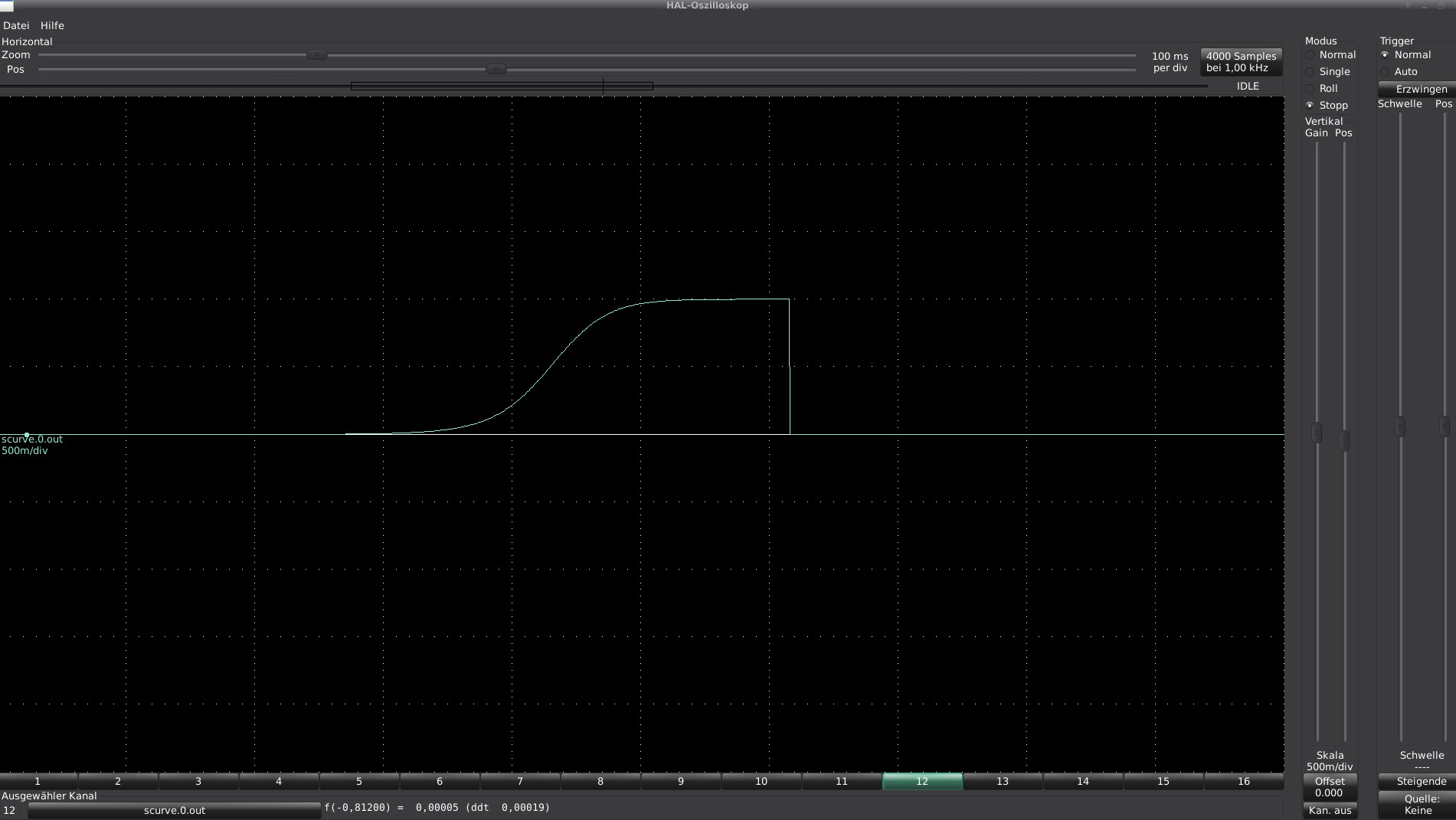

12 Jun 2021 09:06 #211870
by TheRoslyak
Replied by TheRoslyak on topic LinuxCNC S-Curve Accelerations
Hi arvidb,
Can you share how you imported S-Curve Accelerations?
Looking at scope you did it.

12 Jun 2021 12:41 - 12 Jun 2021 12:42 #211876
by arvidb
Replied by arvidb on topic LinuxCNC S-Curve Accelerations
Hi TheRoslyak,
What you see on the scope is just the simplest case of jerk-limited motion: from stationary to stationary with a constant velocity part in between. There are much trickier cases that must work too for the code to be usable.
My code isn't finished yet. Since my last post I've fixed the bug I found during testing with the MPG (and another one), but there is still one corner case that I have to implement, and then integrate the resulting library with the LinuxCNC build system. I've had precious little "leftover energy" to spend on hobby programming lately, but the project is still moving forward, albeit *very* slowly at present.

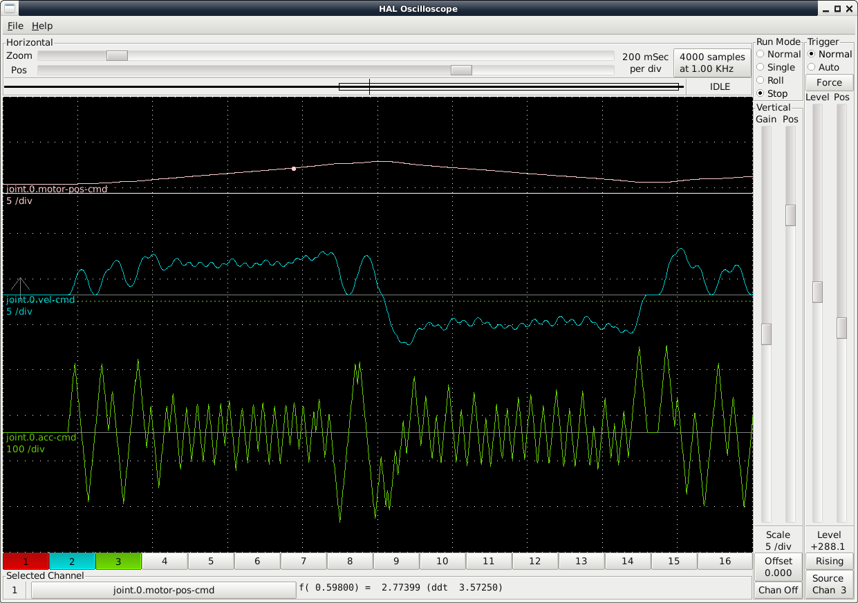

Another step forward: I managed to implement that missing corner case yesterday. Here's an oscilloscope plot showing MPG jogging, where jerk limited planning might have its biggest impact:
A bit more interesting than the last plot, don't you think?
There are still a few known bugs in the code, but it's nearing a state where testing might soon become meaningful!

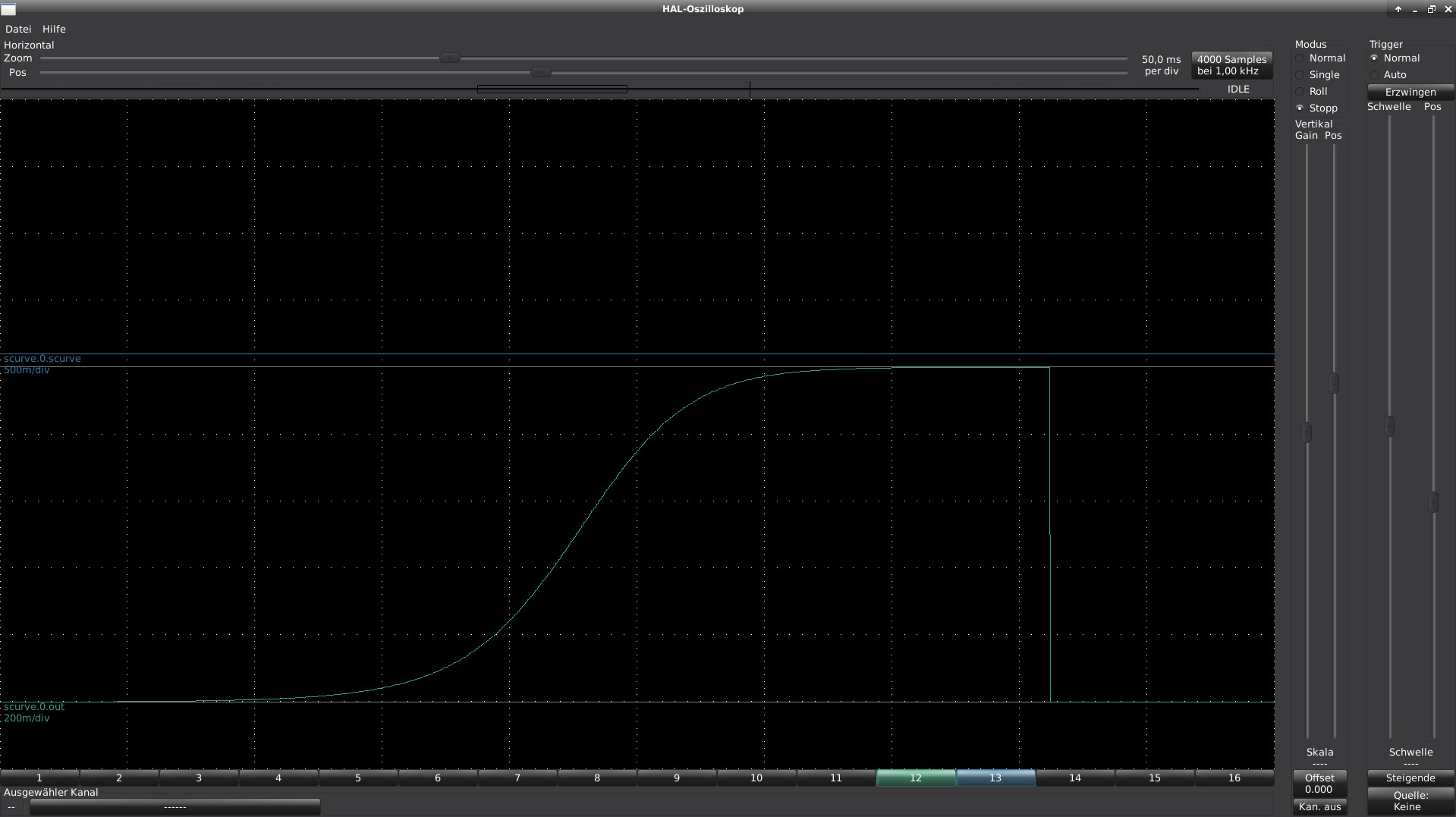

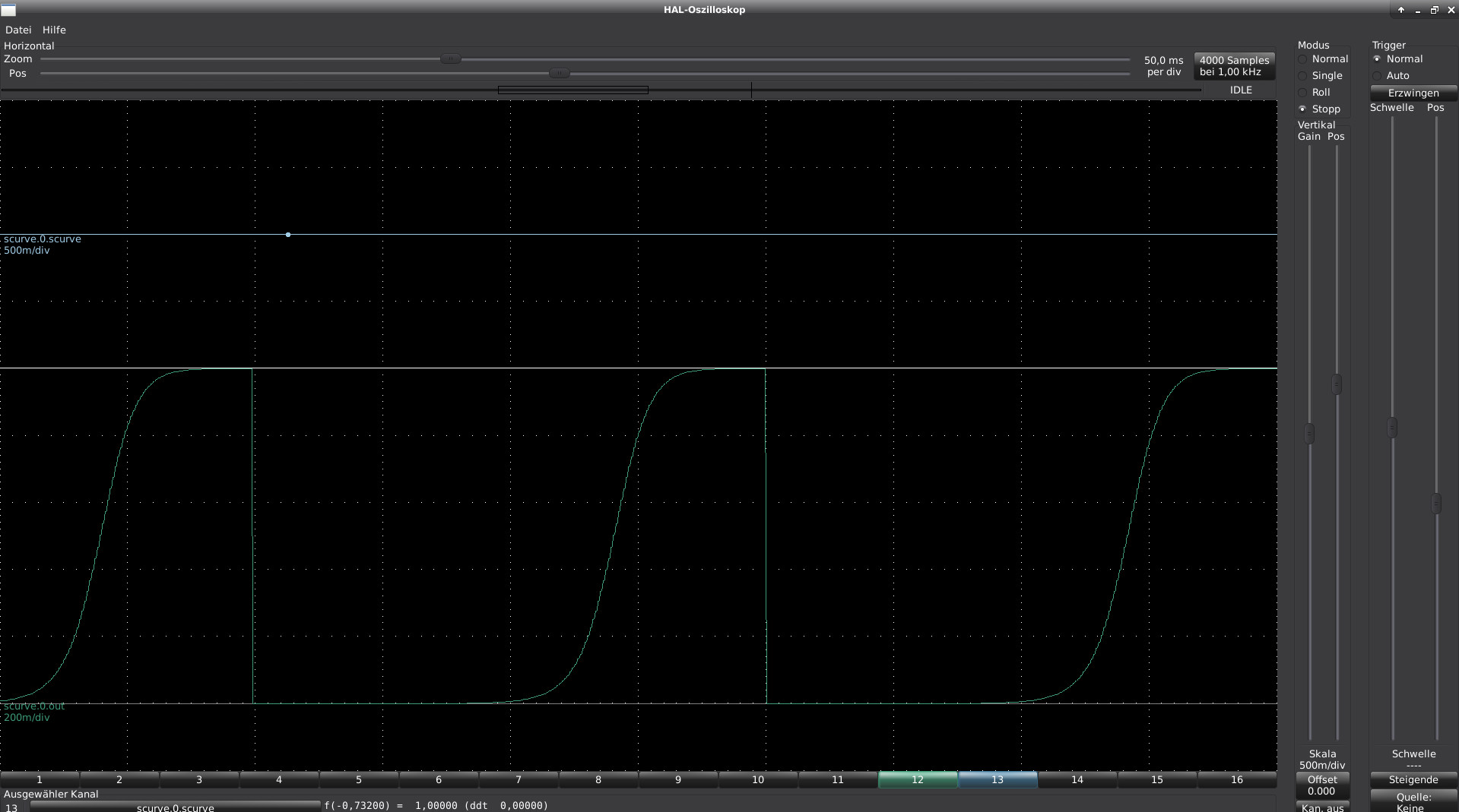

13 Jun 2021 12:29 #211954
by chris@cnc
You're right. It's a good idea to climb down the hill.
But i can't do it.I can't do two calculations in a row. I can now control the length of the curve using a pin. My programming skills are not enough. I should leave it to people who know what they're doing. Try and error no longer leads to the goal.
Maybe someone else can make something of it. I can not...
Replied by chris@cnc on topic LinuxCNC S-Curve Accelerations
Hi arvidb,. Add a deceleration stage (from v = 1.0 to v = 0.0) and then scale peak velocity so that your algorithm ends up moving any distance that you specify as an input.
