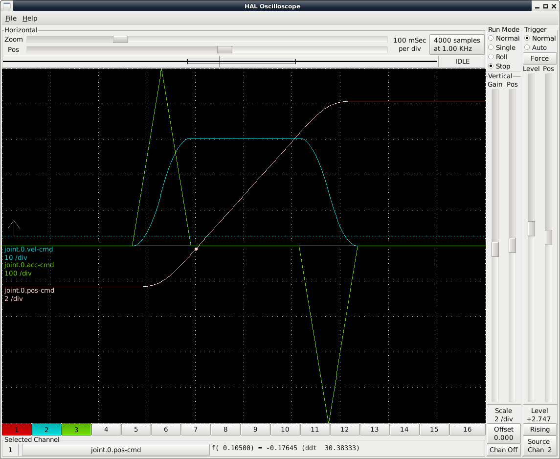

Grey is S (distance) versus T (time). This grey line starts at xy:0,0
The grey line is scaled on the y-axis back to fit into the screen.
It's a quite unusual display. But it show's more or less how much distance is produced over time.
Cyan and red is the actual s-curve, cyan and red separates the convex and concave period's on both sides of the curve.
Where the color's change in the curve, we have the inflection point where the acceleration of the curve = 2* linair acceleration.
The color is not inline with convace or convex, it's just a separator color.
Black is the acceleration.
Nice - it's an interesting problem to work on!
Yeahh. It's quite boring to code math. But after 2 day's it works better then my previous attempt.
I really like the velocity sampling solution. My first solution was to find the intersection of 2 curves, but sampling
is much easyer.
Now working on the realtime buffer. The ingredients are :
2 buffers of 3000ms.
1 chrono high resolution clock
5 textfiles with each 3000 motion command lines to give the buffer meat.
1 portion off luck.

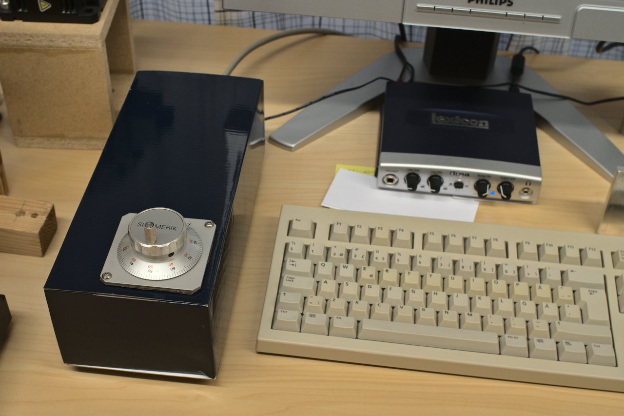

Just a small update:
I've cobbled together an MPG
input using a 7i77 I had lying around, an old used Siemens MPG and this luxurious cardboard box.
It's meant for testing of the planner, and sure enough, I immediately found a bug that I'm now working on ironing out. I've managed to create a test that repeats it and identified where things go wrong - now I just need to figure out how to fix it...
No real progress on build integration yet, but I have an idea on how to do that now at least.
