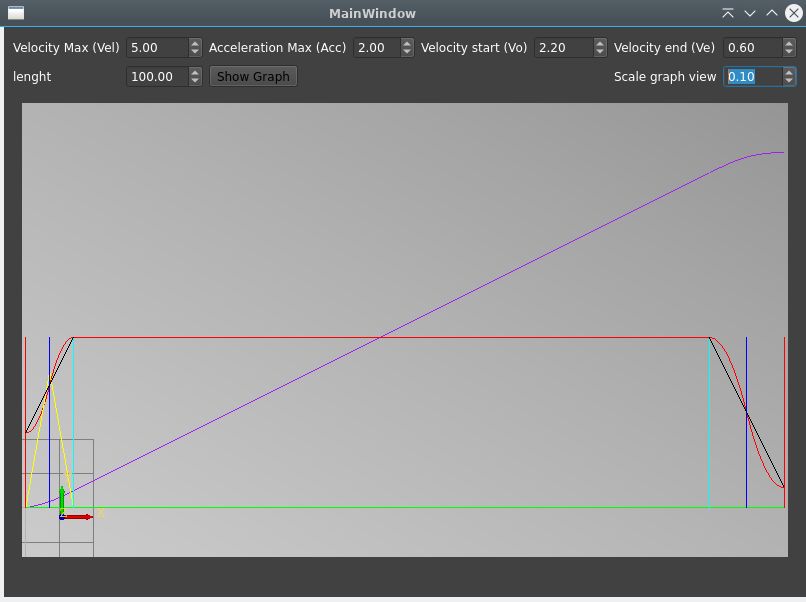

Today i made new, fresh code based again on this paper : github.com/grotius-cnc/S-curve-motion-pl...ng/blob/main/Ch5.pdf
The result now looks promising.
The displacement curve (purple) has no "kinks" when using initial and or end velocity commands.
And a video : user-images.githubusercontent.com/448801...3e4-92524c2a02c2.mp4
Qt project in development stage, but functional : github.com/grotius-cnc/S-curve-motion-pl...g/releases/tag/1.0.2
Last edit: 18 Jun 2021 16:00 by Grotius.

19 Jun 2021 07:28 #212396
by arvidb
Replied by arvidb on topic LinuxCNC S-Curve Accelerations
Nice paper you found there!
Your diagrams look much better now, I cannot see any obvious problems. Thumbs up!
Do you think you can make it work with initial acceleration as well? Another thing to try is a very short displacement and large initial velocity, so that displacement overshoot, and the velocity has to change sign to get back to the requested displacement.

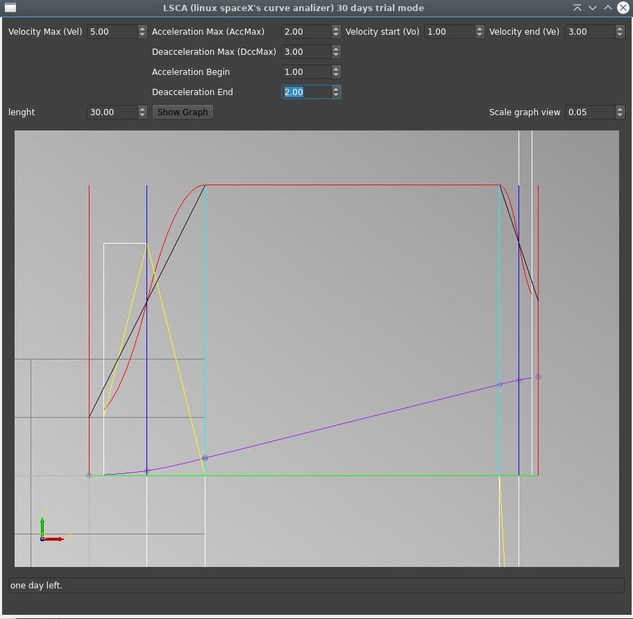

19 Jun 2021 15:52 - 19 Jun 2021 15:52 #212440
by arvidb
There are bugs in your AccStart & AccEnd implementation. Please do more thorough testing of your code. Hint: double-check the actual displacement.
No, neither AccEnd nor VelEnd are useful for LinuxCNC. Both AccStart and VelStart are required though.A second question then would be, is it usefull to add a AccEnd value to the program?
No, use a short length and a large Velocity start, so that there is no time to slow down before the displacement has passed the requested length.Another thing to try is a very short displacement and large initial velocity, so that displacement overshoot,
Something like attached picture? But there is no overshoot.
Last edit: 19 Jun 2021 15:52 by arvidb.

19 Jun 2021 16:06 - 19 Jun 2021 16:09 #212441
by Grotius
Replied by Grotius on topic LinuxCNC S-Curve Accelerations
In attached code the displacement output is more checked. I expanded this today.
I know the displacement inaccuracy (i have seen value's out of position : 1~4mm).
I have to investegate the cause of this. I think we will find the problem.
My first idea was, it could be a formula imperfection of the used paper.
github.com/grotius-cnc/S-curve-motion-pl...g/releases/tag/1.0.3
